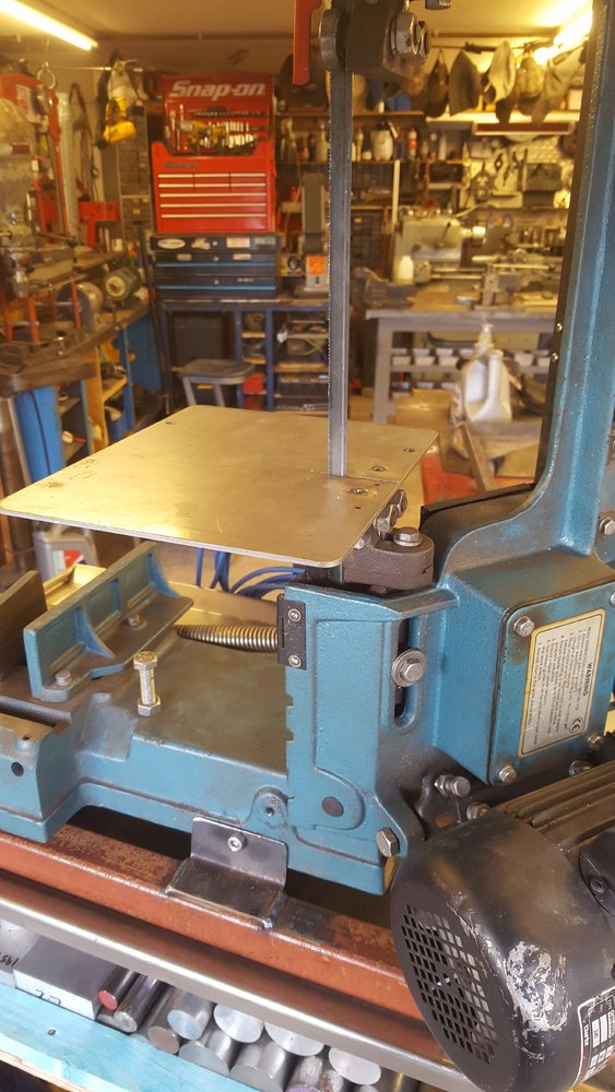

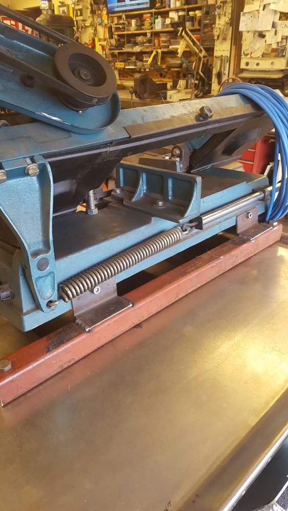

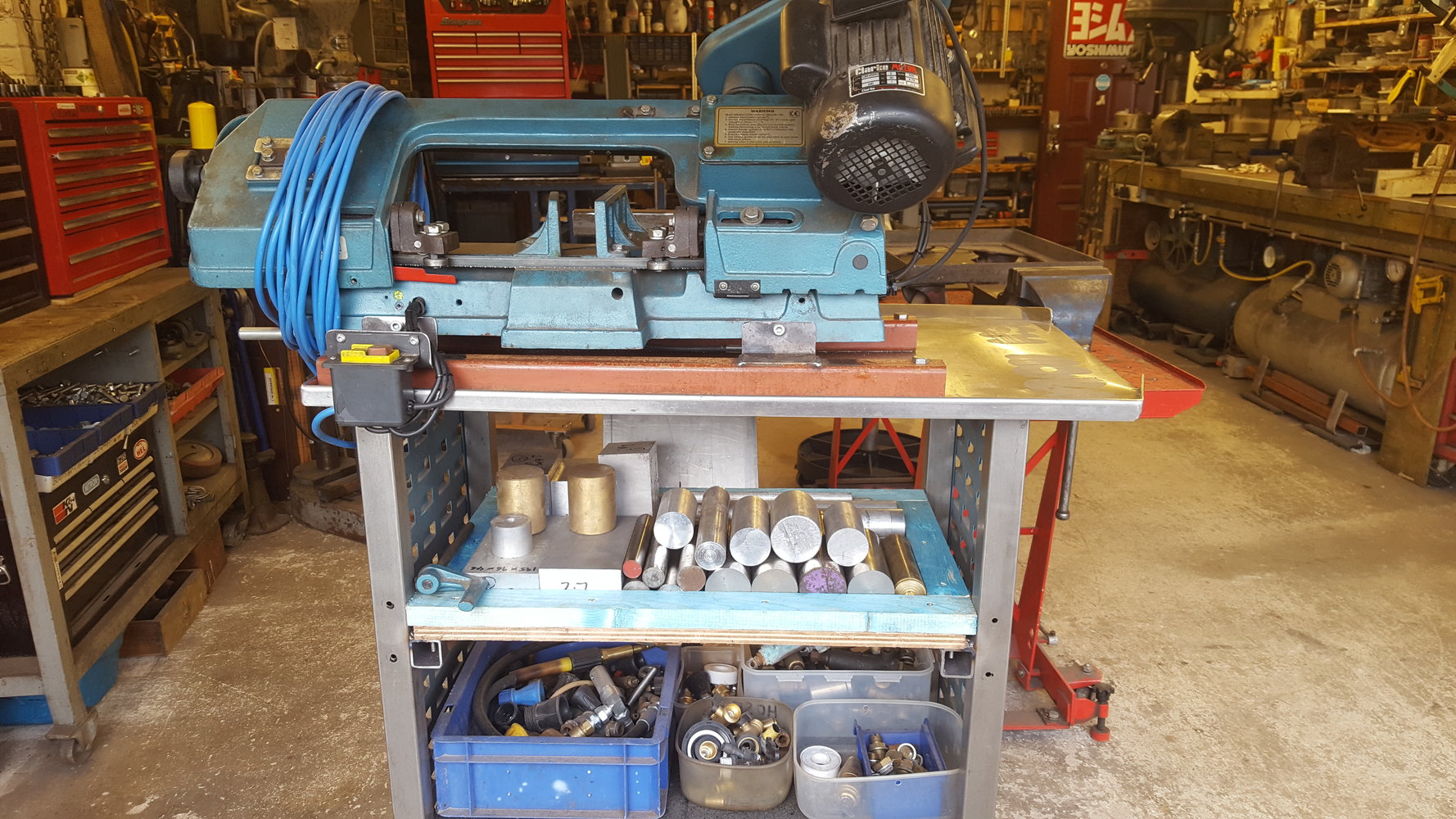

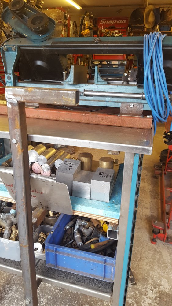

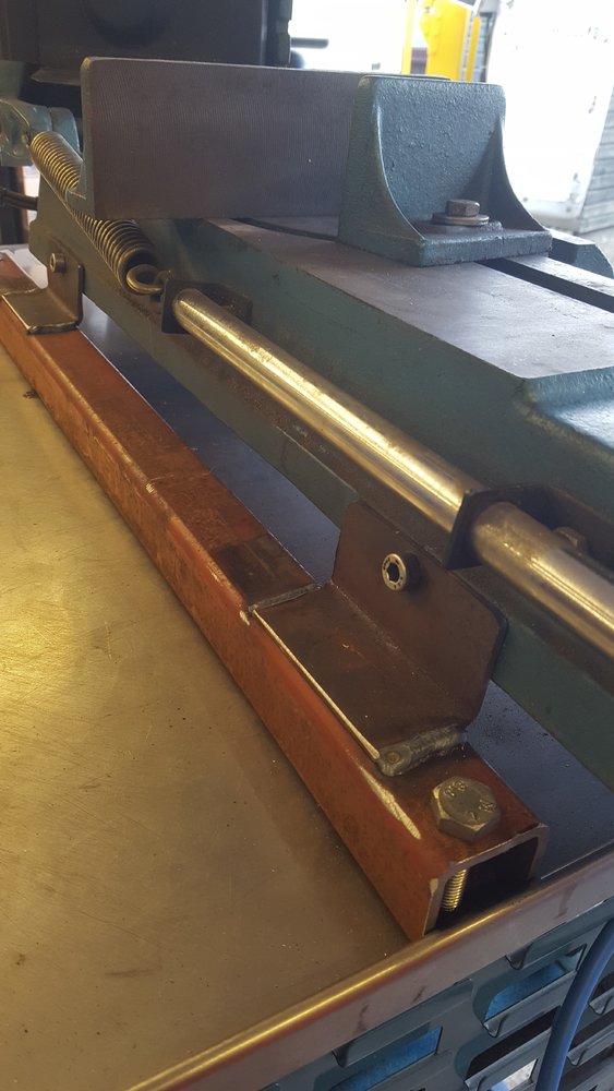

Glad your happy, your man space is much tidier than mine!Recently picked up a bandsaw from addjunkie, i have fitted it to a table with lockable wheels. Also made a support for longer stock hanging over the back, then a plate for vertical sawing which is really handy too. Not a bad addition to the shop and will get used a lot.

The 7x12 I have came with one from the factory, eleiminates a lot of the fears of snappage! They'e not complicated to make from first principles, put a one-way ball/spring-valve in piston with a couple of O-rings, plumb a bypass with a needle vlave and aball valve to shut the motion off - but ready-made is a lot less hassle!I've got an adjustable motorcycle steering damper I intend fitting to my saw to smooth the blade decent. Not my idea but one I'd seen others have done.

I do like that idea of mounting it on decent bench. Maybe get coolant sorted too.
Just needs the two screws for the vertical table plate. Presumably they’re imperial?
