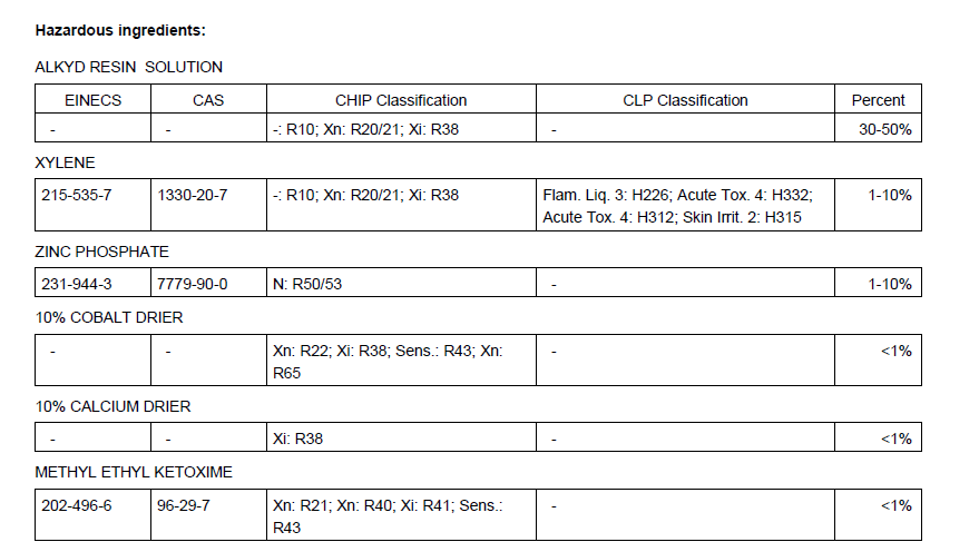

+£10 Del,still a good price thoughJust after opinion on this paint as Ive run out of black Zinc oxide primer and this seems alot cheaper than my local paint supplier normally £50+ but this is £22 but the supplier seems legit
Well, 'red oxide' primers are around, but that description now only tells the colour of the paint and nothing else.
Zinc Phosphate primer is what I want ideally but this is vague as to whats in itWell, 'red oxide' primers are around, but that description now only tells the colour of the paint and nothing else. The days when red oxide meant lead oxide are over. What does "black oxide" tell you??? I note the ad also mentions their "ZP" primers (zinc phosphate) - I am huge fan of zinc phosphate .
