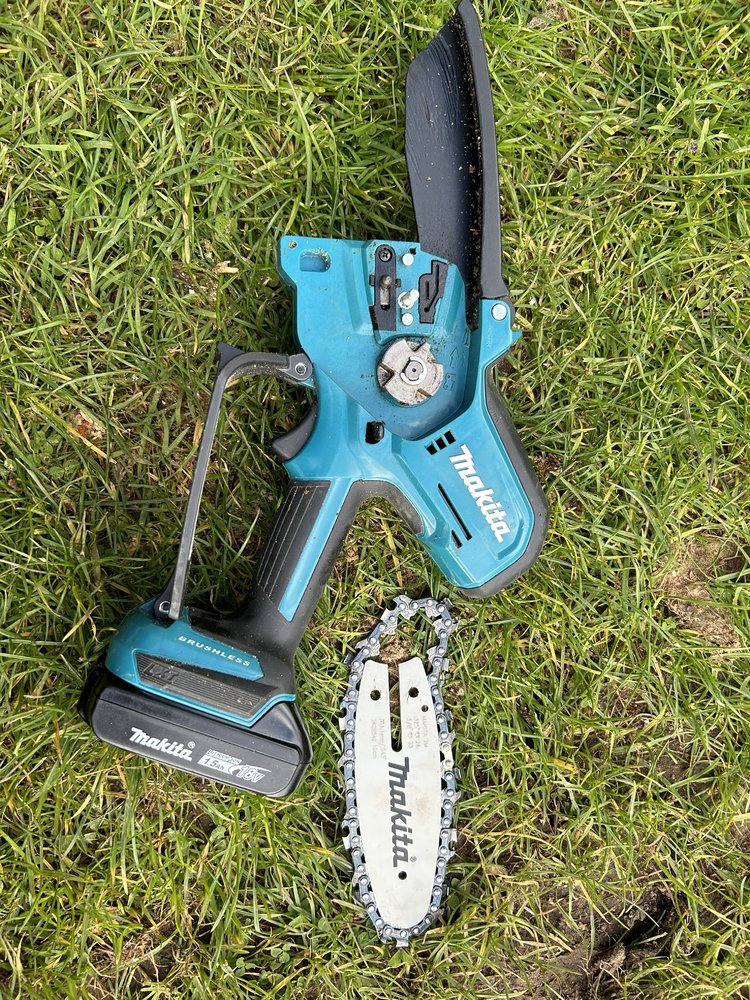

Thanks, that middle link works out OK, still a premium for a very small chain but that’s to be expected I guess due to low demand. Hopefully that will change as these little saws are really handy..325 chain has a slightly wider cut than 1/4" and less teeth, but it is stronger and a little easier to sharpen. You can get a 1/4" conversion for the chain saws (don't know about the pruner saws ) but if you're cutting rough wood like pallets the .325 chain will last longer.

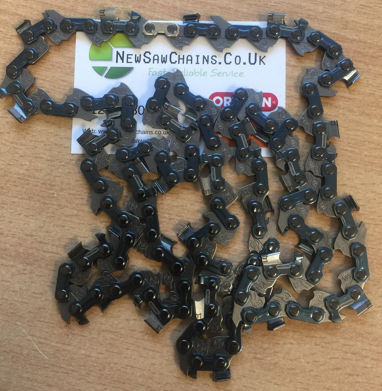

80TXL Oregon Speedcut Nano .325 .043[1.1mm] [46,51,59,64 drive links only]
SpeedCut Nano has been engineered from the ground up with maximum efficiency in mind. Built to optimize saw performance,www.chainsawbars.co.uk80TXL026 / 80TXL026E / 80TXL026X SpeedCut Nano Chainsaw Chain
80TXL026 / 80TXL026E / 80TXL026X SpeedCut Nano Chainsaw Chainwww.chainsdirect.co.ukOregon 80TXL026E / 80TXL026X / 80TXL026 SpeedCut Nano Chainsaw Chain -
Oregon 80TXL026E / 80TXL026X / 80TXL026 SpeedCut Nano Chainsaw Chain - 26 Drive Links Pitch: .325" Low Profile, Gauge: .043" Expanded Top-Plate Filing Indicators and depth gauge filing indicators area make accurate sharpening easier Blued Cutters deliver high-quality protection against corrosion...www.newsawchains.co.uk
I spoke to the oregon rep recently about 80txl and it's something to do with the patent on them or something. I think stihl came up with it originally.Thanks, that middle link works out OK, still a premium for a very small chain but that’s to be expected I guess due to low demand. Hopefully that will change as these little saws are really handy.
