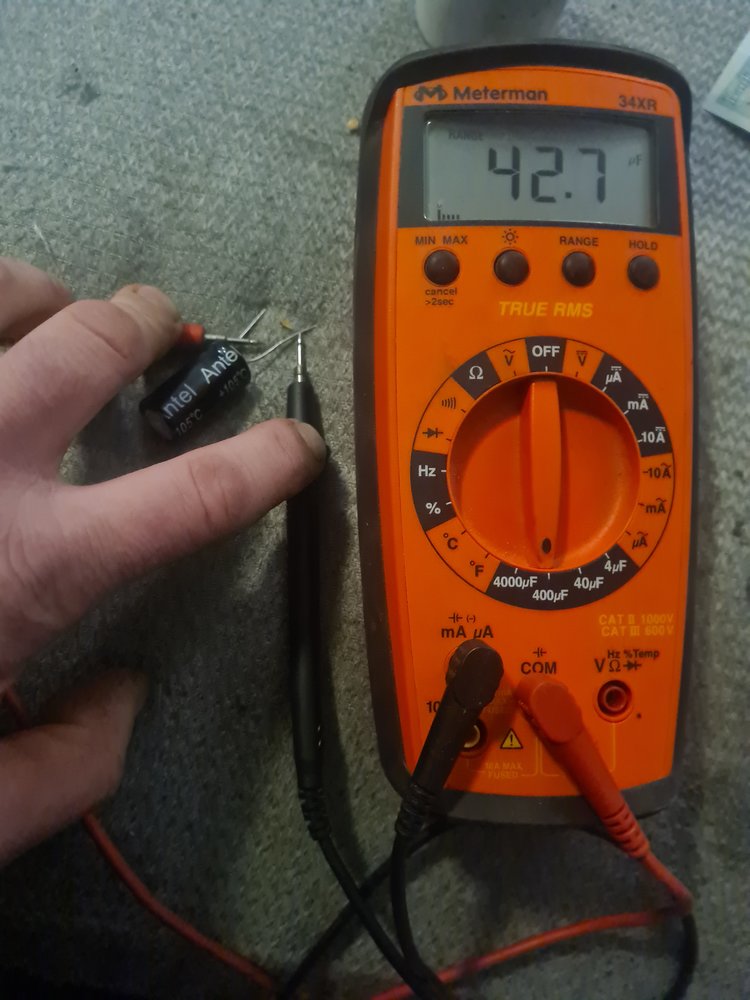

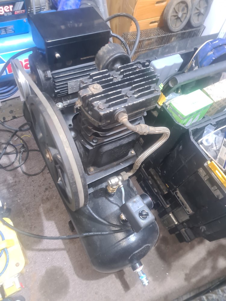

Going back to an old compressor project I finished the compresser turned on and ran fine but keeps blowing Fuses (not triping the electrics but has done once mcb rated 16amp)
Was not blowing Fuses before runs for a while more 30/40 seconds on first start up but after might blow right away if needs to restart

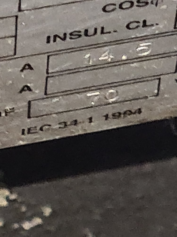

I have now noted the motor is rated at 14.5 amps am assuming this is the normal for this but was running on 13 amp for a long time before ?
Any chance the oil got thick in it ? Or am I just being stupid and at 14.5 it's never going to run ?
