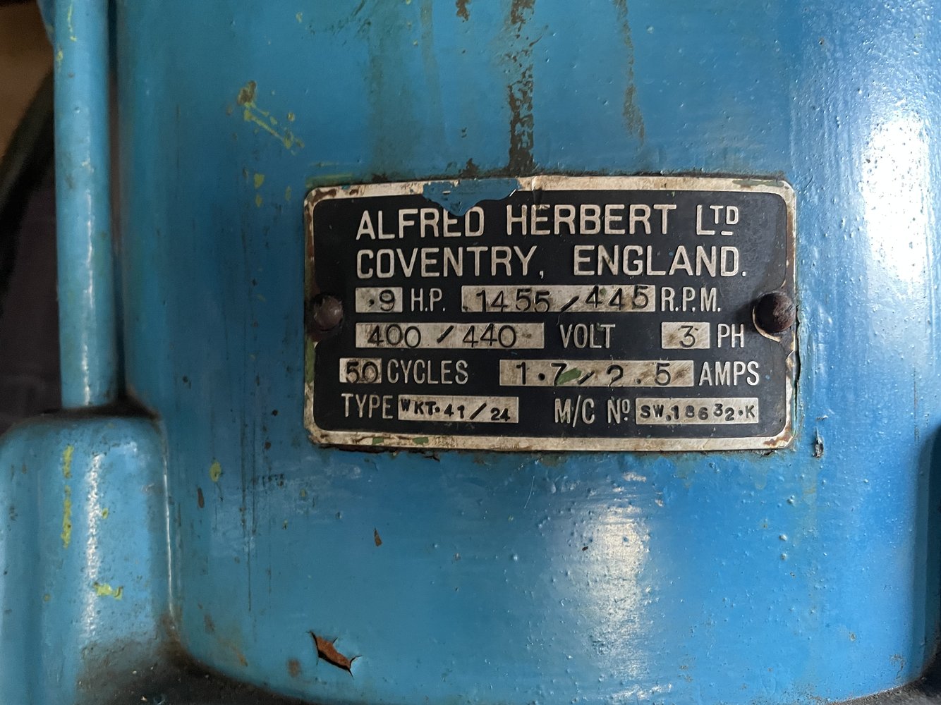

Ive had old pillar drill for over 5 years now and finally got to (try) wire it up.
Drill is 3phase with oversized motor on top and 4 motor speed and gearing to give another 4 when selected.

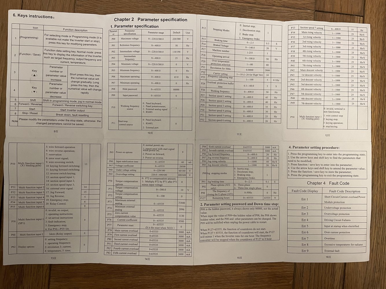

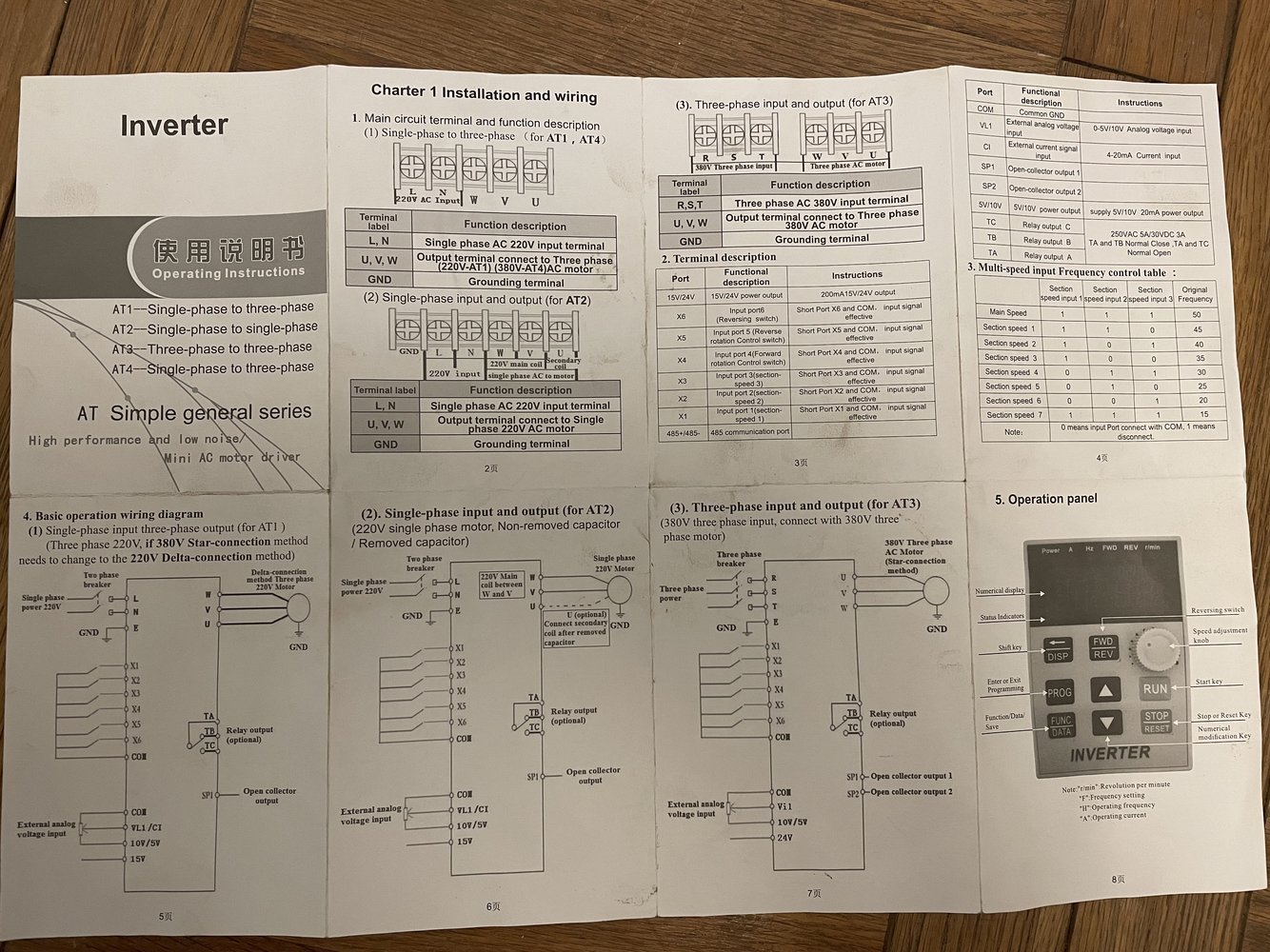

Some time ago i bought a new VFD, its an AT4. But im thinking its ghe wrong one now ss the max volts is 380 on the paperwork for setting up. Changed to 50hz ok. Not sure theres anyghing else i should change in settings.
Ive had it running and seems smooth in all gears. Its popped house rcd a couple of times.
