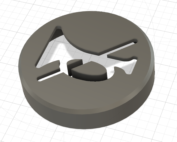

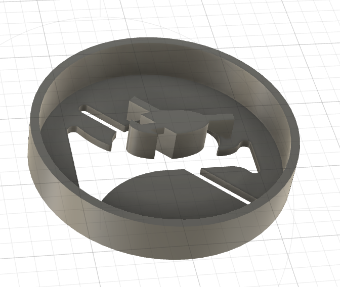

Could maybe invert the symbol so it's sitting proud at the back, print in clear resin and infill the back.I was thinking something like this and fill with either clear resin (if your backlighting is permanent and you don't want the symbol visible in ambient light) or translucent white resin if you do want it visible in ambient light...
View attachment 438998View attachment 438996
