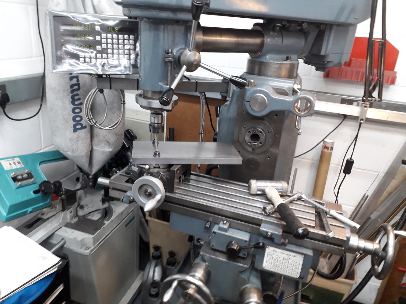

First, in order to set the helix angle, the dividing head needs to be rotated. I repurposed the base of a swivel vice that came with the shaper and fitted a piece of 6" x 15" x 3/4" plate on it to act as a rotatable table to hold the dividing head and a footstock. This needed a recess milling to fit the swivel base which tested the capacity of my mill:
This was the only way I could mill the circular recess given the little machines I've got. I popped the gap piece out of my lathe to see if that would work but an M300 just isn't big enough. This is the groove:
