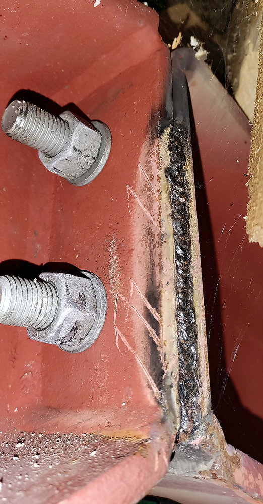

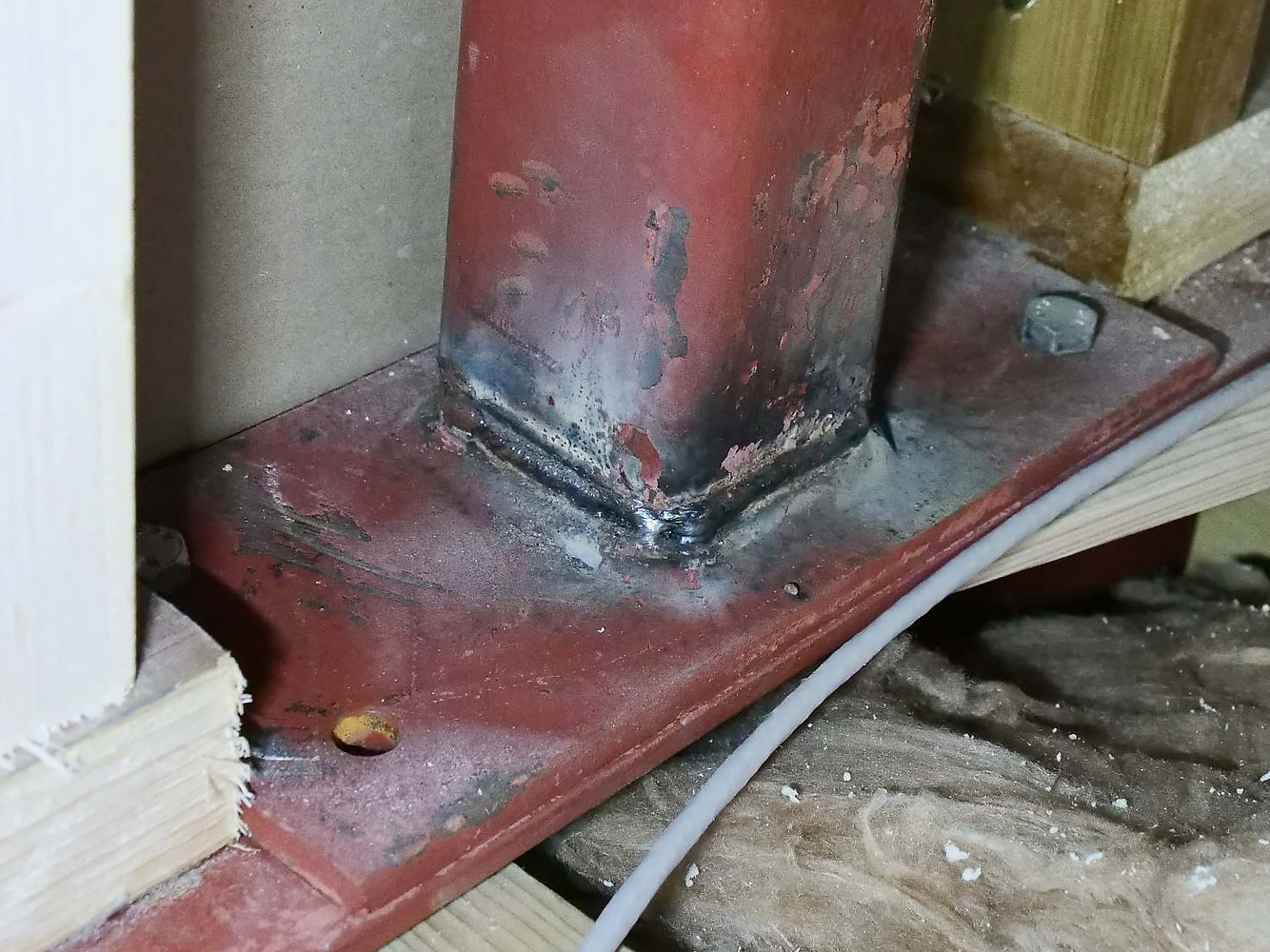

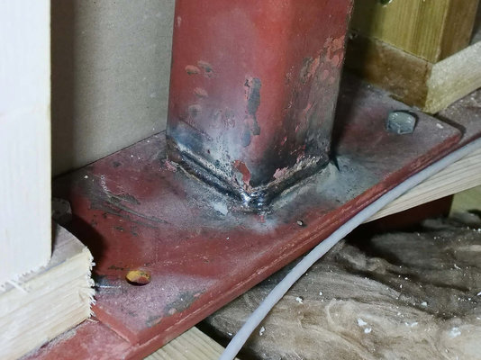

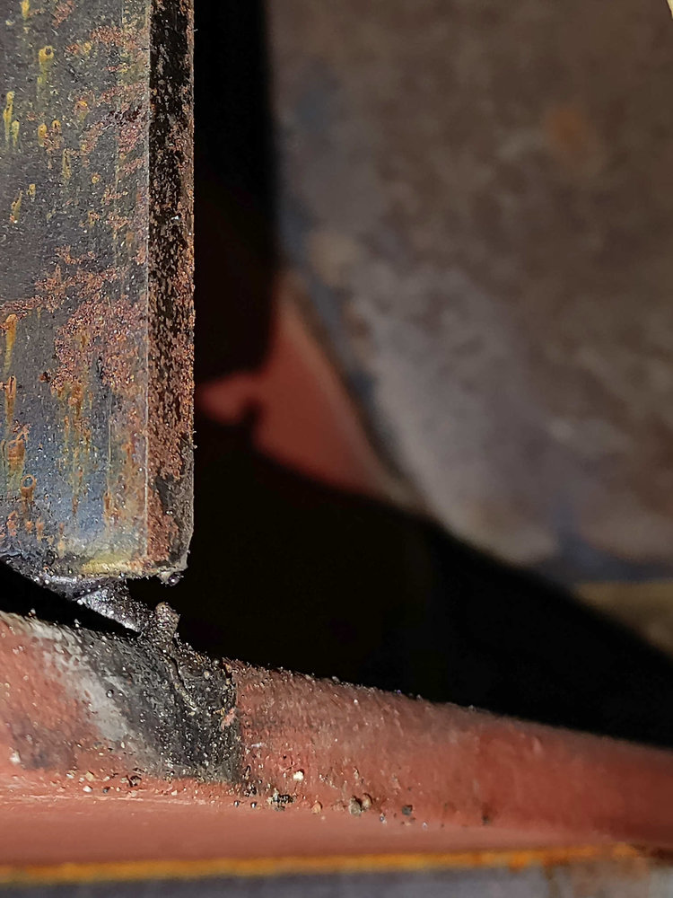

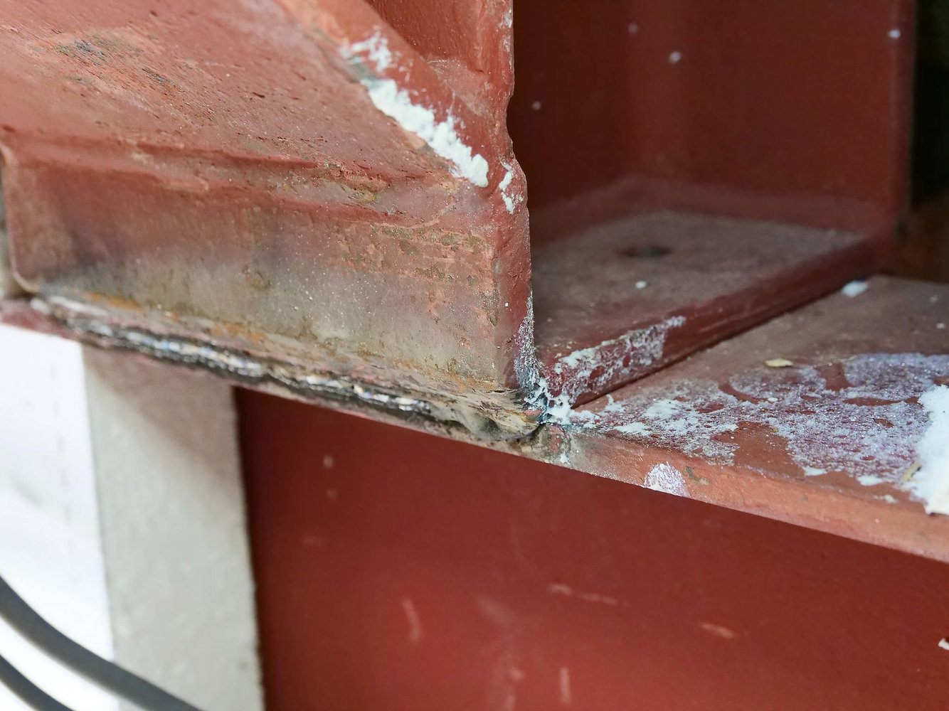

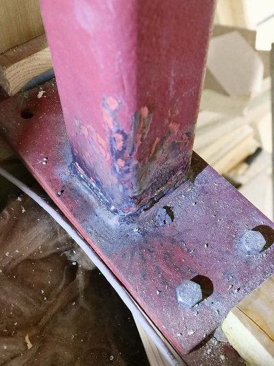

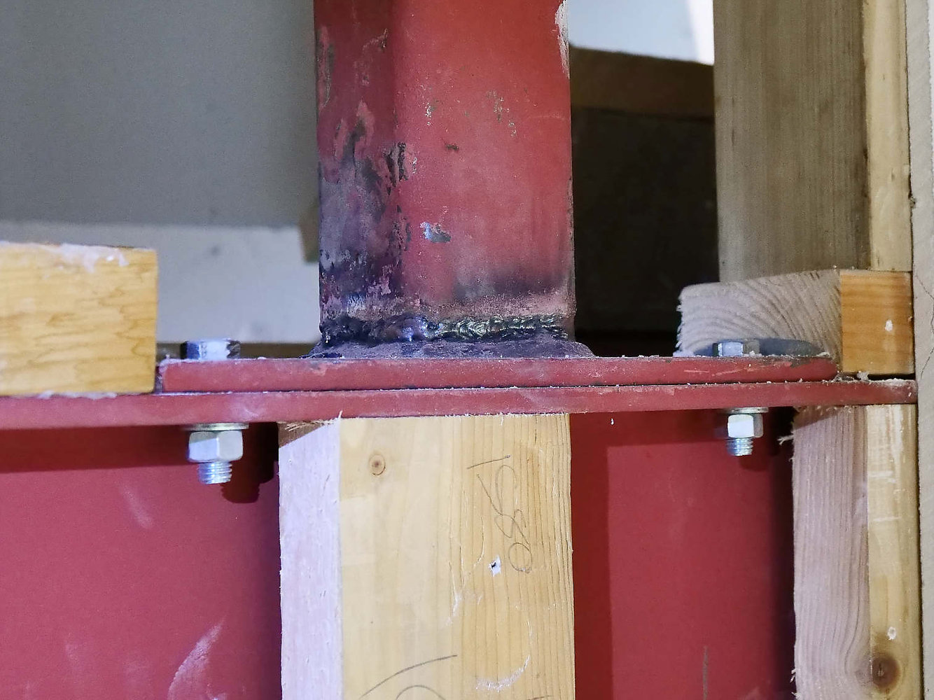

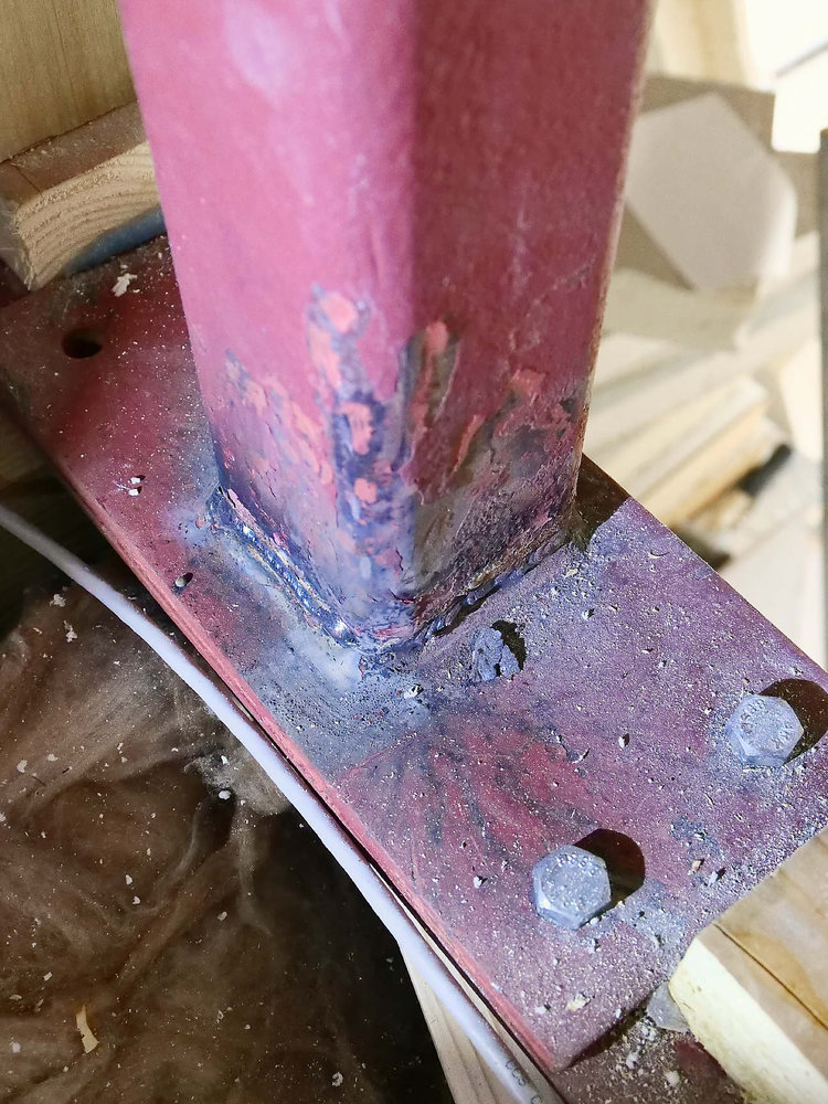

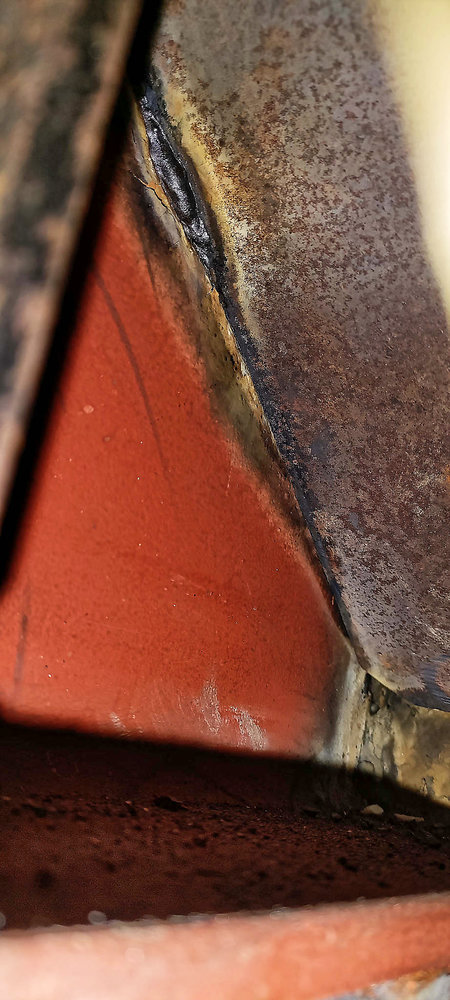

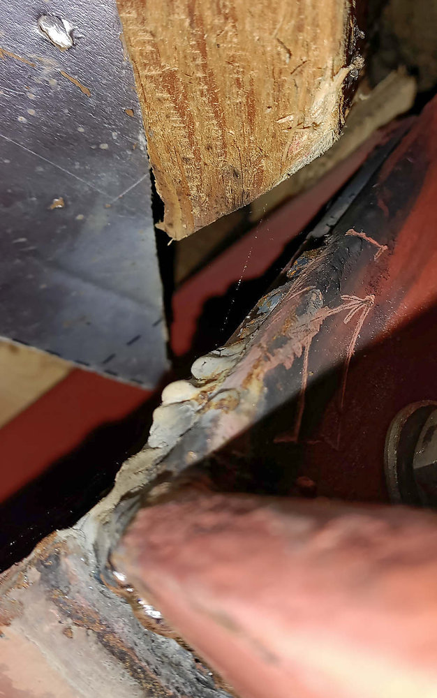

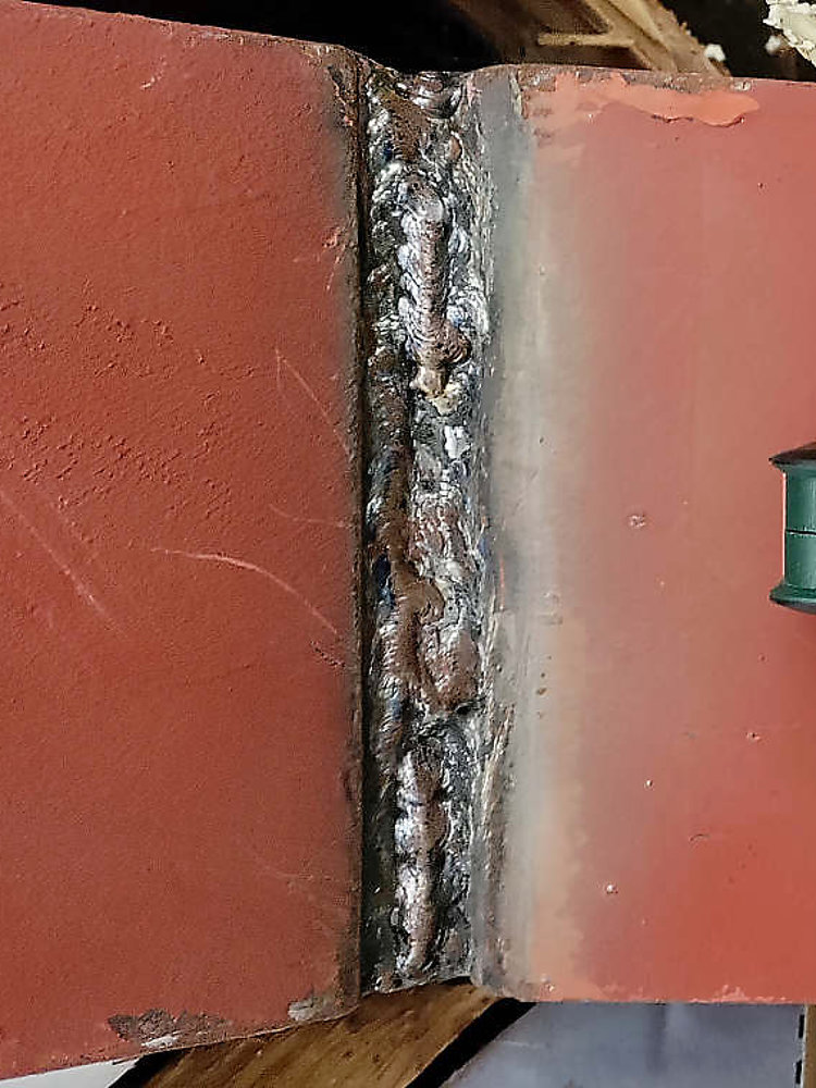

They look like I've welded them! Seriously my arc welding is better than that and I'm very much in the learning phase!Apologies if this is the wrong area to post this...
I've been looking at the welds on some steels that have been put in here, and I'm not sure if they look ok, so thought maybe this would be the place to ask for opinions...
Thanks in advance!
View attachment 410768 View attachment 410769 View attachment 410770 View attachment 410771 View attachment 410772 View attachment 410773 View attachment 410774 View attachment 410775 View attachment 410776 View attachment 410777

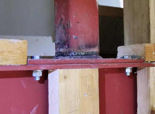

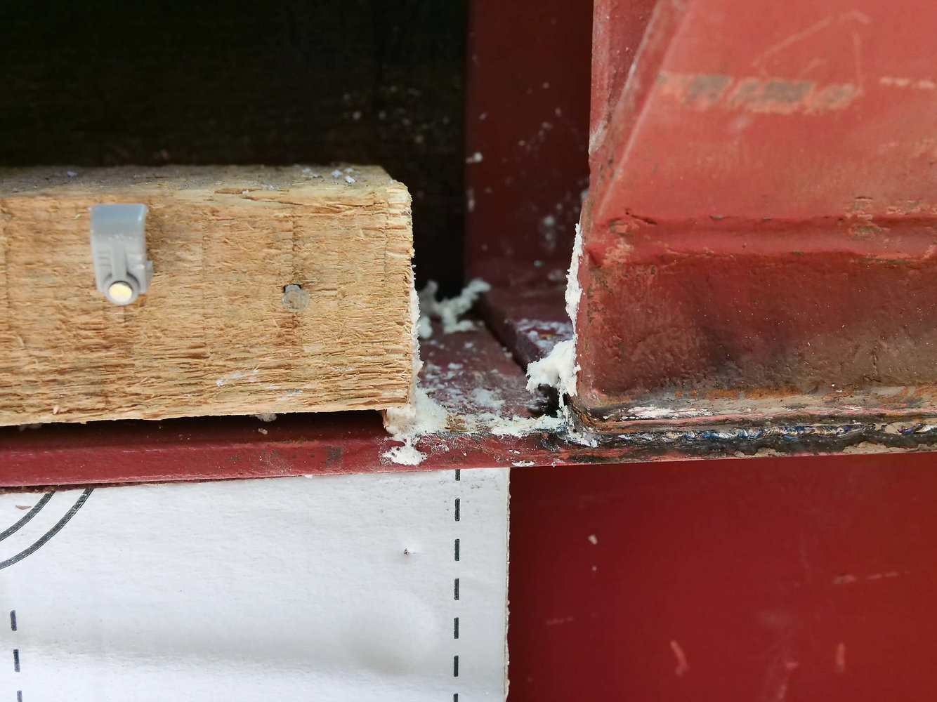

they are hammered in the webb to take plasterboardThis is an intriguing pic all on its own...
What are the wooden battens doing - are they part of the structure (and, if so, why )
I don't think it's harmful as such as it definitely looks like the lower steel will support the upper one - just seems a bit odd...
(thinking a bit more - are they for screwing OSB or plasterboard to?)
I though it looked like the angle might have been off, leaving a gap at the bottom.Shocking ! , in my opinion those joints in the first two pics didn't need welding they are bolted joints ! , the post is just not a good set up , gap filling and not done very well !
Possible but even so not looking good ,my local building inspector would have a hissy fit it I showed that off !I though it looked like the angle might have been off, leaving a gap at the bottom.
