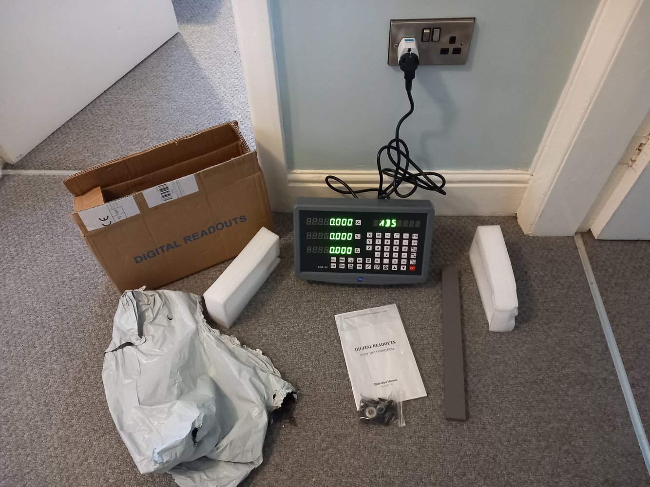

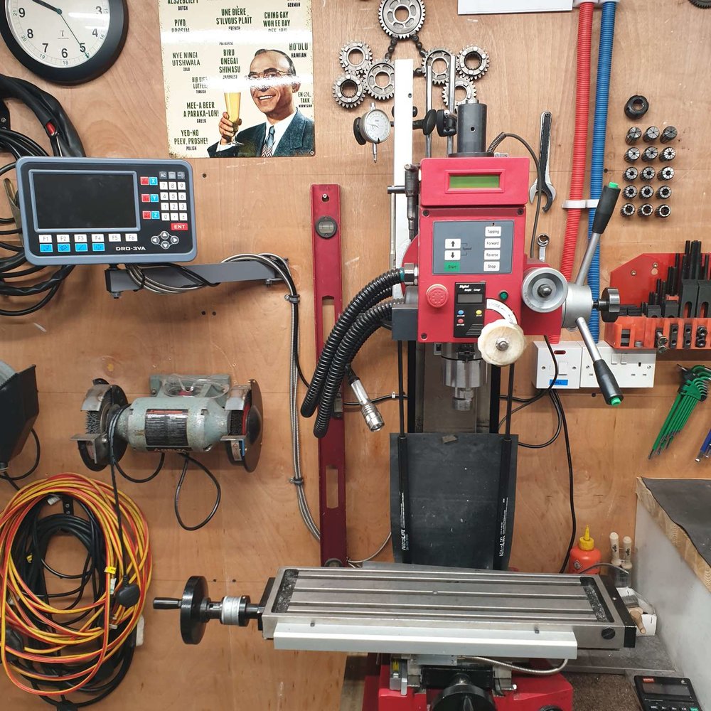

I've had that Sino display for four or five years supplied by M-DRO. Recently a column stopped working but was able to fix it quite easily. (There's a post about it on the forum).We're looking to fit 3 axis dro to our Sieg SX3 benchtop mill. I've been looking on ebay and see kits that would suit at about £250 supplied from the UK, and £200 direct from China. And this SINO one is £168 from China:
SINO SDS6-3V 3 Axis Digital Readout Metal Casing DRO Kit And 3PCS Linear Scale | eBay
The DRO SDS6-3Vis a Multifunctional 3 axis digital readout. These functions bring the easiness for the functions. The available input frequency of DRO is up to 5MHZ with A/B, it is also advanced in the world, and it's the first manufactory who employs 16 and 32 bits calculator in DRO system in...www.ebay.co.uk
I'm drawn to the ones supplied in the UK as it'd be easier to return if it doesn't work. But apart from that, is there any difference in quality between the different kit advertised on ebay in that price range? Or are they all coming from the same factory? I've read all the posts I can find on here relating to DRO and I see one or two people referring positively to Sino, but it's all a bit of a mystery to me.
Any comments or recommendations gratefully received!
Thanks, Chris

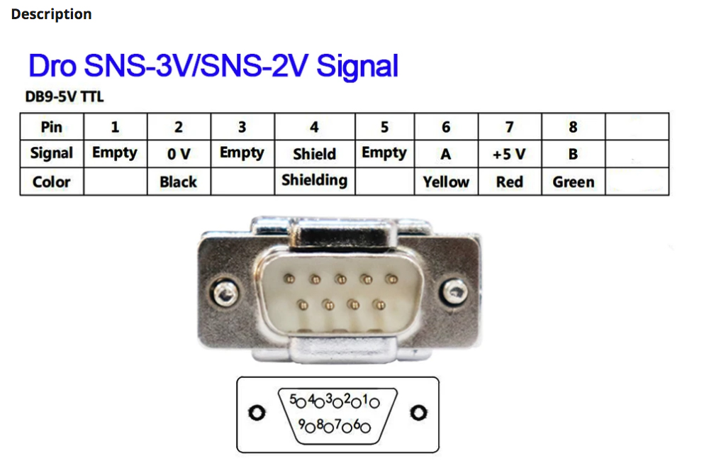

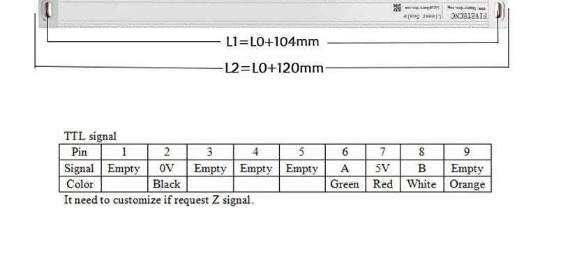

You can cut them down to size if you need to.Is the key term (in this case) TTL - if both readout and scale have that, they should fit? Sorry to be slow, your earlier post should really make this clear to me I guess!
So, for eg, this:
and this:29.98ï¿¡ 60% OFF|SNS 3V SNS 2V Dro 2 3 Axis Digital Readout Display TTL Signal 80V to 250V for Lathe Milling CNC Boring Machines| | - AliExpress
Smarter Shopping, Better Living! Aliexpress.comwww.aliexpress.com
should fit together?2 3 Axis DRO Digital Readout Display 5μm TTL Linear Scale CNC Mill Lathe Machine | eBay

I understand your qualms, the ToAuto is cheapest, but they don't mention scale physical size, which is something you should check on before ordering.
The Sino one JMS linked to allows you to pick which size scale as well as length.

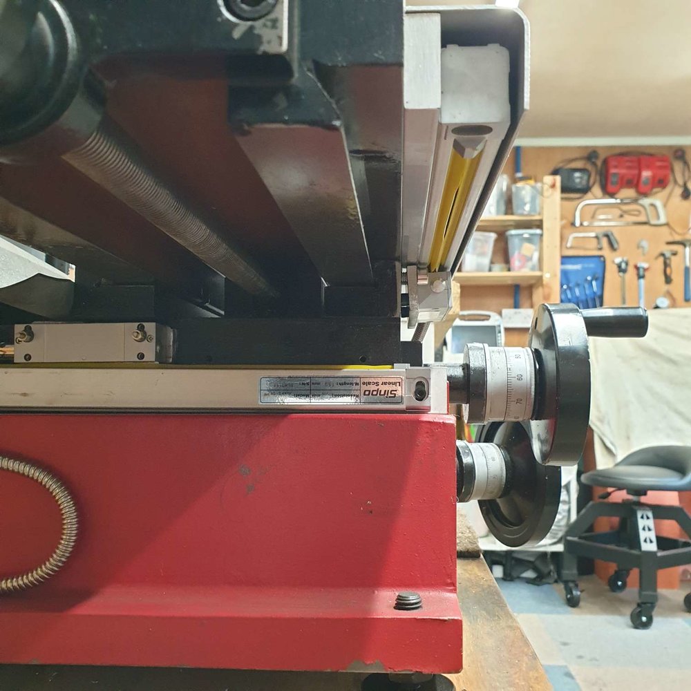

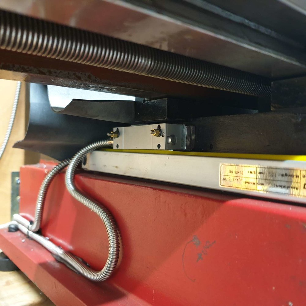

Robert - in retrospect, did you need the slim scales? I'm looking at ours and there seems to be plenty of space but would appreciate your thoughts.320mm, 150mm and 270mm slim scales.
View attachment 444768View attachment 444769View attachment 444770View attachment 444771View attachment 444772
I didn't really get involved in the difference btw slim and a not-slim; the kit I bought off eBay didn't have option, other than 5 or 1 micron resolution.Robert - in retrospect, did you need the slim scales? I'm looking at ours and there seems to be plenty of space but would appreciate your thoughts.
