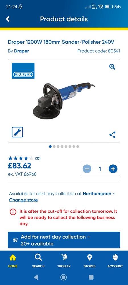

40 minutes. If it is M14 would it work fitted to an angle grinder?We actually brought just the cutter head with C5 cutters and have fitted it onto a variable speed linisher polisher as we find it more agile and better suited on the side of boats.
I can normally strip a full length narrowboat roof in 40mins.
https://www.refina.co.uk/surface-pr...5-c6-cutters.html#/1-voltage-110v/286-size-c3
...carbine tips....
Thanks for the links
They are the same unit as the concrete ones just with different teeth. The thinnest steel I've used it on is 2mmI've used similar for grinding concrete, the motor body looks very similar and is from the same maker.
Mostly I seen them used with diamond discs but I have use scabler bits on the Hilti version.
Wouldn't fancy it on thin steel but it should work well on plate.
