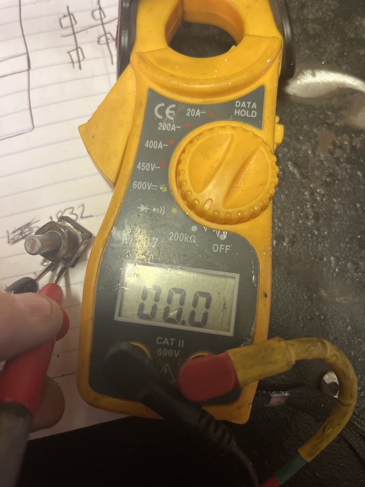

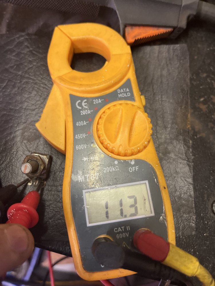

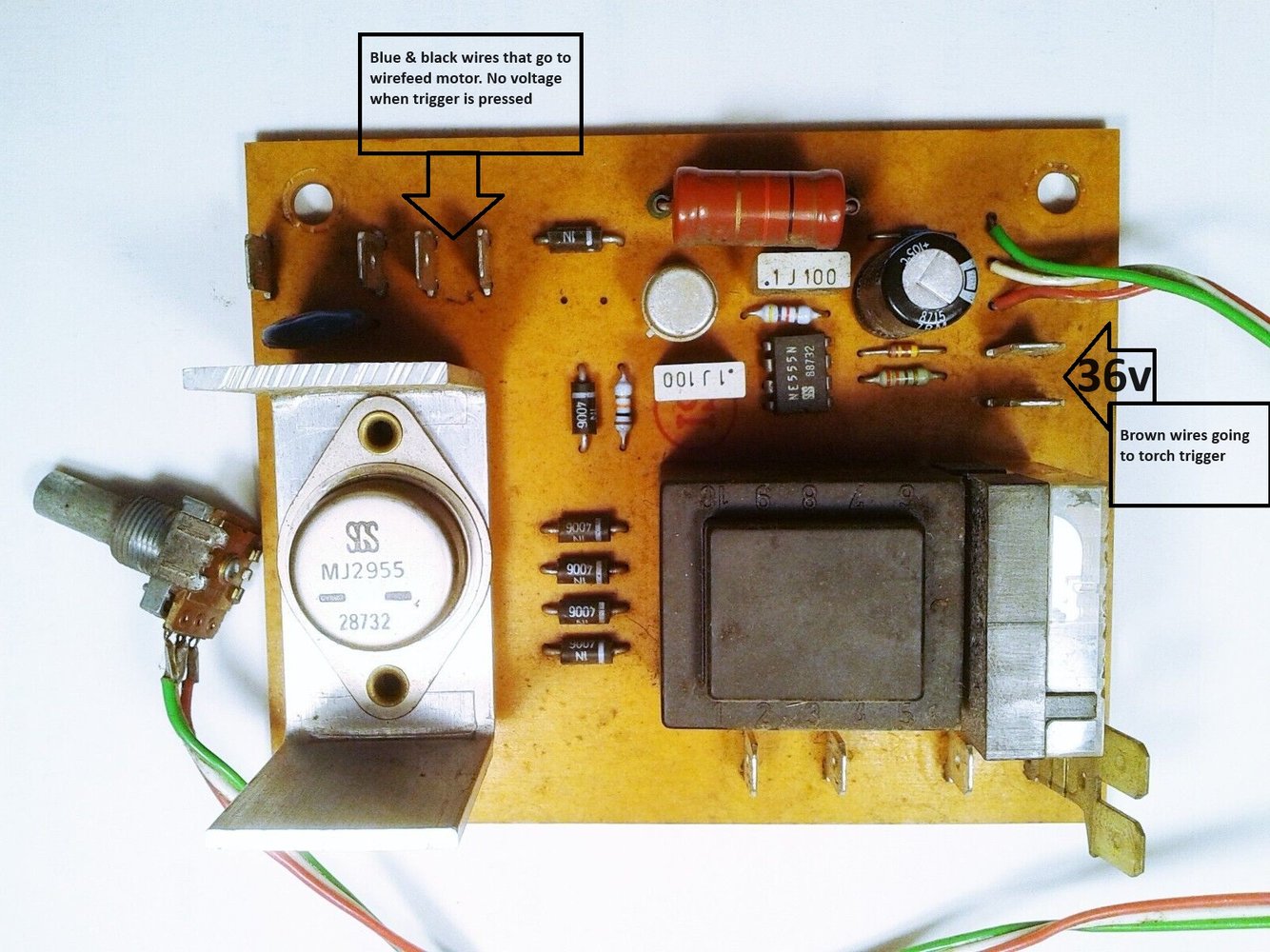

I will check again in the morning, but I'm almost sure that I was getting between 18 & 24v at the tip even though the motor wasn't turning. I checked the grey transformer and thats reducing 240 v ac down to 36v ac. I'm getting no DC voltage to the motor at allLooking over this thread, you've had wire speed issues right from the start.
It should be a fairly reliable circuit, since the photos in Post #11 show a pretty simple wire speed control board with few components. The small chip is probably an NE555 timer, sending pulse-width modulated ( PWM ) control pulses to the large diamond-shaped ( TO-3 outline ) power transistor on the heatsink, which drives the motor. Something has failed and these pulses are no longer present. To check and fix this, it may be necessary to reverse-engineer some of the circuit ( by looking at the component-side and track-side of the board ), and using an oscilloscope.
However, start by checking the power source for the motor - which is actually the DC welding voltage itself. This machine does not have an independent ( auxiliary ) motor supply, it borrows the welder output. So check if the wirefeed motor fails to run at all settings of the main rotary voltage selector switch, and confirm that arc voltage ( 20 to 25v DC ) is present.
I did clean the rotary switch when I got it, so that's all good.As with many MIGs of this level, the small PCB-mounted transformer is only there to operate the power-up relay via the torch trigger switch.
I have found a picture of the PCB on eBay Austria:
It shows that the board has an NE555 timer, a small transistor in a TO-5 can, and an MJ2955 60v 15A PNP power transistor.REPARATUR Platine Elektra Beckum Schweißgeräte Trafo-Geräte #F06 | eBay

As this example circuit diagram shows:
using a 10k pot to control the 555 timer chip is normal.A Simple 555 PWM Circuit with Motor Example

Well, fingers crossed! 2 of those controllers will be here tomorrow from Amazon.Yes, a speed controller such as:
could be used to run the wirefeed motor. The original PCB would still be required, to provide the On/Off functionality using the small transformer and the relay. We would have to trace the wires to & from the original board to work out how to add the new one.10A DC 12V-40V PWM Motor Speed Control Switch Controller Volt Regulator Dimmer | eBay
PWM frequency: 3 kHz. PWM Sampling rate: 0% -100%. consumption: 0.01 400W. Also note that monitor settings may vary from computer to computer and may distort actual colors. hope you could understand.www.ebay.co.uk
When PWM controllers are added to machines like this, a separate stabilised DC supply ( e.g. a 21v laptop supply ) is sometimes also used to supply the motor and the new board. This is done to avoid hesitation and variation in the wirespeed due to sharing the arc voltage.
The motor can also be wired to the output of the new PWM controller using a double-pole double-throw ( DPDT ) relay, which allows for shorting the motor when idle, preventing spool run-on and excessive wire stickout.
