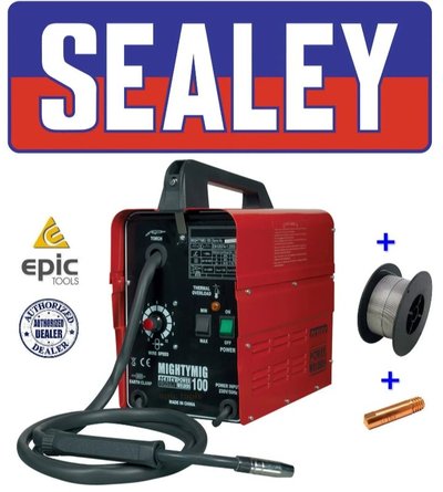

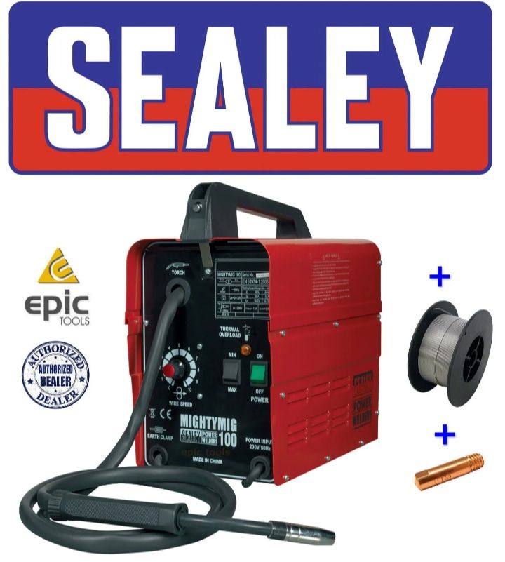

Those pictures show three cheap-N-cheerful inverters and one overpriced traditional-transformer Sealey.
The latter has no rectifier - the output is AC ! and the minimum current range is 55A ! so that's out.

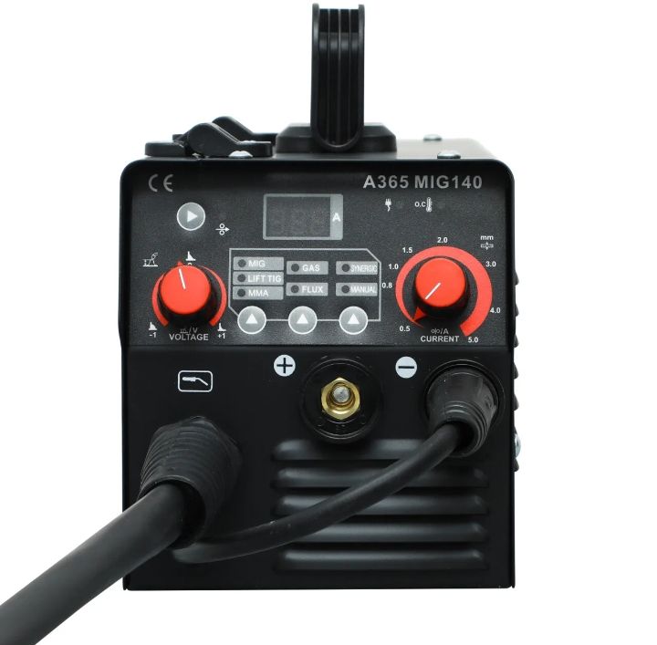

The "Dirty Pro" synergic at bottom right, at £105, is actually a surprisingly good machine.

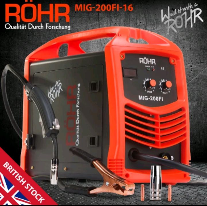

Yep , I use one as a portable down and dirty machine , the 50 amp min sounds tragic , but I was welding 0.8 steel , with 0.8 wire and it was cruising along the very best , now granted I do use a lot of joined spots rather than try to run beads , but thats just because it works for me , I bought the version with stick option too , the rohr 200mi I think , and used it yesterday as a stick because I couldnt be bothered to dig out an esab to weld with , the leads for the stinger are a bit short , but it ran 3.2 mm 6013s the very best , it was only a mates garage door so it was just a five min job , but still for the low extra outlay its a handy option to have , easier than swapping wire to gas less or lugging a bottle , and the bottle option wouldnt have worked in the wind anyway.The rohr machines were mentioned in another thread recently, referring to car body work…

The "50 to 140A" spec in the advert is incorrect The label on my £105 Dirty Pro synergic welder quotes a MIG range of "40 to 140 Amps", but in fact it goes down to 20A.50amp min…………mmmm
have you tested what voltages your getting at the tip end through each setting,again,just out of curiosityThe "50 to 140A" spec in the advert is incorrect The label on my £105 Dirty Pro synergic welder quotes a MIG range of "40 to 140 Amps", but in fact it goes down to 20A.
The synergic dial is optimistically marked from 0.5mm to 5mm. Like most Chinese sets it is underpowered compared to the calibration numbers, so for 0.7mm sheet you set "0.8" or "0.9". Similarly, in manual mode to get 30A for 1mm sheet, it needs to be wound up to 37A.
Apart from that, it is very stable, controllable, and the size of a shoebox. In synergic mode the preset voltage-to-wirespeed ratios can be "trimmed" with a centre-zero "+V and -V" dial. In manual mode the synergic control ( which is labelled in Amps as well as millimetres ) controls wirespeed.
