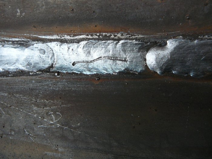

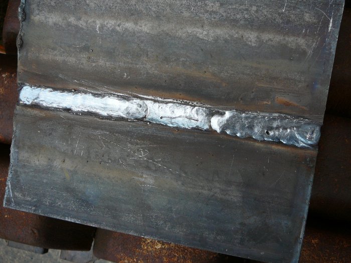

I may be wrong but I thought I'd read that shielding gas was a sort of optional extra with flux cored wire. For example, on Wikipedia, they use the word 'sometimes':
We have used several different cored wires, some could be used without gas, some had to be used with gas, usually co2 (we tried with an 80/20 mix and got worm tracks) but all gave the best quality welds with gas, so not really an optional extra in industry. The quality of the weld is more important than saving a relatively small amount on gas.
I have used gas less wire on normal polarity at home. It did the job, but I would not recommend it unless you've no option.
Fit the tig and argon bottle on the mig, wheel it around too. Now I must stop writing ideas that will never happen on this other fellas thread.
"Flux-cored arc welding (FCAW or FCA) is a semi-automatic or automatic arc welding process. FCAW requires a continuously-fed consumable tubular electrode containing a flux and a constant-voltage or, less commonly, a constant-current welding power supply. An externally supplied shielding gas is sometimes used, but often the flux itself is relied upon to generate the necessary protection from the atmosphere. The process is widely used in construction because of its high welding speed and portability."
http://en.wikipedia.org/wiki/Flux-cored_arc_welding
I'm keen to get hold of some industrial quality fluxed cored wire, to try it for myself.
