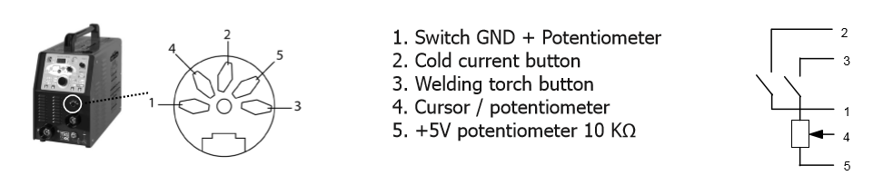

Hi, should be simple Parweld pro grip max torch, with STD single button as a swap for the item binzel torch. GYS say to connect red and and black to pin 2 and 3, but tried that and it doesn't trigger. I can pool the Binzel plug in and it triggers fine. Oarweld , switch and wiring seem ok. Continuity checked back to plug, on switch operate? The Binzel as a strange two position switch and us wired to all 3pins? Just about to work through all positions, but if anyone can put me out if my misery?cheers, Mark
