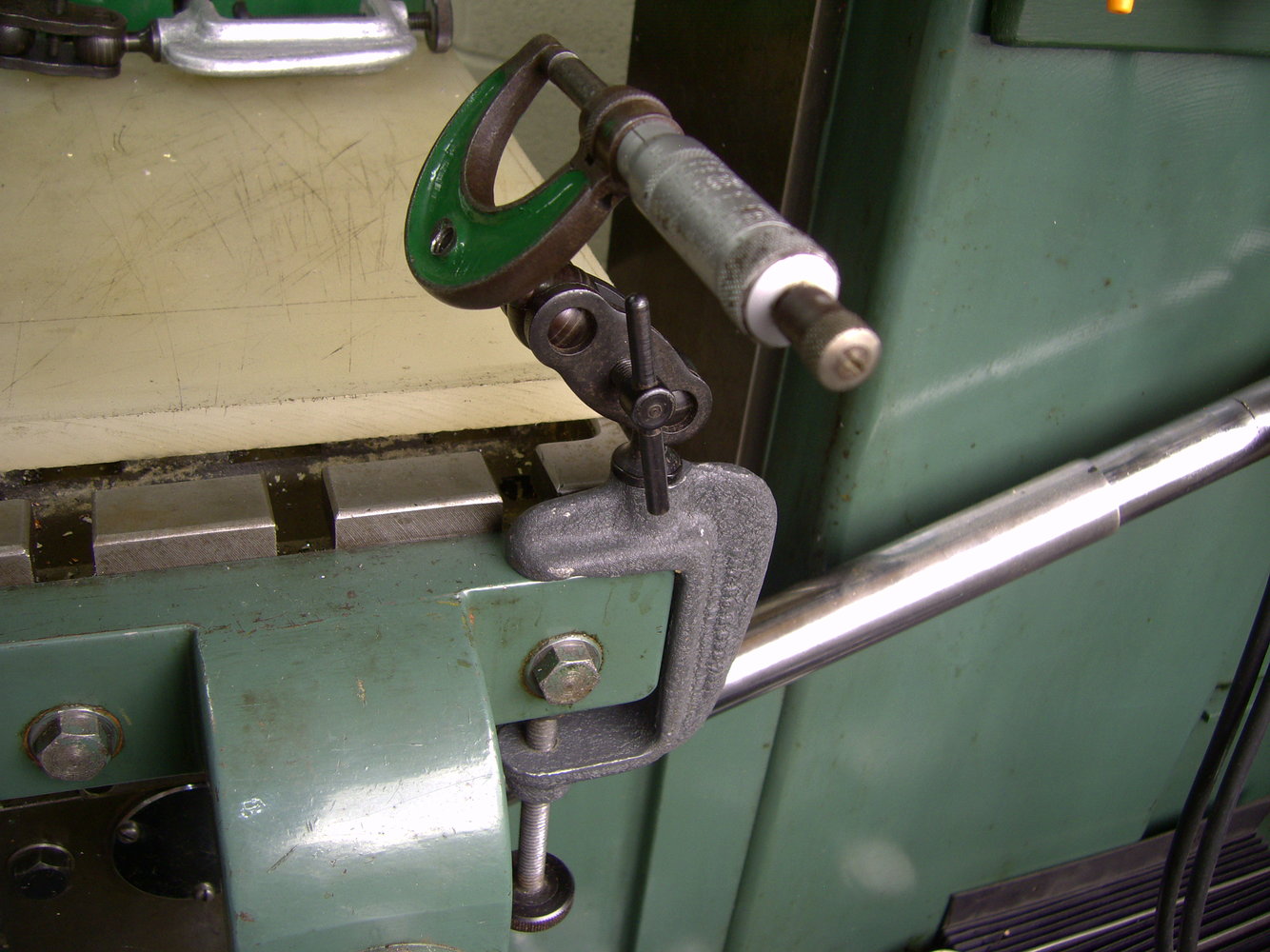

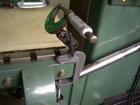

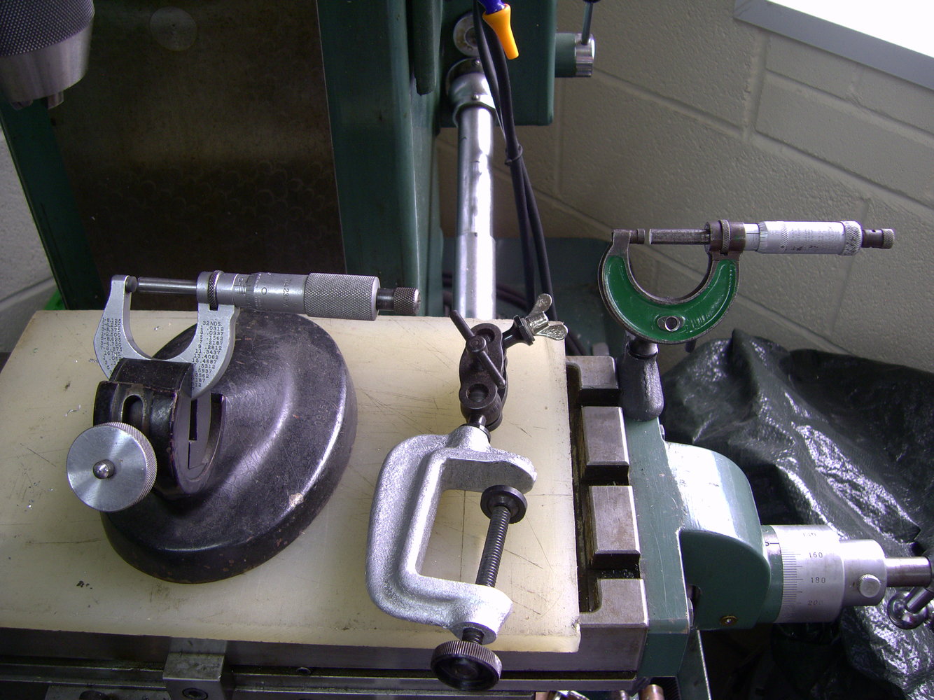

Sometimes one needs a third hand when measuring. I have a desk type micrometer holder, but it proves inconvenient at times to take a part over to it; so today while looking through a drawer, I noticed a couple of clamps with universal ball mounts I acquired awhile back, and got an idea. I have several duplicates of micrometer's, so I decided to drill & tap one and mount it on the clamp thing, which now can be fixed at a convenient location, like the end of my milling table.
