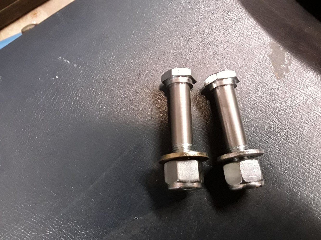

And find the bolt head isn't swaged true to the shaft, so it's impossibly to tap true......Buy a collet chuck?
I thought I reckonised it from over 30 yrs ago of playing with Spit bits. If there's a sleeve bonded in, its not the right shock - but in the spirit of making do, use the correct bolt for the sleeve and make a simple short sleeve/spacer to sit in the bigger hole in the chassis and avoid the issue?It is actually the correct bolt for a Triumph GT6 rear shock as the originals did not have a sleeve in the bush
Same for Spitfires and if memory serves the Herald and Vitesse as well
I'm guessing that whatever shock is being installed already has the sleeve bonded into the bush

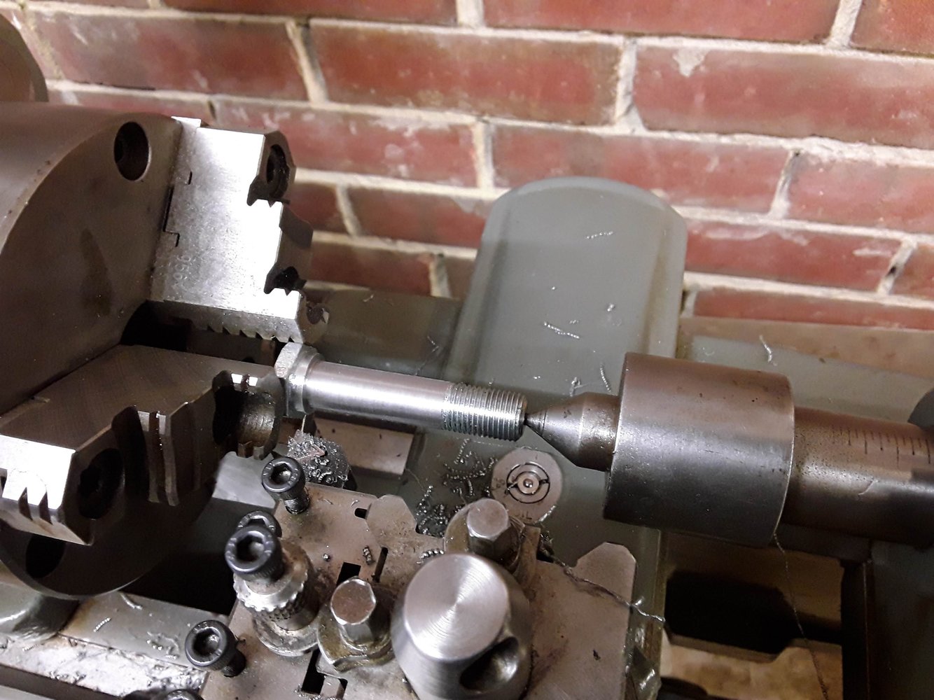

….the hex head doesn’t need to be concentric with the thread does it...
Be interesting to see someone trying that suggestion.grip the head, but in a 4-jaw and dial the plain shank in until it is running true.
Tried that and it doesn't workBe interesting to see someone trying that suggestion.
Sorry it taken so long boss but I'm not a professional machinist! I haven't been standing here scratching my balls for days looking at it though.Hells bells, too much talk and not enough go. I could have set it running true and centre drilled both ends, and then turned it ‘between centres’ while it’s been discussed on here - not that some options (with care) would not have sufficed.
