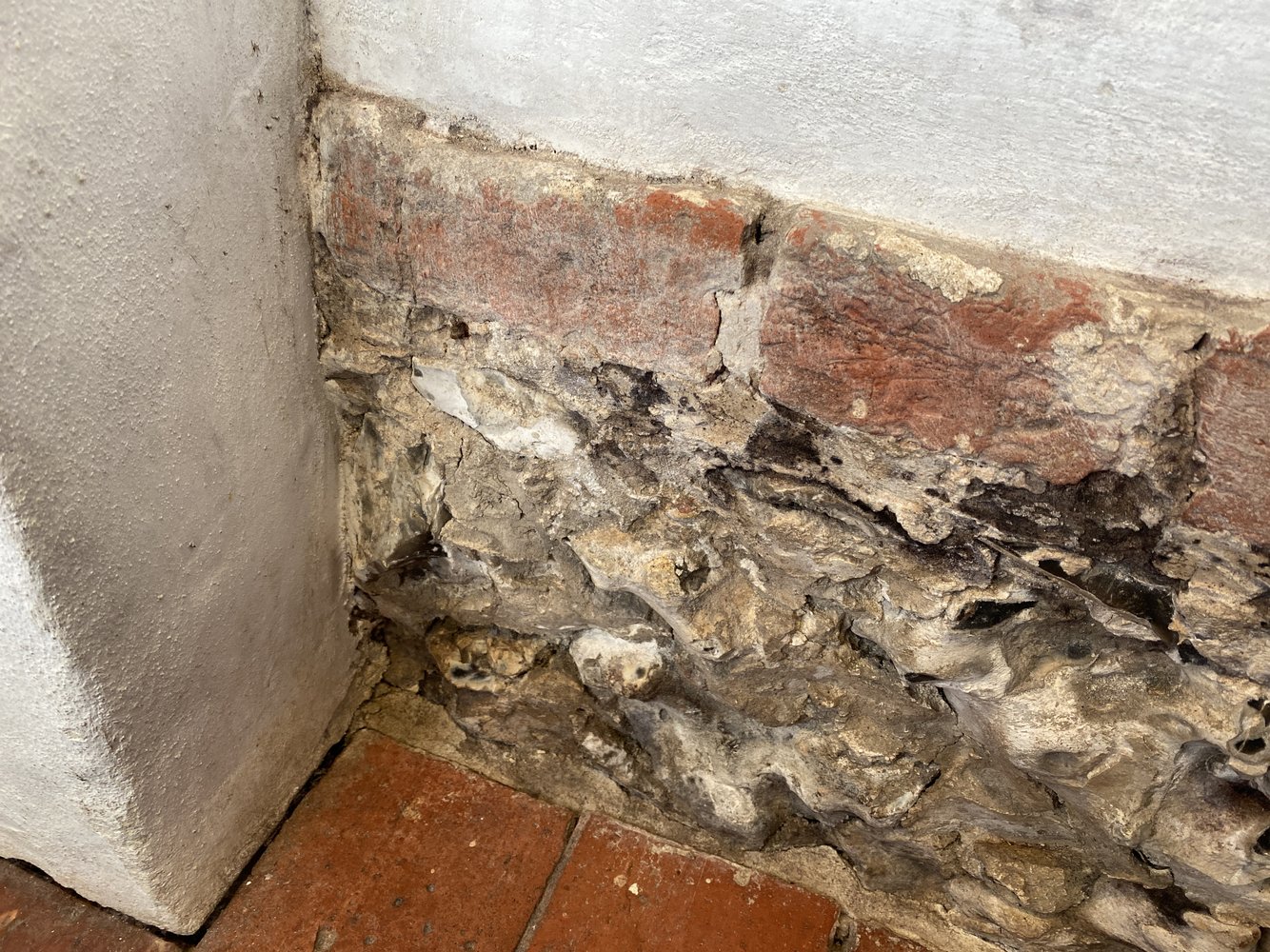

You can play about with drainage and shingle traps around the building but nothing will help more or get a quicker result than biting the bullet and fitting a damp course. Its not difficult. beat a hole in the wall big enough for the roll of dpm, insert roll and knock out wall in front of roll while bricking up/dry packing behind it. You can do a meter a day like this quite easily.
