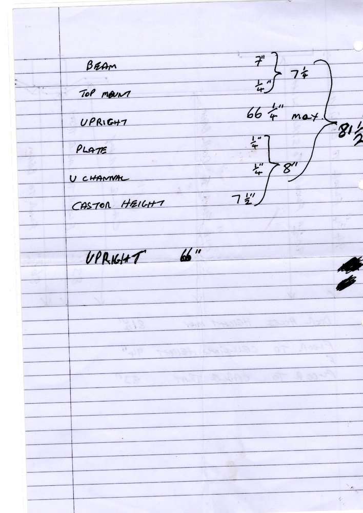

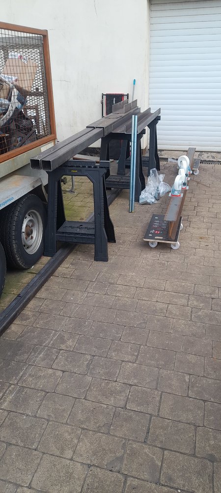

Ordered some material a while ago.

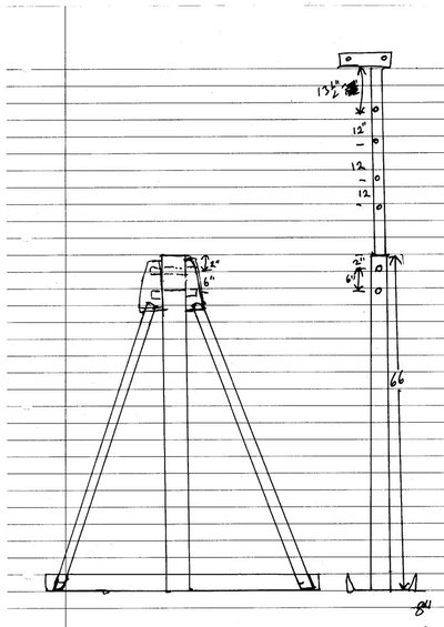

I spent the day checking my layout/measurements on the scrap paper design, against the material and started cutting to final size, this will be an as and when, I get time build.
Today I was laying out and confirming the height control holes.
I will add photos of the build progress.
