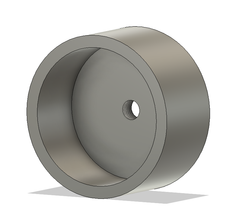

I’m looking for someone to make me a one off part via a metal lathe hopefully or 3D printed poss..
i need a flat ( non cambered ) belt sanding wheel made from Aluminium or similar
(lightweight) It would need to be 100mm diameter by 50mm cross section and with a centred 14 mm thread ( if not a thread , a centred hole for a m14 thread to pass through where i can put a nut on the other side )
The cross wheel width is the most essential measurement the diameter could be a different size so if someone already has something similar that could be modified a little if need be then great..

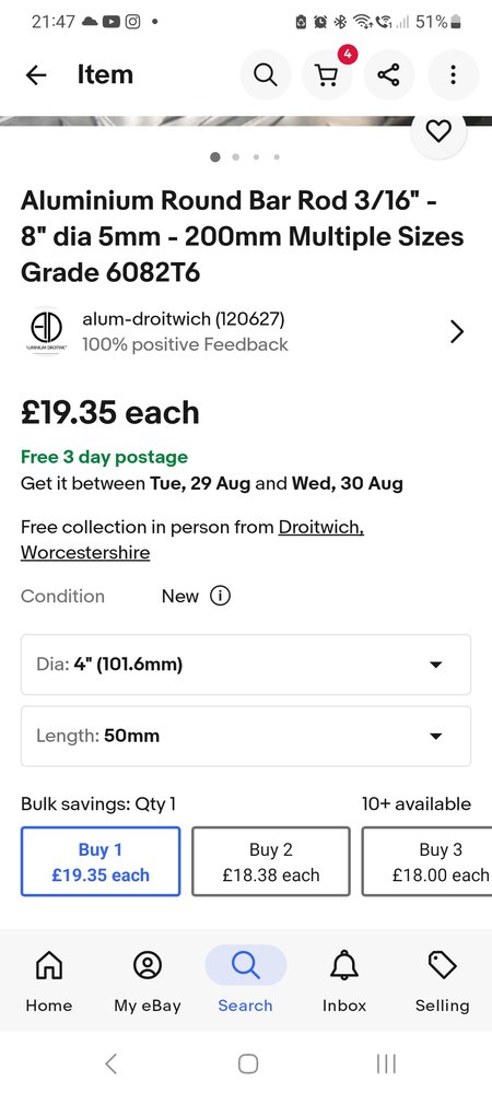

Alternatively, drill your own hole through a piece of bought-in Al round section bar (available on ebay for £20. Sand it flat after installation.

So it will need boring out?
Either would be fineI'm confused by the m14 thread. Do you actually want to thread a bolt into it or just pass it through?

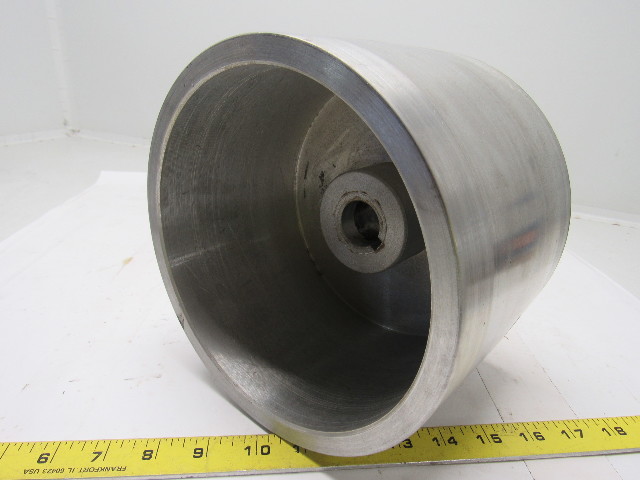

3D printed left hander would be easy. Aluminium version would be more expensive as I dont have one. lolIf it is going on his motor, it will need some form of driving key. If just a thread it may need to be a left hander to avoid undoing itself. Likewise, a bolt may need some thing to prevent it undoing spontaneously.
The plot thickens.
The OPs photo shows a keyway..If it is going on his motor, it will need some form of driving key. If just a thread it may need to be a left hander to avoid undoing itself. Likewise, a bolt may need some thing to prevent it undoing spontaneously.
