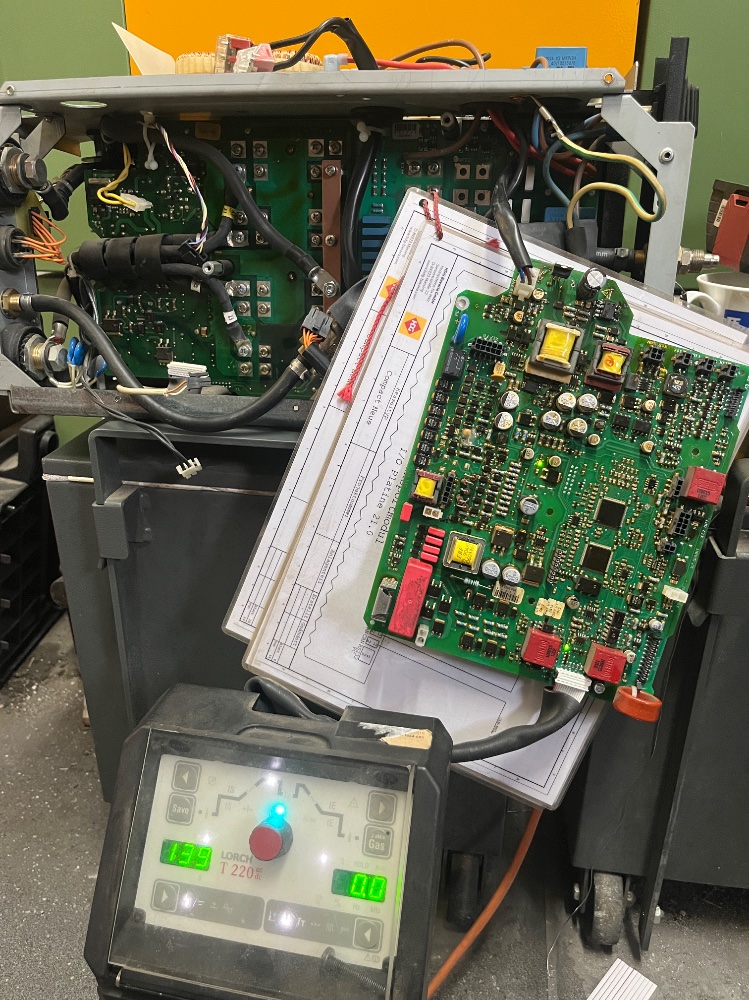

Jan-DIY Member Messages 774 Location Lower Saxony Germany Jan 20, 2021 #1 Hi all. Got this machine send over to have a look at it. SMPS TOP245 shortet out. Replaced and now i got Error E07 message which is not mentioned in any manual i got. Anybody know this kind of Error?

matt1978 www.lorch.eu Messages 3,967 Location UK, Cannock Jan 20, 2021 #6 On the older software there was an E07 (described in the 2nd column) Here you can see a description from the service manual Can you check the cables as described
Jan-DIY Member Messages 774 Location Lower Saxony Germany Jan 20, 2021 #7 Thank you Matt! Will check. Keep you informed. Jan

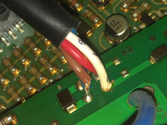

Jan-DIY Member Messages 774 Location Lower Saxony Germany Jan 20, 2021 #8 Grrr. Got it. Or spot it. Traces on 2nd or 3rd layer vaporized. Try to discover other landing point. Somewhere on DC bus. Bad soldering anyway. 9F77AC5F-2CB9-4C4D-B793-705812117913.jpeg 307.7 KB · Views: 156
Jan-DIY Member Messages 774 Location Lower Saxony Germany Jan 27, 2021 #9 Got it back to business. Not that easy. TOP245 switcher, several copper traces, ceramic cap and finally feedback oc. thanks to @matt1978 to give me a hint to smps reasons. Jan
