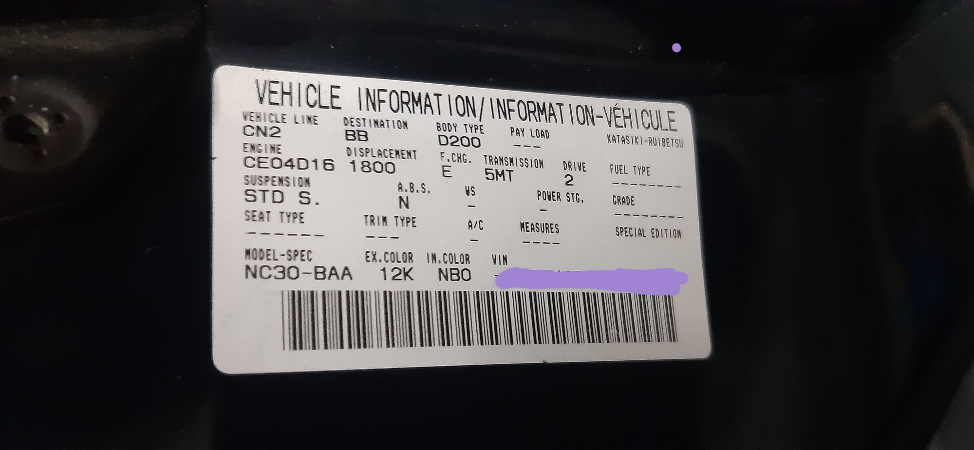

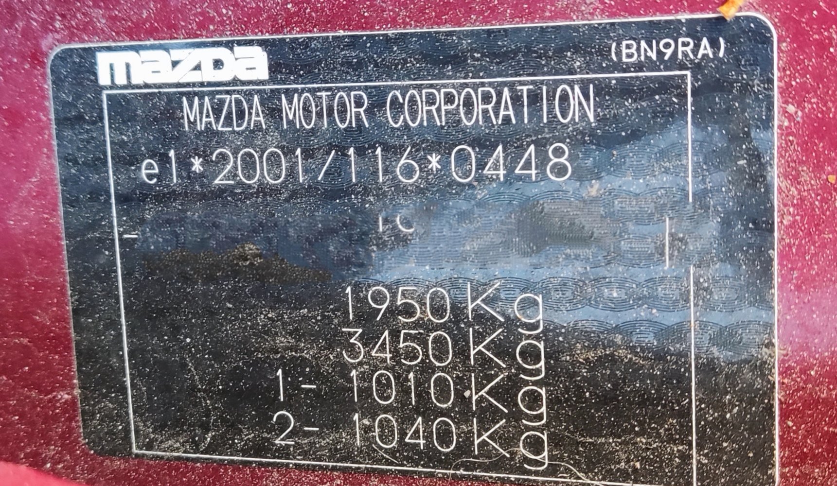

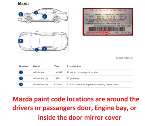

Silly question but where can I find out the paint code? Car did not have a manual or many details with it, really just V5 and keys.

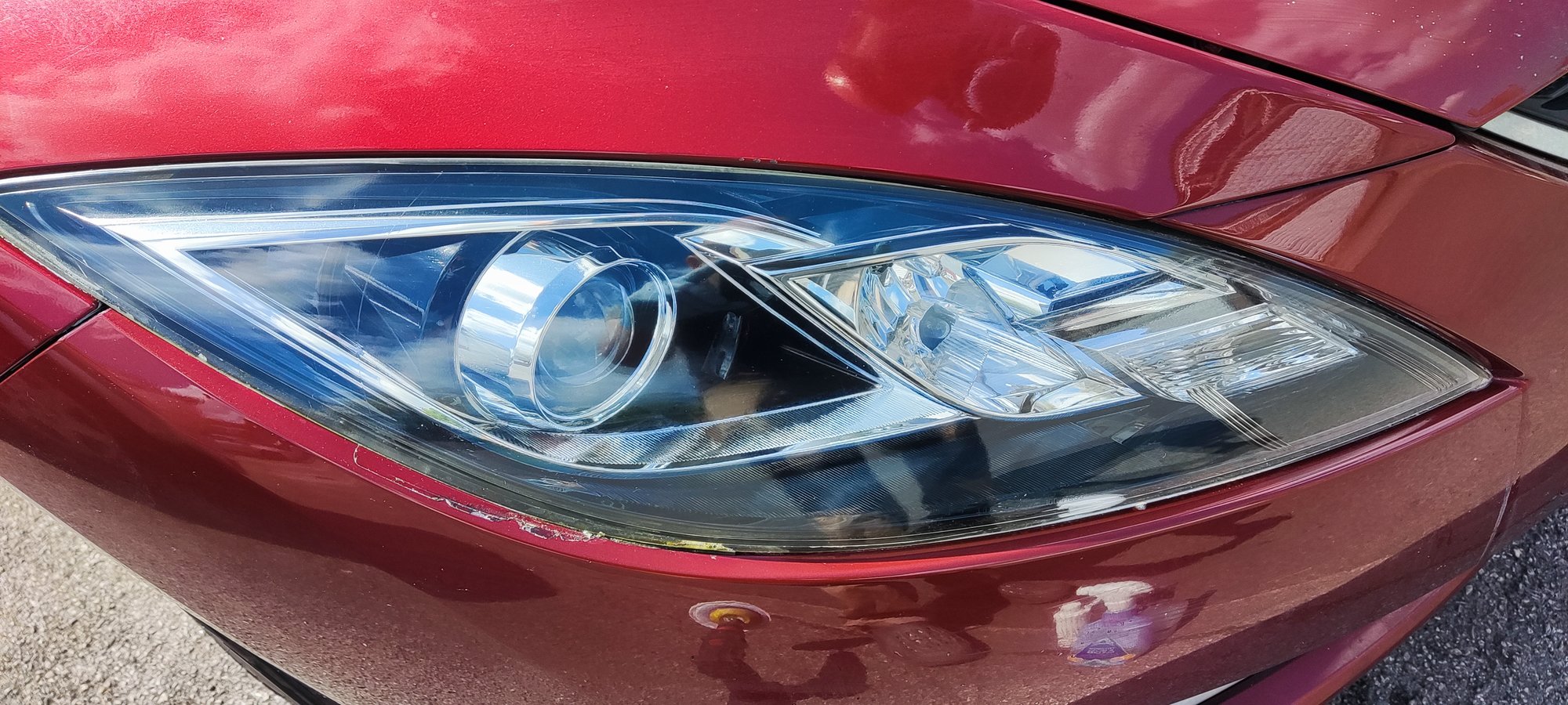

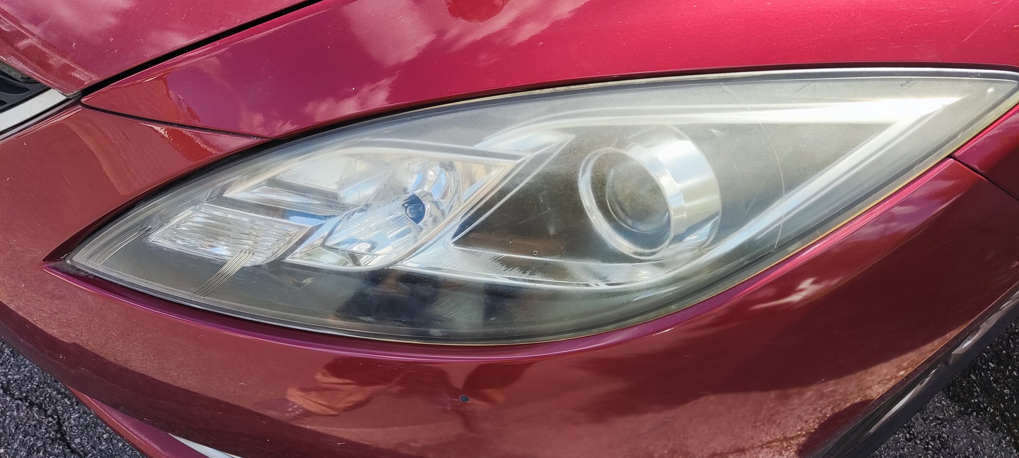

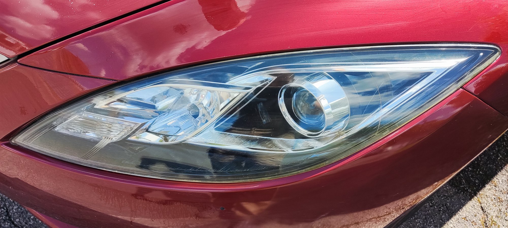

I took my sanding pads, cordless drill and 3m polish out to car.

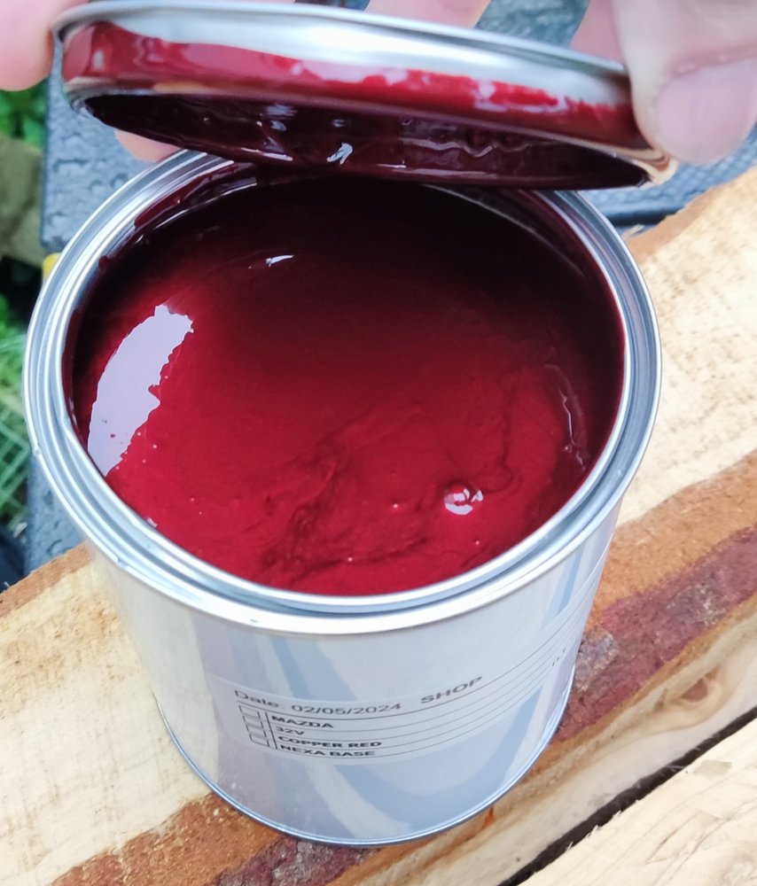

Looks great. Did you take the headlights out, or mask off the paintwork and do them in place?I got the paint last week

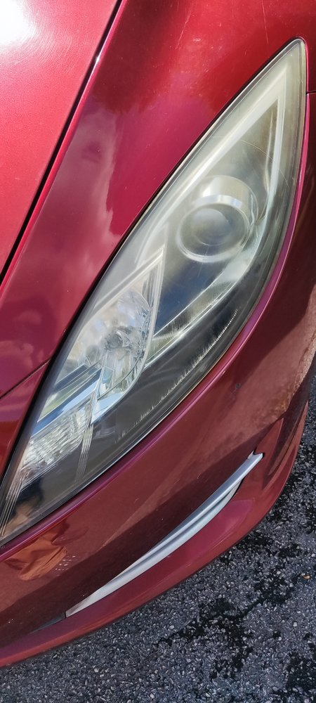

Then started thinking about my degraded headlights.
I took my sanding pads, cordless drill and 3m polish out to car. I didnt really want the effort of dragging the compressor and my 1k clearcoat cans seem to have leaked, so that means any sanding would need to be done in 2k and potentially two days without driving for it to fully harden,hmm, good reason I thought to just try the polish.
View attachment 448288View attachment 448289
Very happy with results. Theres an area on the nearside that looks like the dirt has overheated the plastic and melted the inside, no amount of sanding or polishing could fix that without opening it up.
In place with no attempt to mask or avoid the paintwork. My reasoning being, the paint is not going to be damaged and likely needs it just as much as the lights. If I were going to sand I would have had to mask and be much more careful, either doing it by hand or by taking the lights out.Did you take the headlights out, or mask off the paintwork and do them in place?
