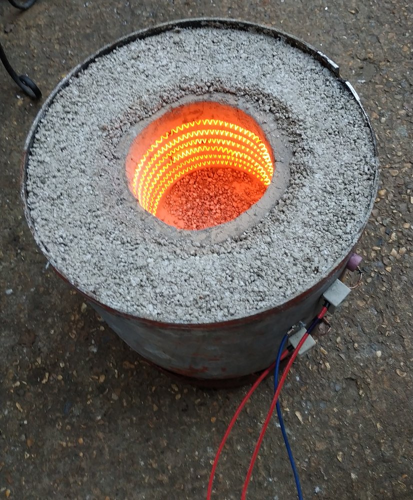

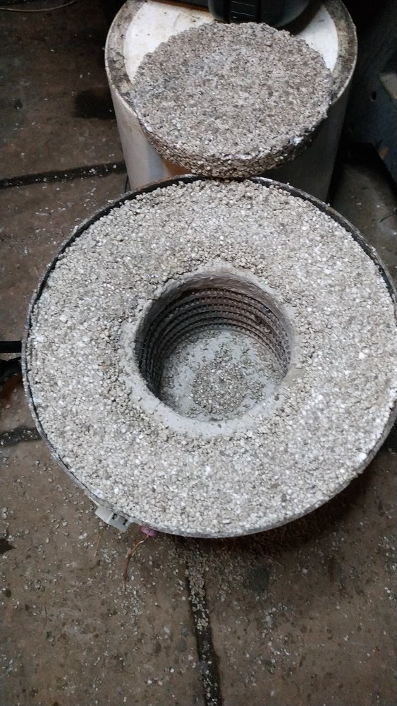

Looking at @Kram 's fire clay/element build...
Thinking to:
3D print the inner of a mould with a spiral on the outside. Should allow the element to sit perfectly, In segments for easy removal.
Then place in a large container and fill the gap with this stuff:
Thinking to:
Vitcas Refractory Castable Grade 1600°C-Refractory Concrete
Castable Refractory (Refractory Concrete) is used for repairs to boiler linings, boiler doors and incinerator linings. For use where localised temperatures are higher; for example in gas or oil burner blocks and where forced air is being used.
