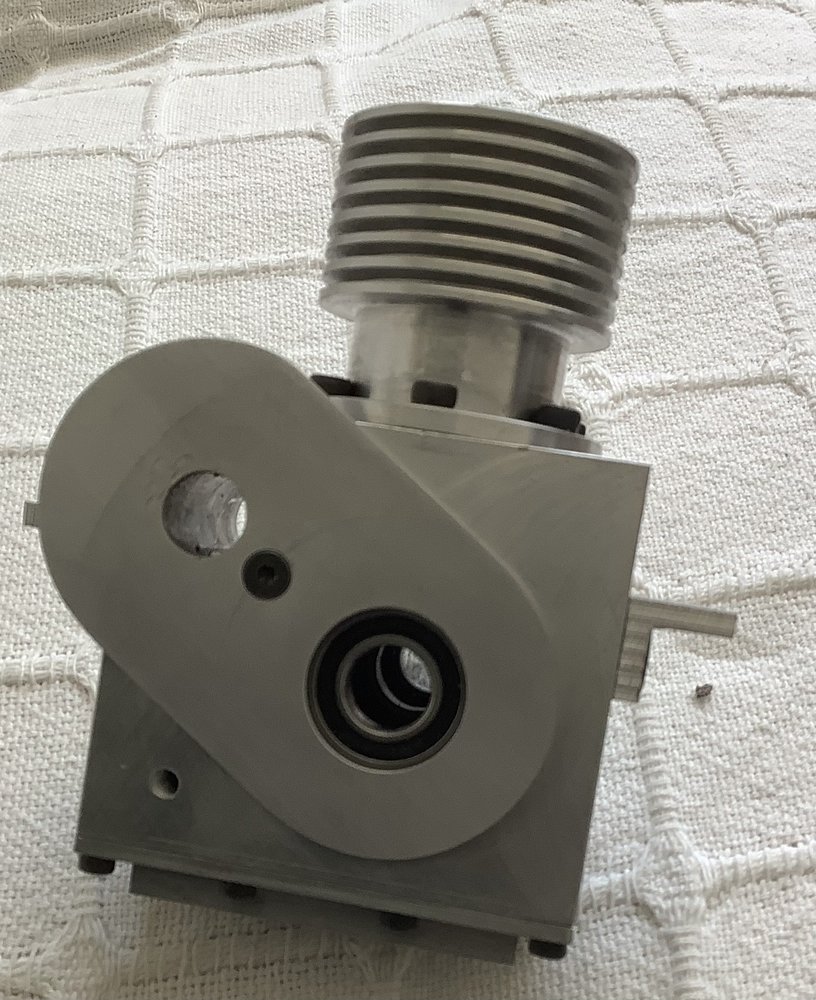

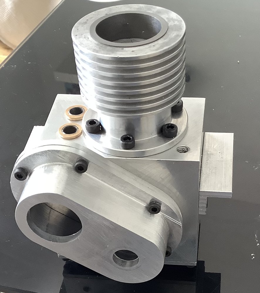

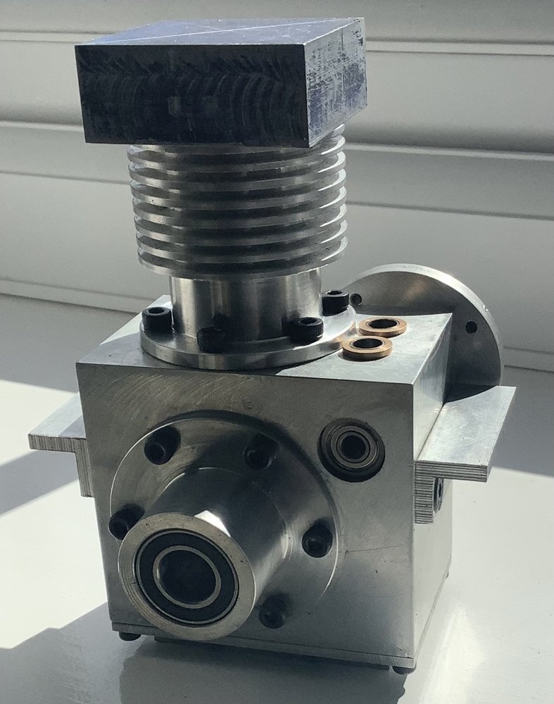

When I was into model ic engines moffet were the place to source gears . I don’t know if that’s still true?A quick update…
Not much done today, I had to visit the doctors…
But the postman dropped off some more bits:

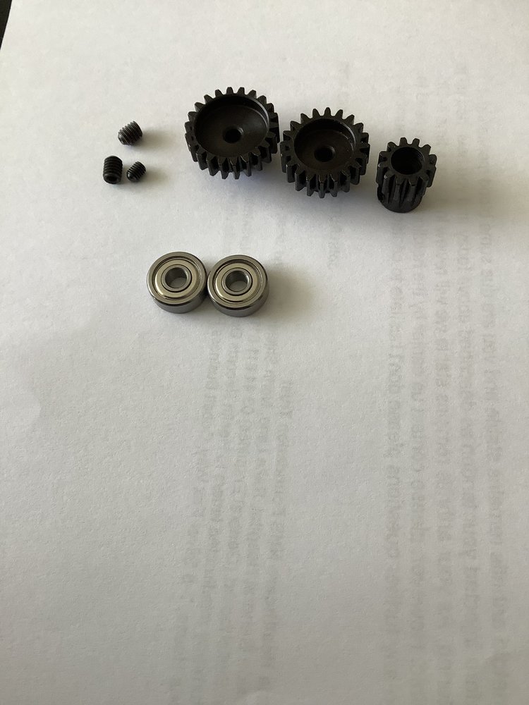

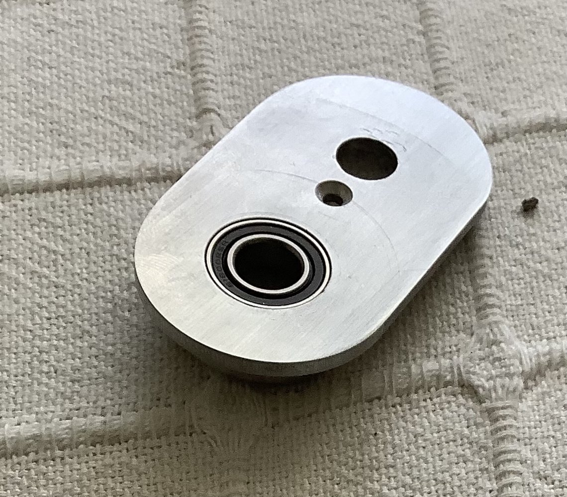

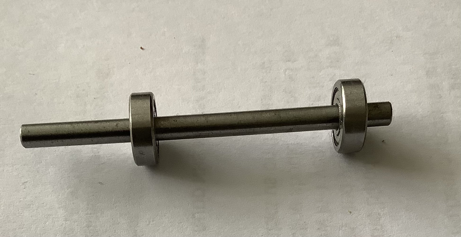

3 gears for the camshaft drive and 2 bearings for the camshaft…
Why 3 gears? Well the middle on is just an idler, makes the camshaft rotate in the same direction as the crank…much cheaper than a belt or chain drive and no adjustment to make after installation.

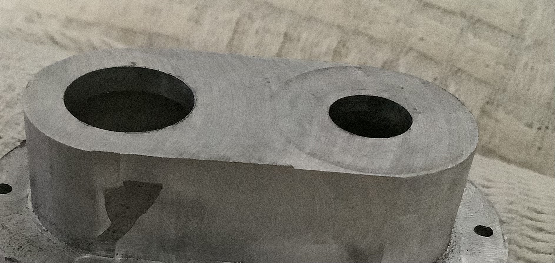

the man who never made a mistake , never made anything ...Some major cock up today….
Must have got a measurement wrong!
