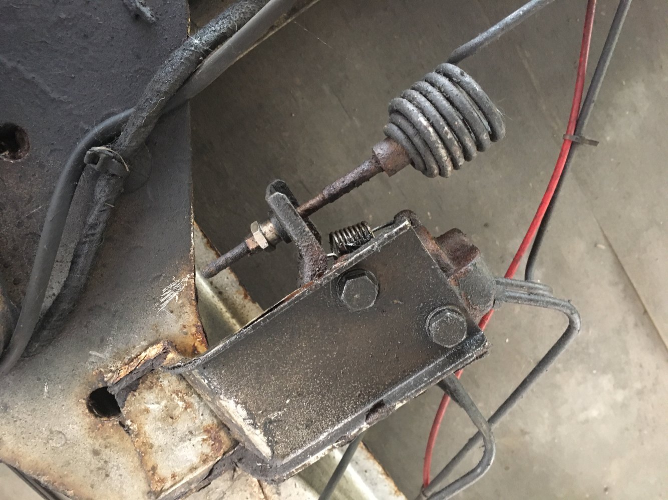

Camper van the load over the back axle operating the rear brake loading valve is fairly constant IE pretty well fully loaded van so the Valve should be operating the rear brakes pretty close to max pressure. Now my camper has air bag assist i usually inflate to 50 PSI in doing so i raise the ride height so less back brake the rear discs are rusty due to lack of use. And to be hones the brakes on the van could be better. All four callipers are working well and not sticking using apec pads all round. comments welcome.
