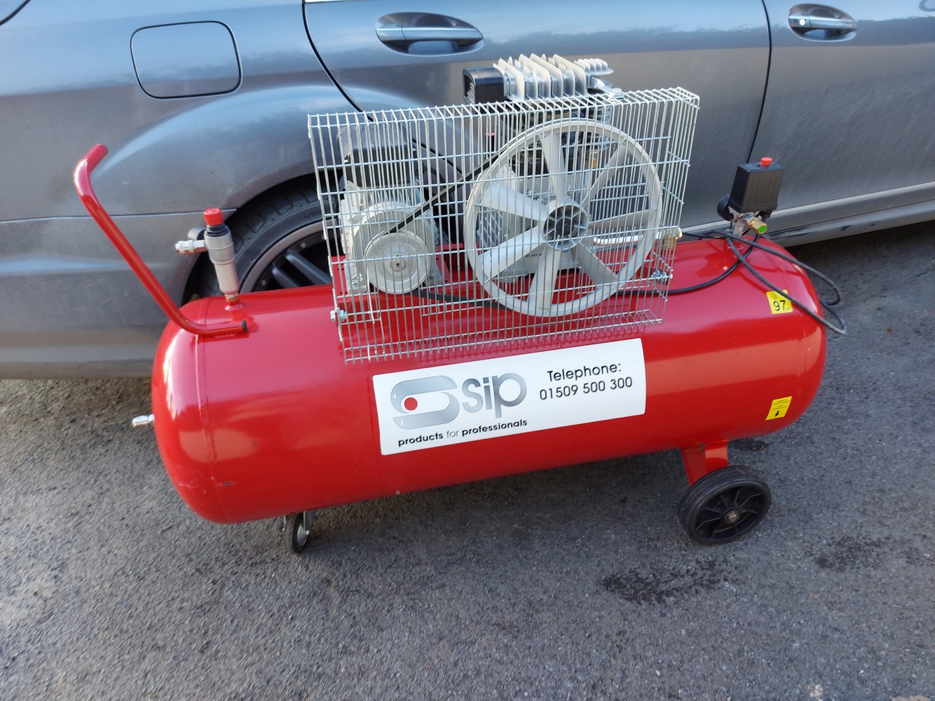

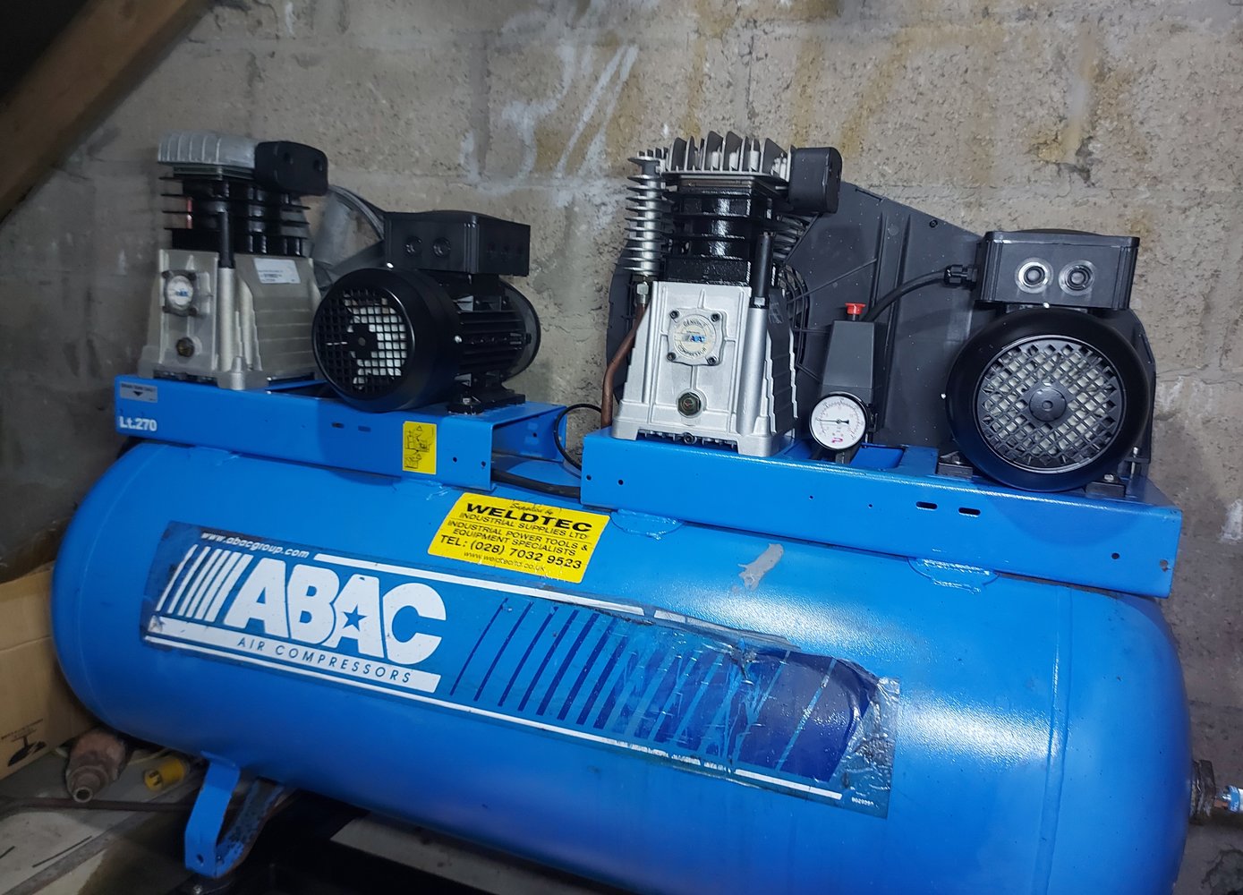

I did this before recently mounting my 270L tandem air compressor up in my back garage loft.

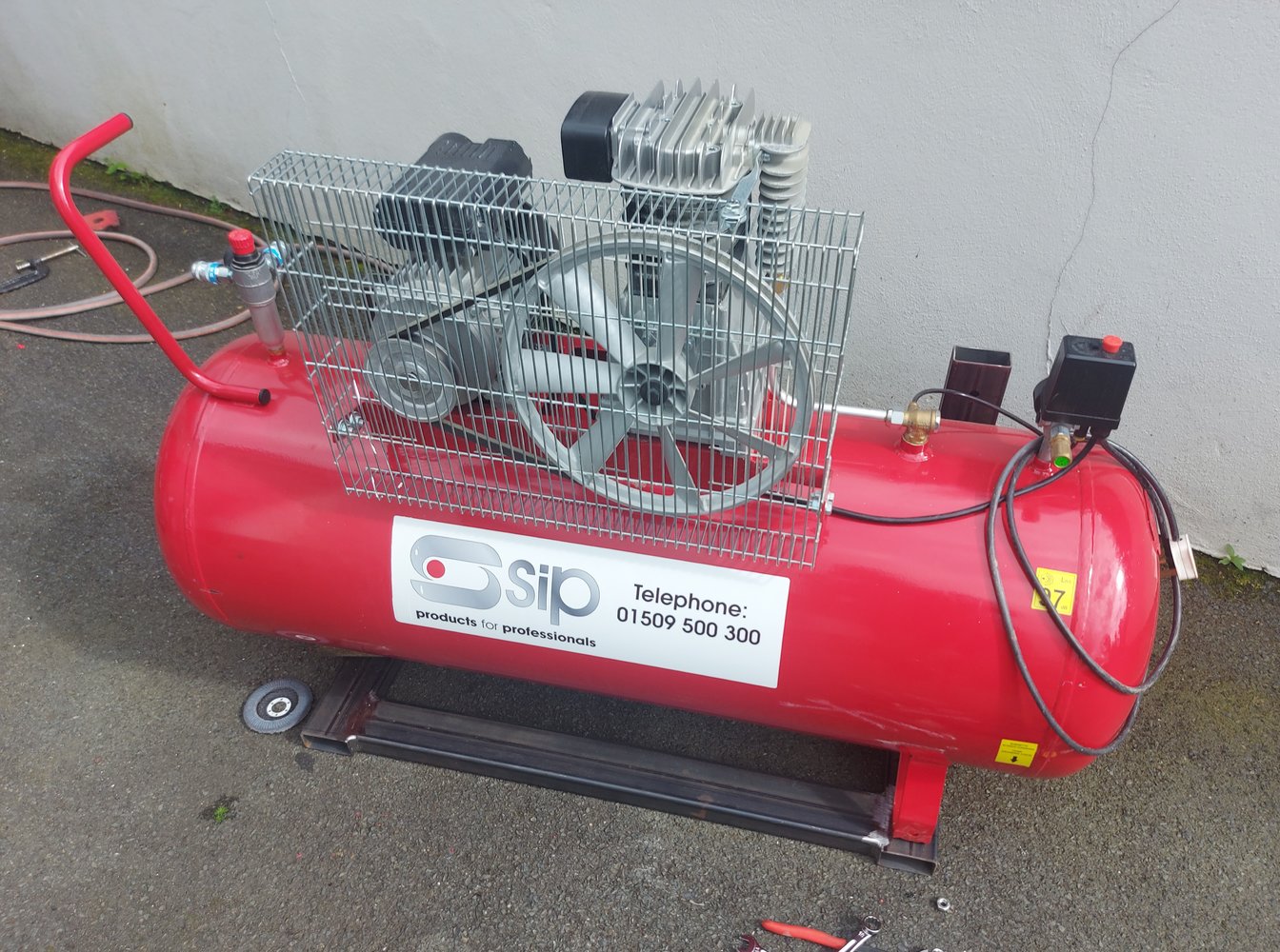

I have another 200L SIP compressor for my front garage

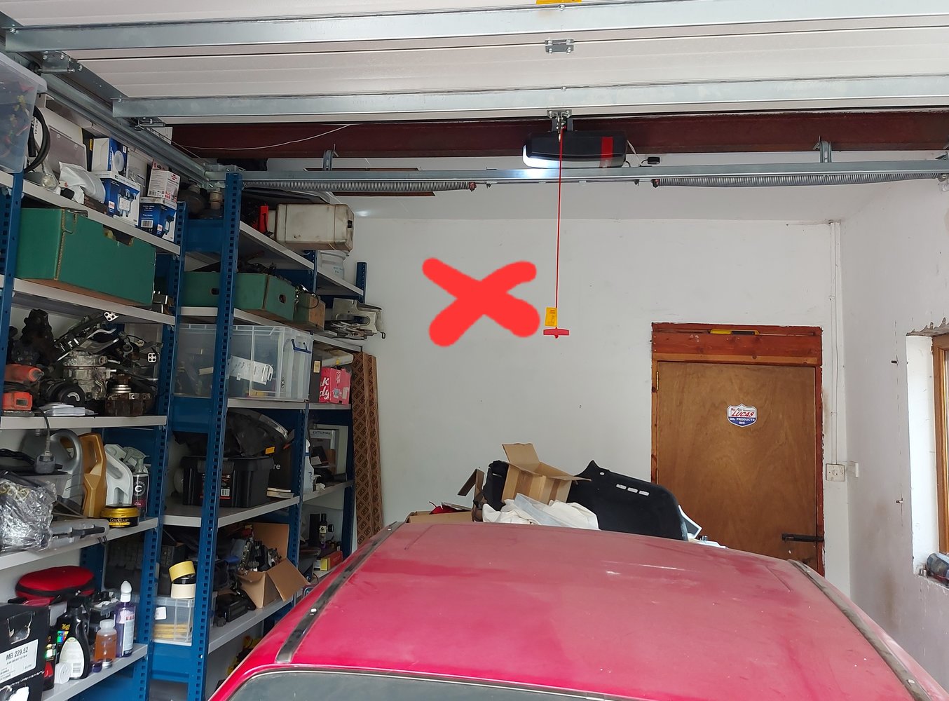

But my front garage is a single garage and tight for space when a car is in it which will always be the case.
So I need it up out of the way. My single garage is part of my house - inset into at ground floor level with a room above. But the ceiling height is decent that I can utilise a portion of wall and get this compressor up out of the way and attach a hose reel to it.

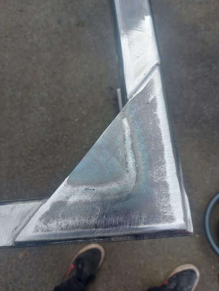

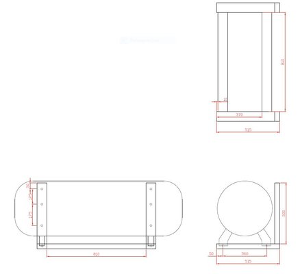

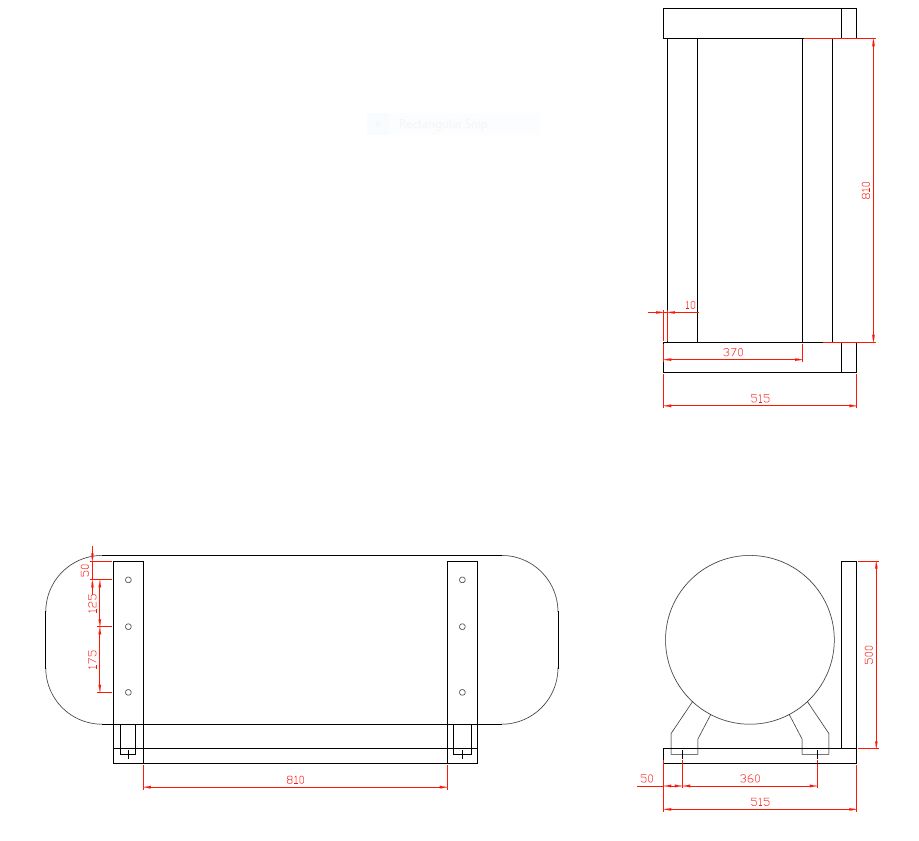

I started drawing up the bracket and cutting the steel today so I figured I'd share this mini project here as I go. I'll follow with updates here of progress over the next couple of weeks until I get the bracket made, painted and mounted. The conoressor itself will have to wait a while longer before I can get it raised up onto the bracket as there is a car on axle stands in the way.
