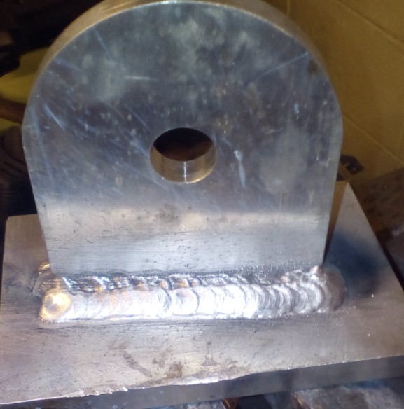

So I decided to look at getting an inverter based Mig which I was hoping would manage 1/4" alu and under , when I tried it out I was quite amazed at what I could achieve with it, even upwards of 1/4" was possible.

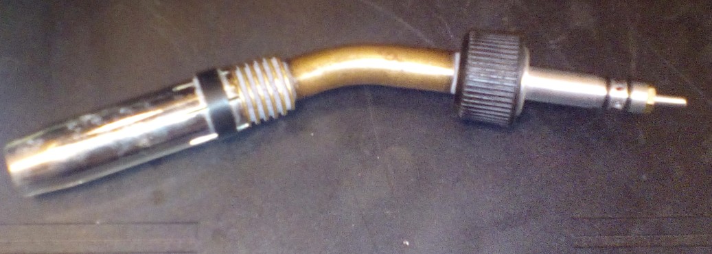

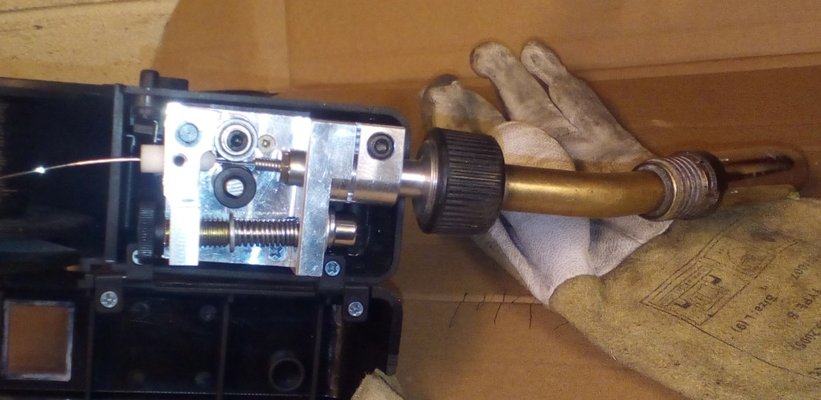

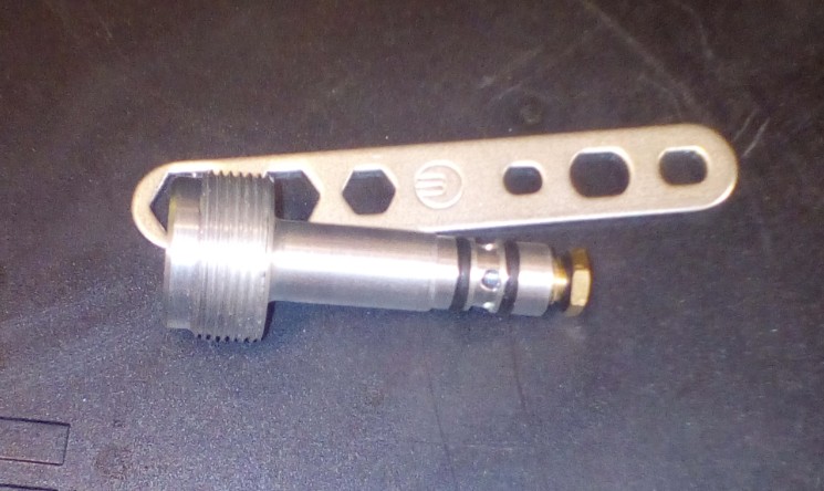

I liked the gun but wasn't liking the straight neck as I am used to the swan neck I have on the SGS360, you can rotate it to any position which makes life easier when welding in awkward positions. Sadly there doesn't seem to be any such options for the smaller spool gun so I decided to make my own adapter up so I could fit the swan neck and it works a treat, also has the added advantage of more standard sized shroud etc.
