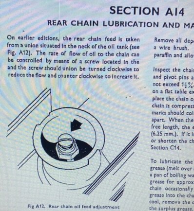

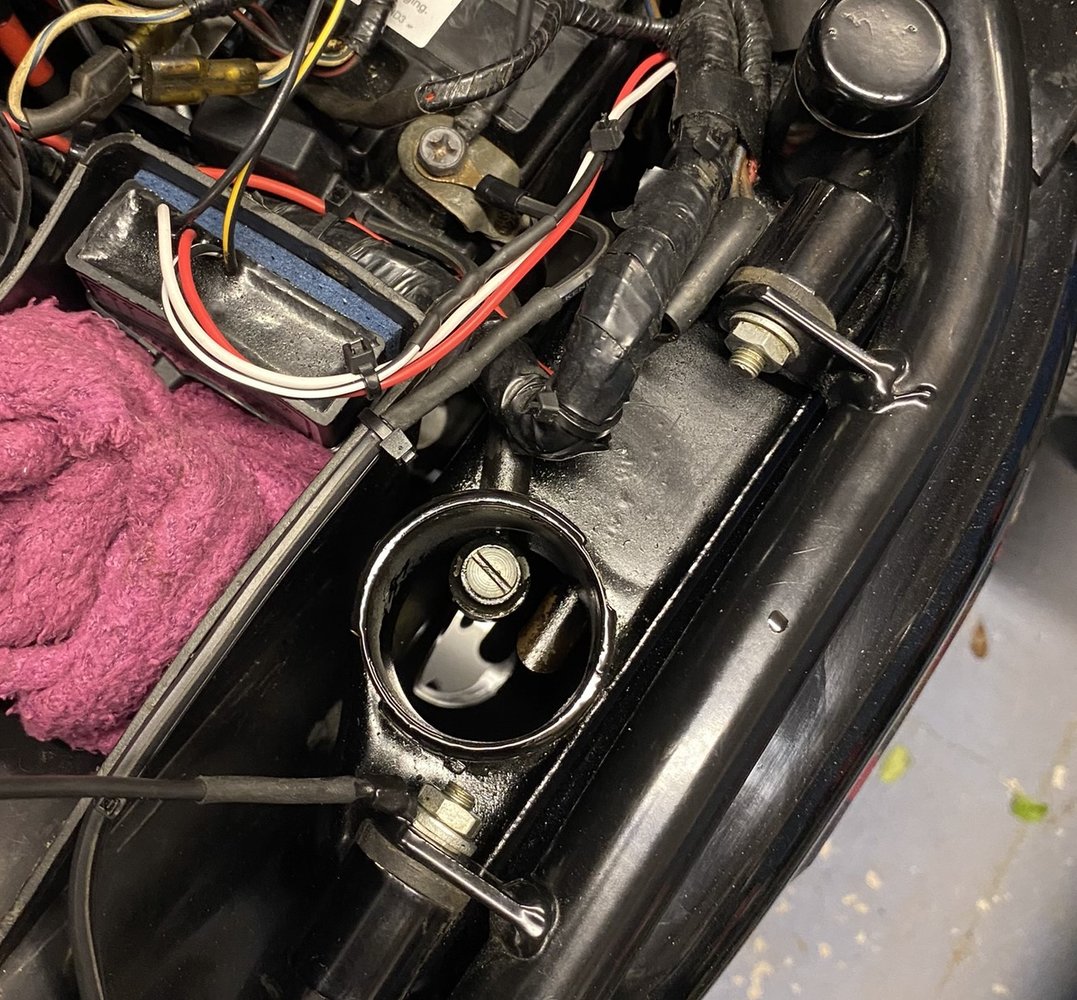

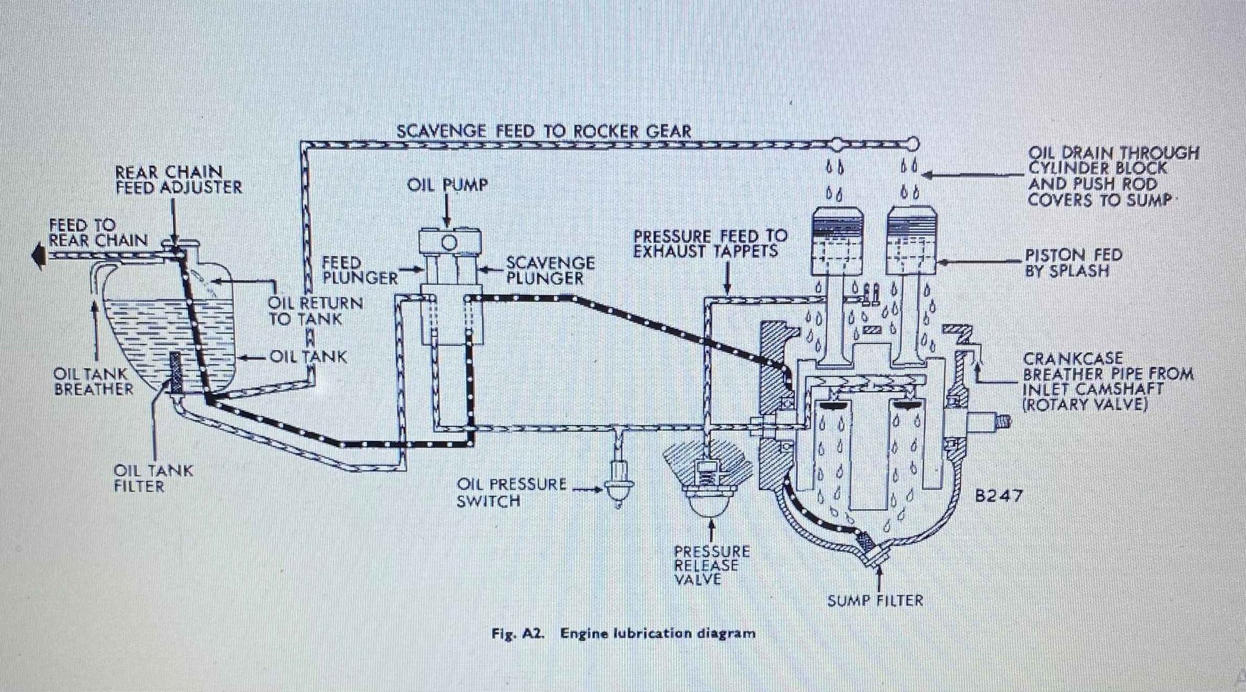

Pretty sure that's what old harleys did.Not wishing to be argumentative but are you sure - oil from the primary chain case?
Correct me if I'm wrong but I thought the feed for the chain lube came from an off take from the engine oil tank return line.
