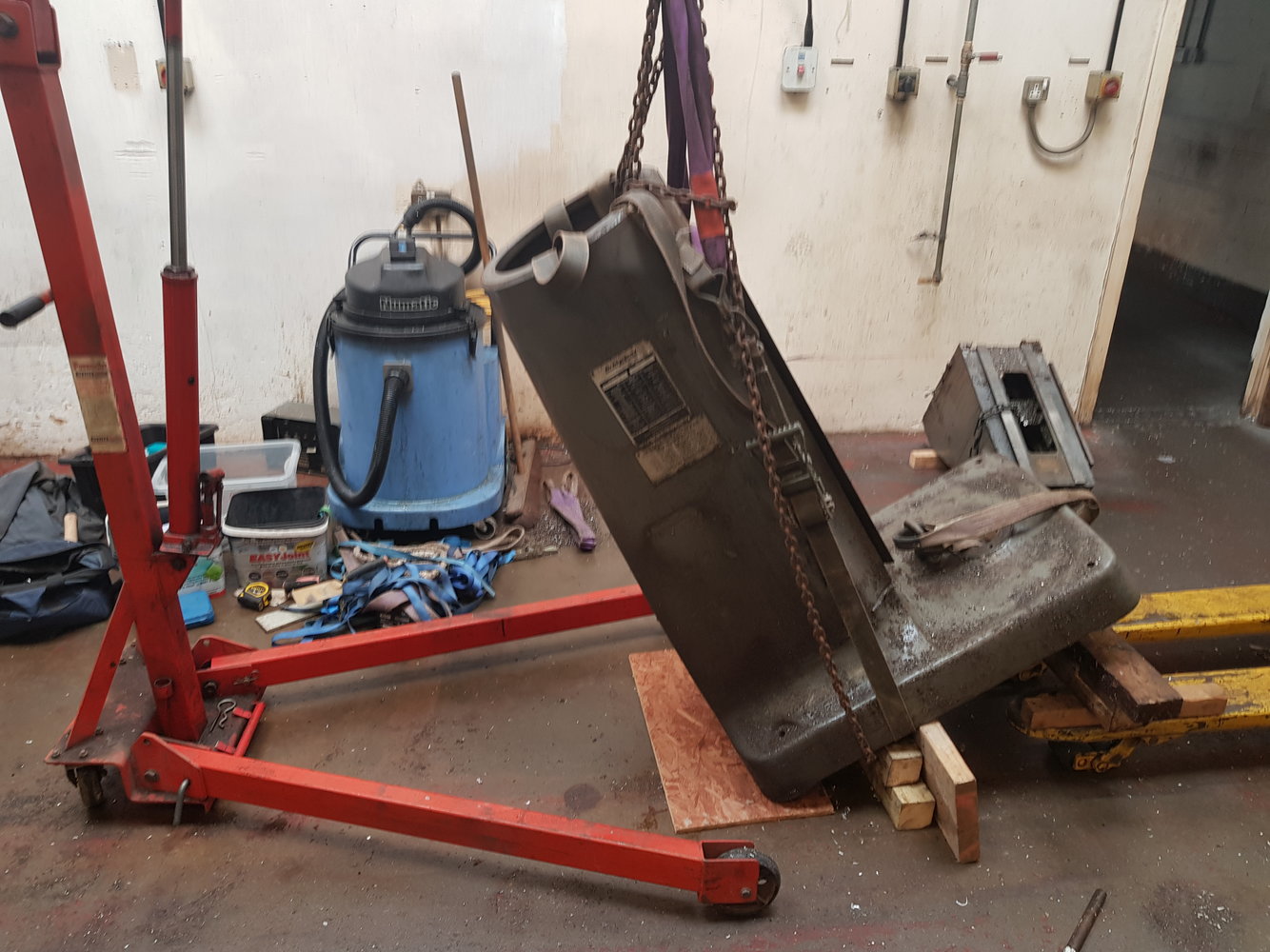

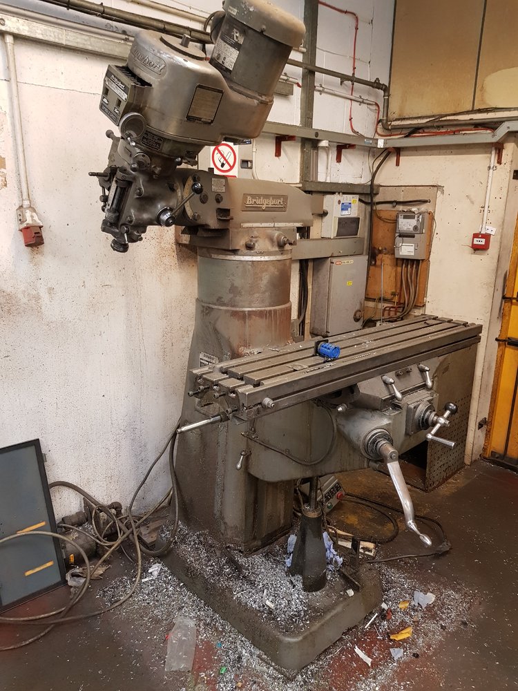

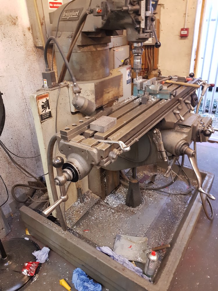

Trailer with hihab would make life easier but if you are concerned it might get stolen then I guess needs must.Its been will but final got access to remove this machine

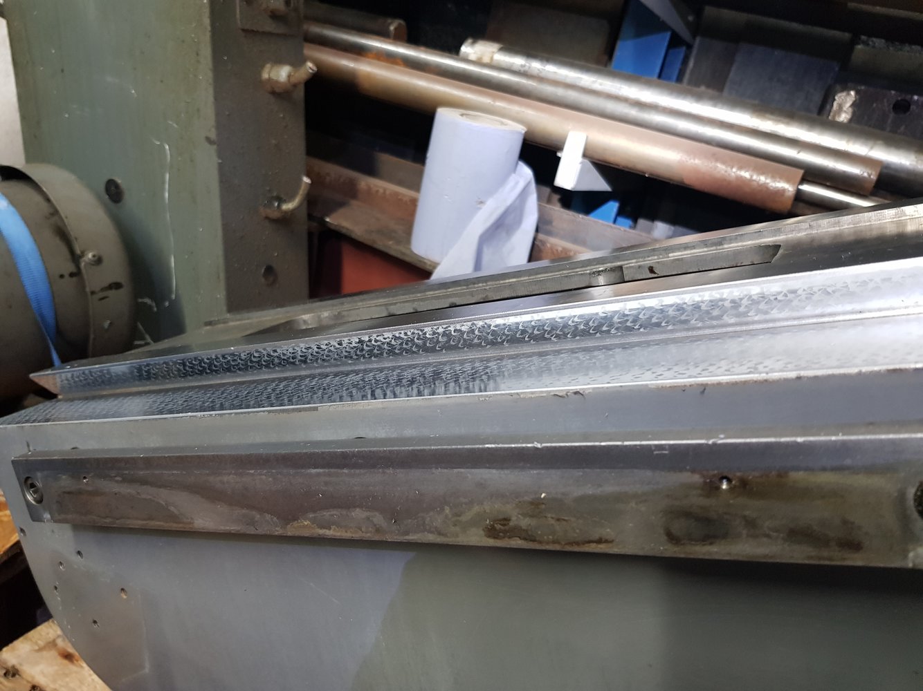

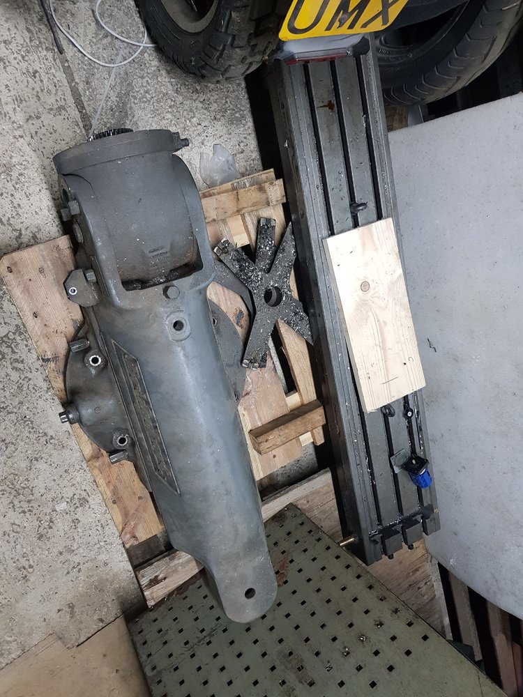

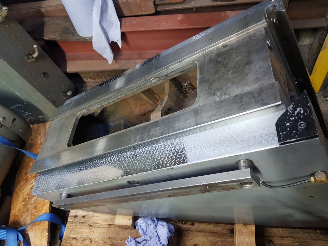

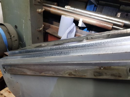

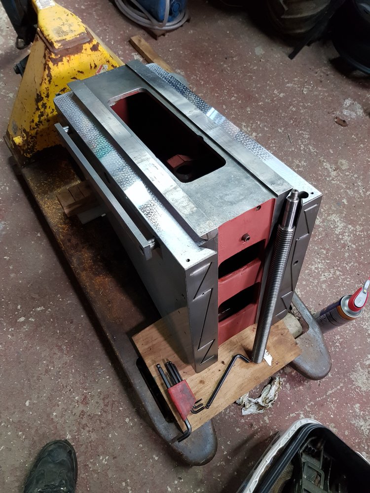

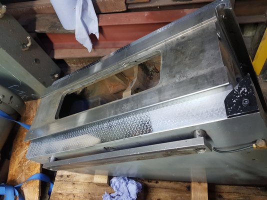

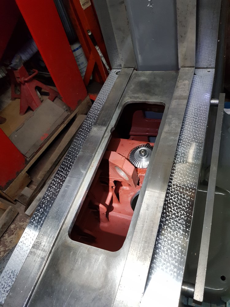

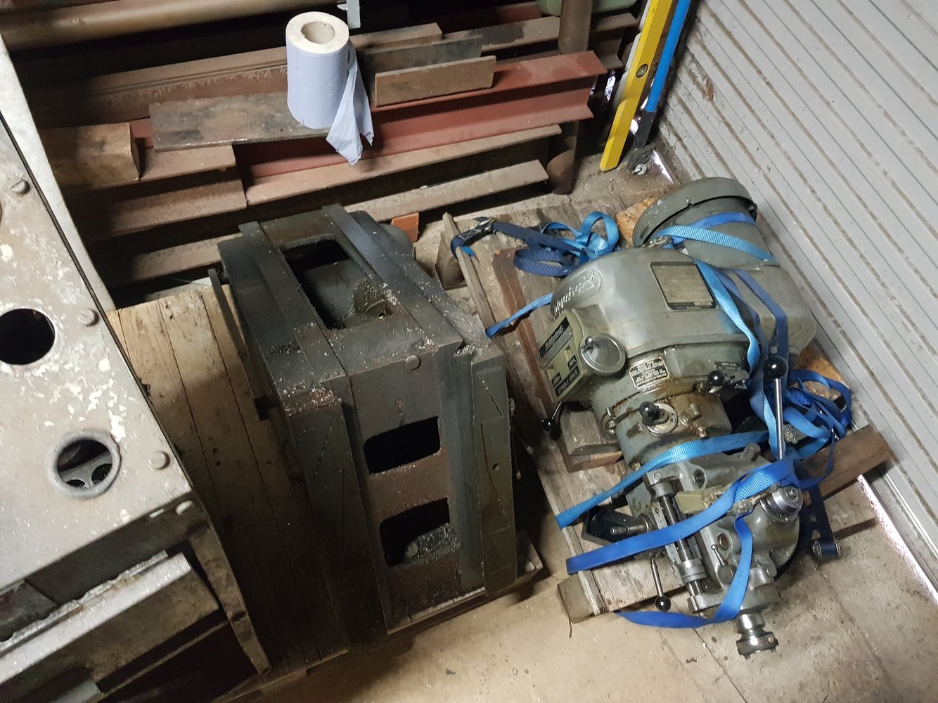

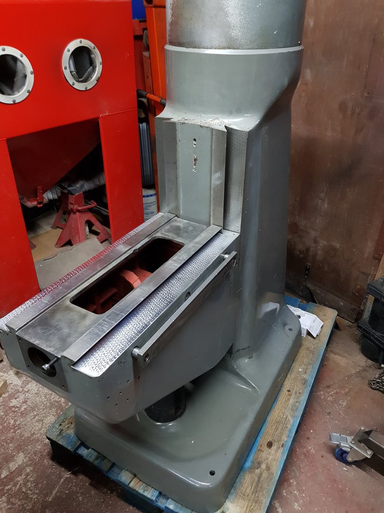

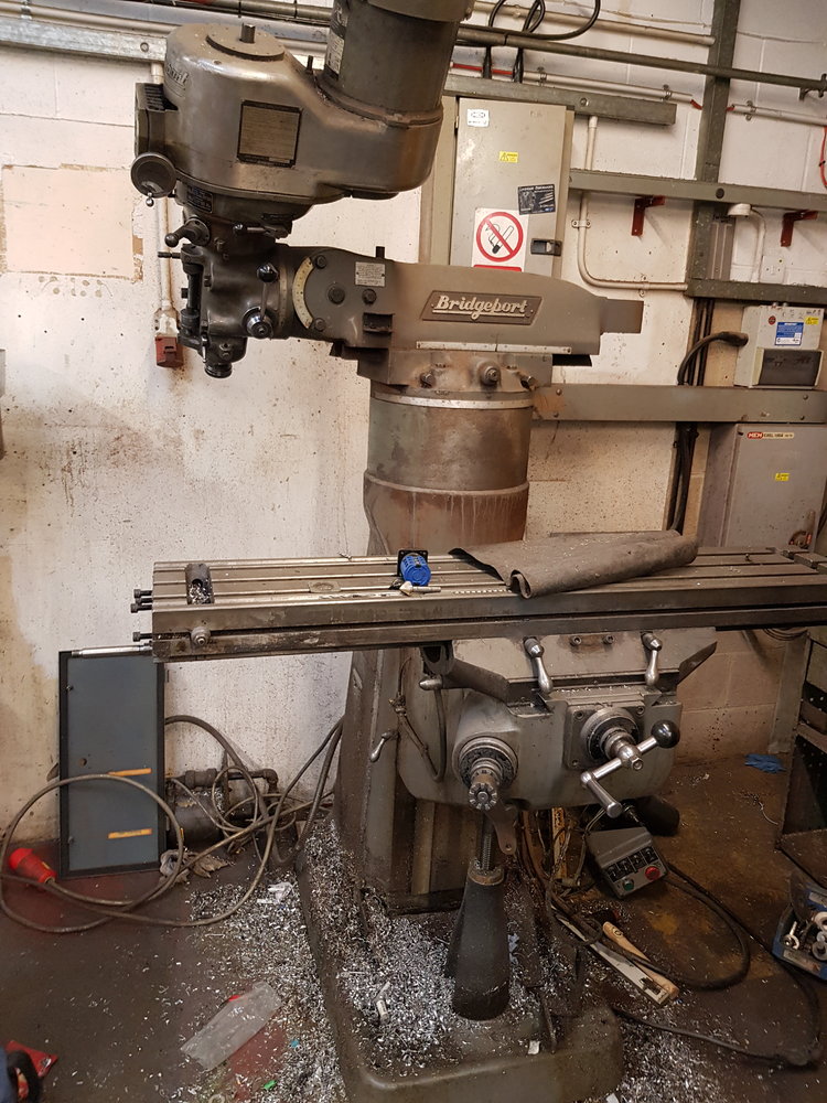

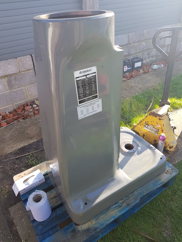

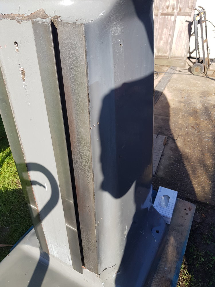

started stripping it today and so far a few issues but nothing too bad I think
I wont be using the tray so removed that

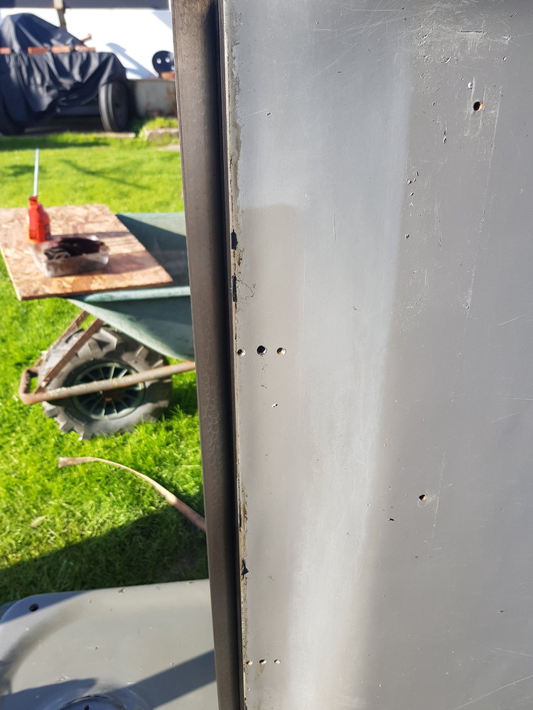

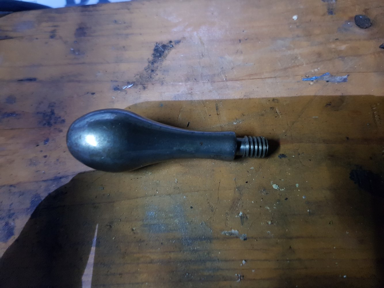

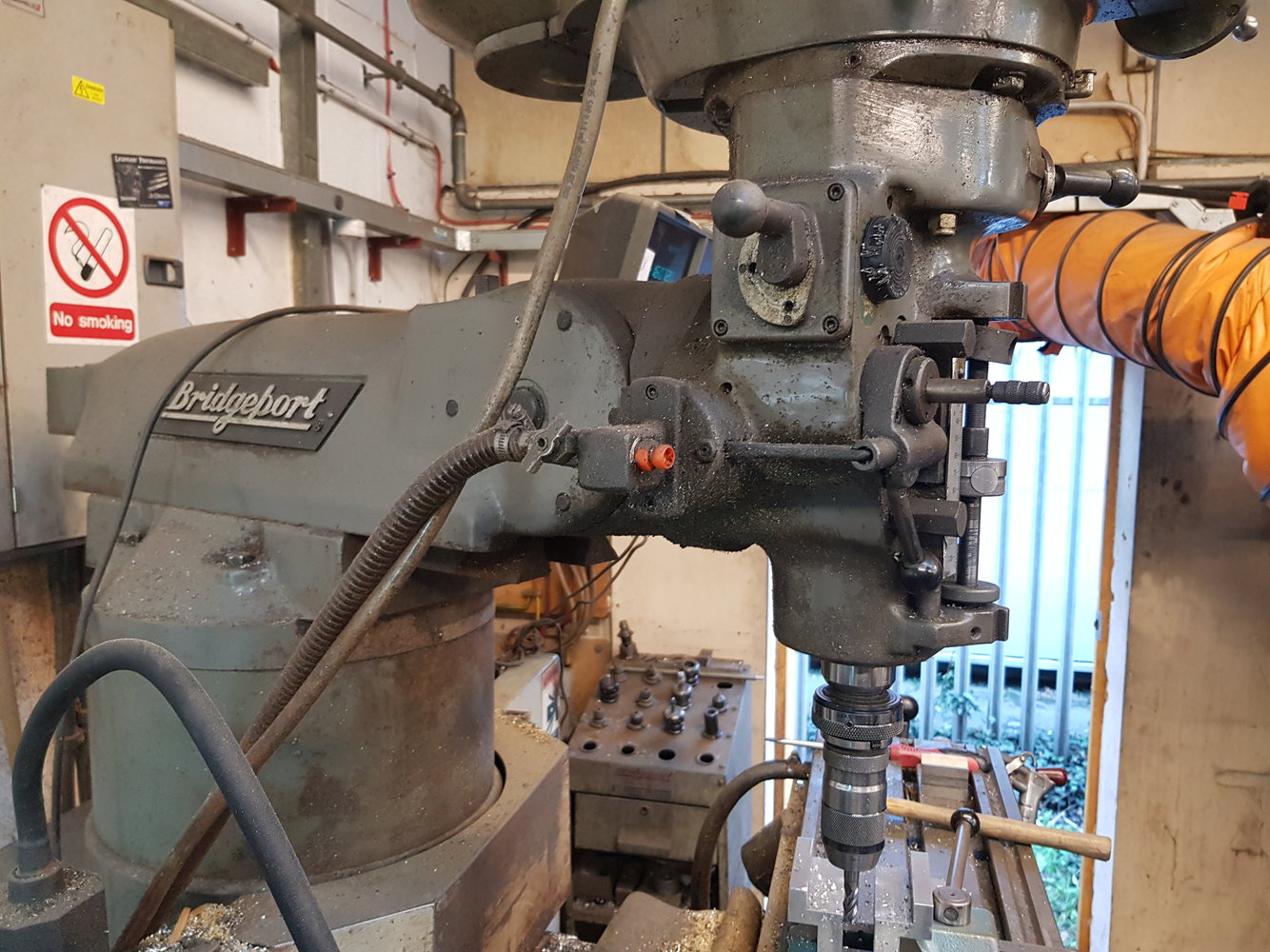

Also removed the DRO , power cabinet , feed handles and power feed

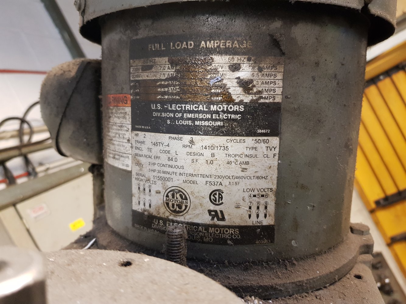

checked the motor and thank god appears to be 3ph 240v compatible

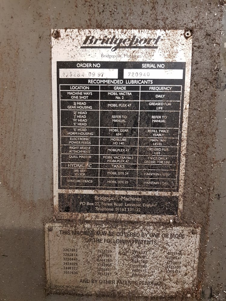

serial number indicates it may have been made in 1997 but further checks needed

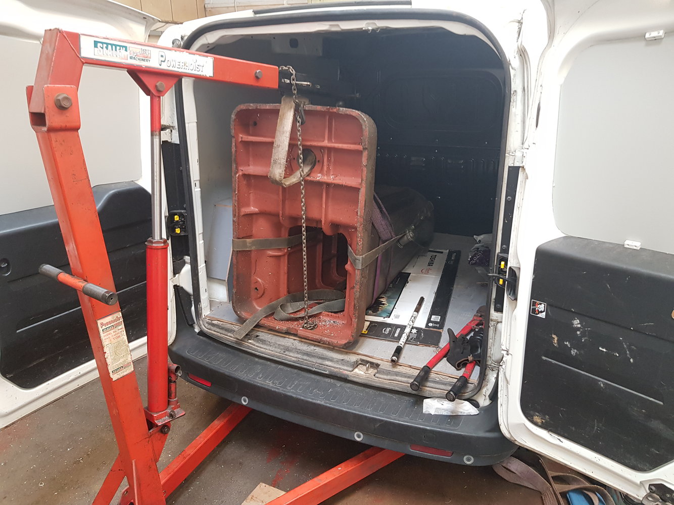

Ive got a friend who has a trailer with a Hiab but im thinking I can strip it down a lot more and most will go in my van as hes only avaliable in 2 weeks time and im worrried the unit will get broken into now its vacant View attachment 443292 View attachment 443293
