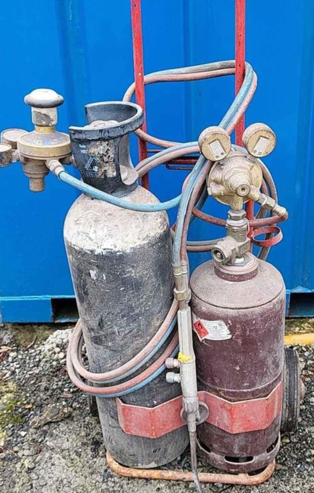

Seen this for sale about an hour away for £40. It may be sold before I can get there tomorrow but does this look like something that could be refilled or a potential waste of time? Seller gave zero details on if there is any gas in it etc
look like boc portapack, dont bother you wont be able to get them filled without a contract the gear hasnt even got flashback arestors on niether . a time bomb
Definitely can't get the bottles refilled, the regs are almost certainly out of date, and I wouldn't be surprised if the hoses have gone stiff and began to crack.
I'd go to take a look you might discover the bottle still have enough gas to justify the cost
Plus the cart and the torch,I wouldn't bother much about the other stuff
