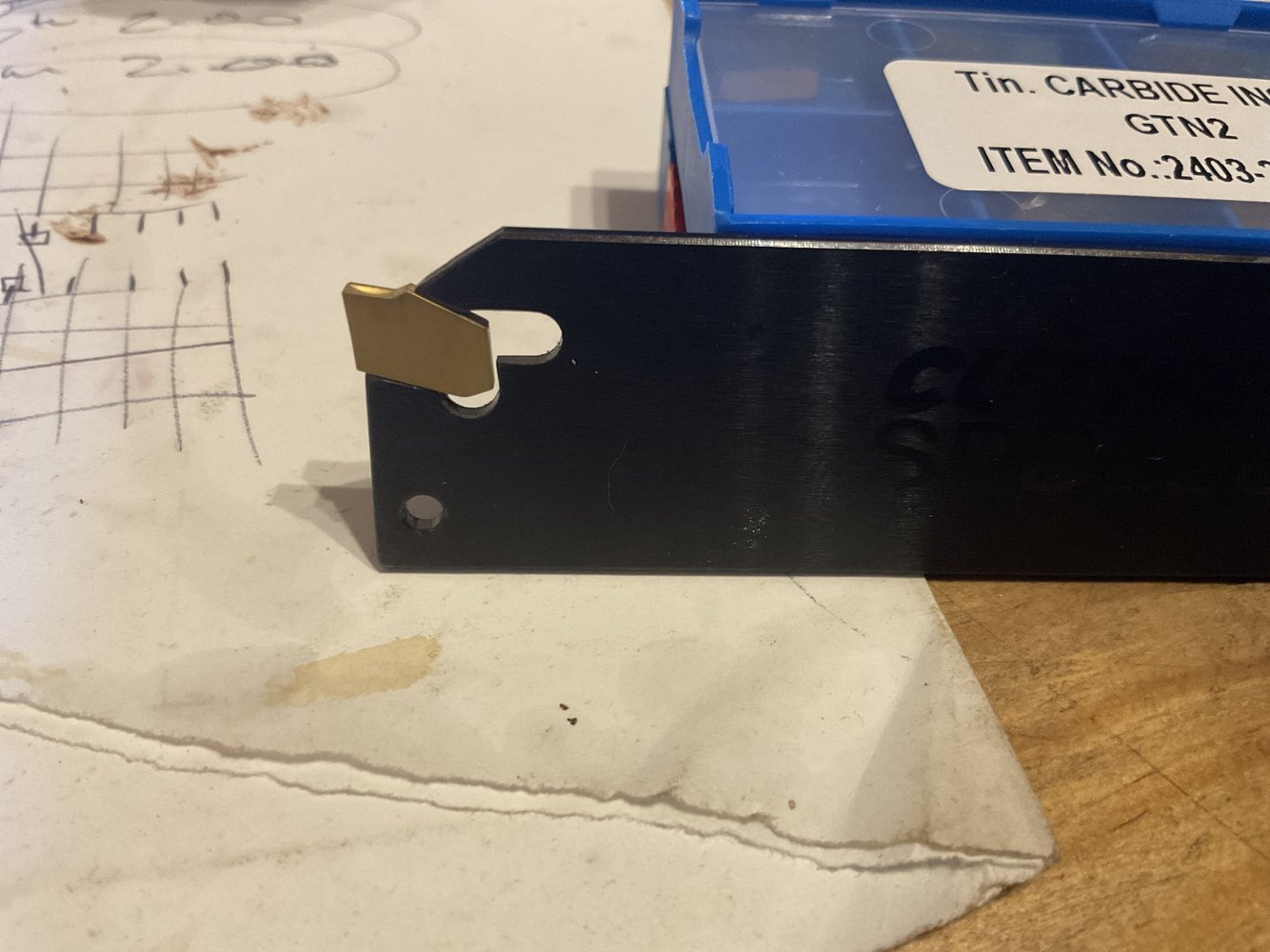

I bought this new Cutwel parting tool - as you can see, the code on it matches what’s on the box underneath, which also states SP200 inserts.
The Korloy SP200 inserts don’t fit, however. They’re completely loose in the jaws. What went wrong?
