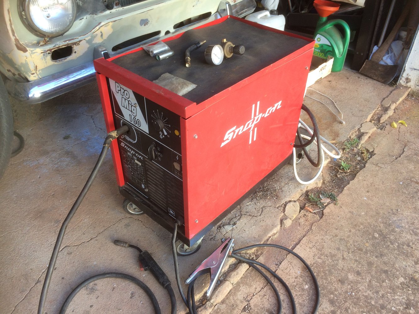

I recently collected a tidy Snap On 160 (rebadged Cerbora 838) with a known "low power" fault courtesy of a very nice gent @plewlandsbob

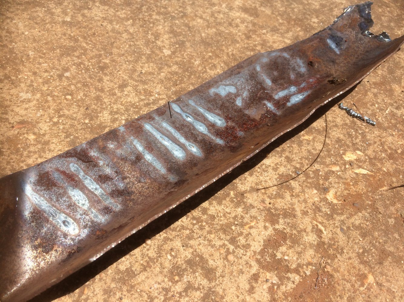

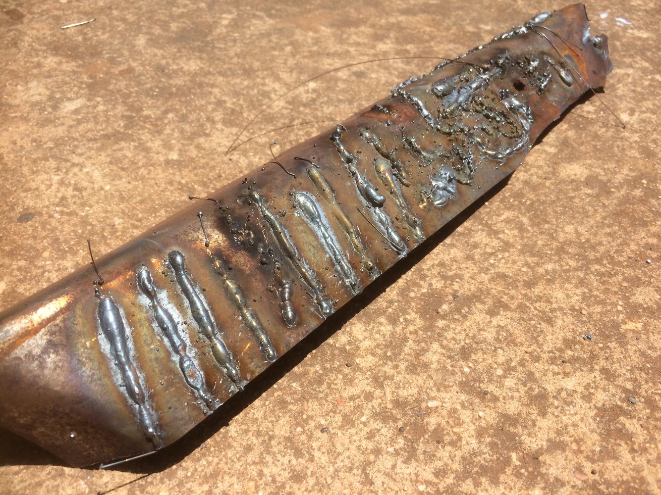

It works but the weld is very weak with a few very nice beads when it decides to work properly.
My next task is to find out why it keeps going into "very poorly" mode

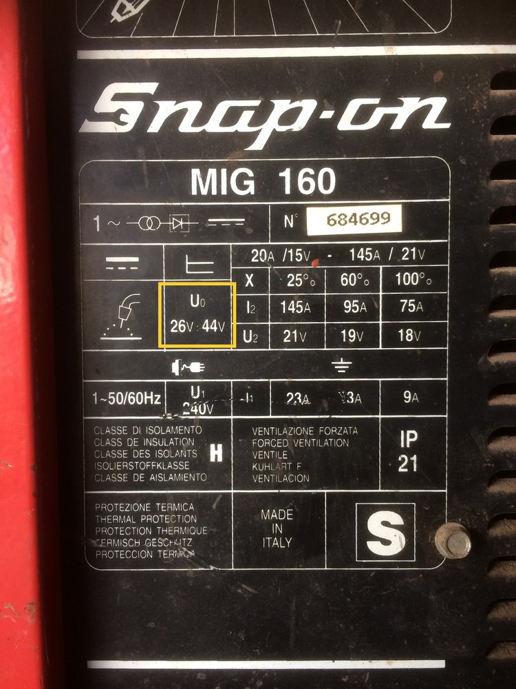

When I checked the voltages they are stable but a lot lower than expected.
Actual readings are 18v-29v but spec says they should be 29v-44v.
