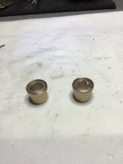

Dell Member Messages 202 Location Warwickshire Oct 19, 2023 #1 I have to turn up two new brass sight glasses for the Pultra 17/70 but unsure what to use for the glass part anyone got any suggestions it needs to be very thin.

brightspark Member Messages 39,345 Location yarm stockton on tees Oct 19, 2023 #2 plenty of places sell glass tube just google it .make them out of perspex tube plenty of that about as well

Dell Member Messages 202 Location Warwickshire Oct 24, 2023 #3 brightspark said: plenty of places sell glass tube just google it .make them out of perspex tube plenty of that about as well Click to expand... I ended up using watch glasses, even found the correct size. Dell
