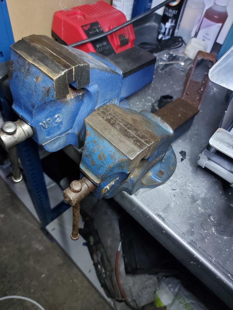

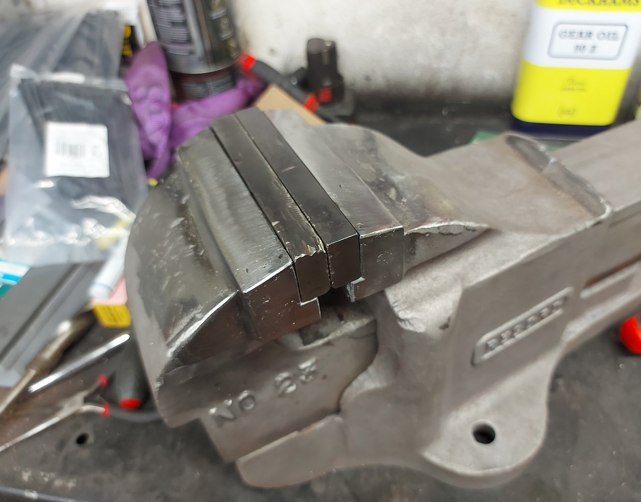

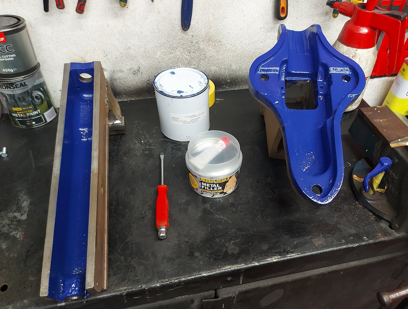

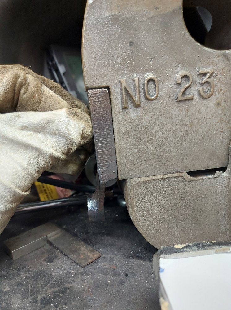

Which is why I'll keep it aside with this vice.It's got age related character, and it's original.

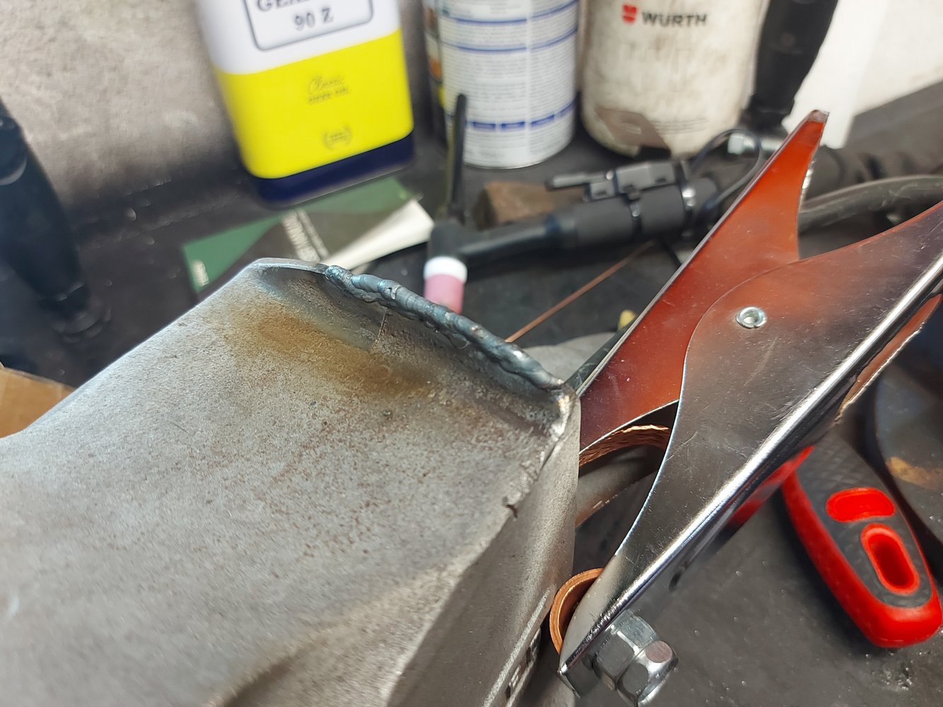

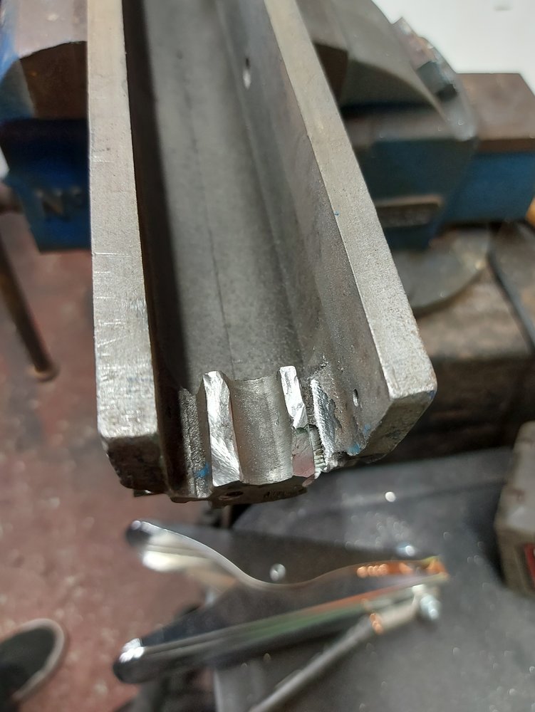

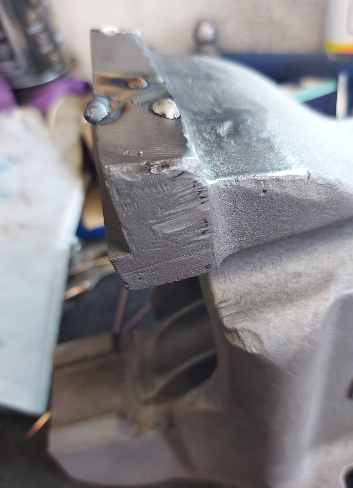

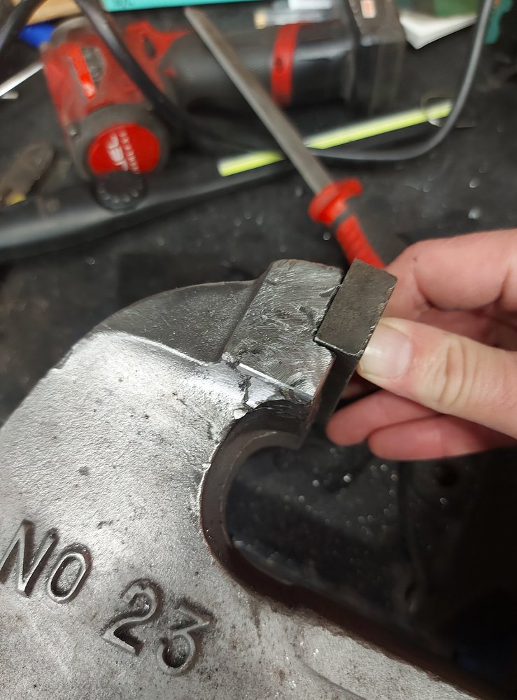

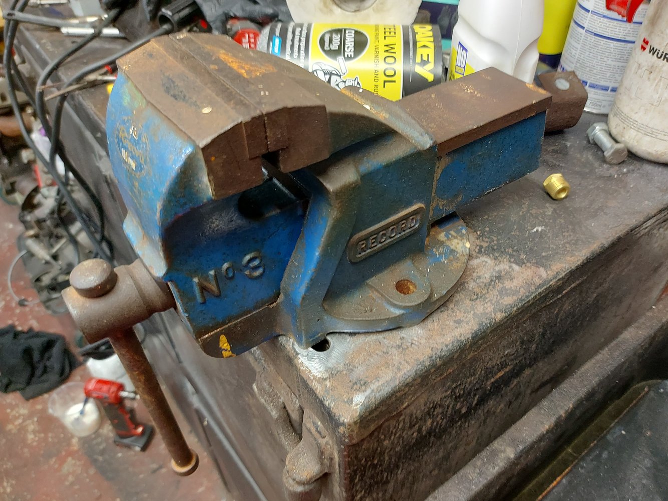

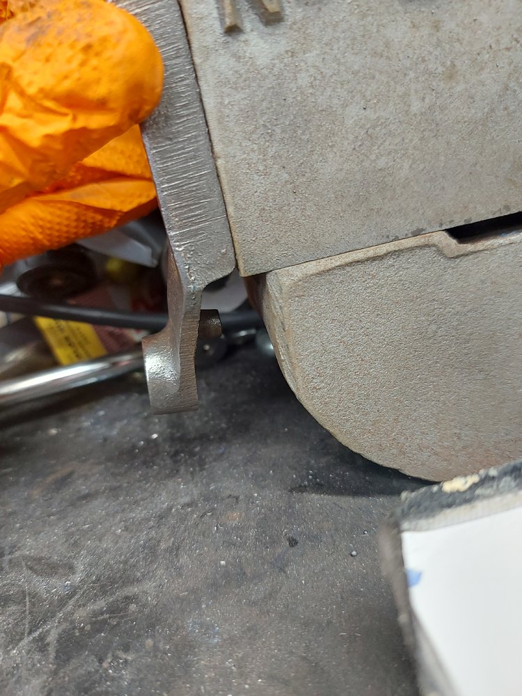

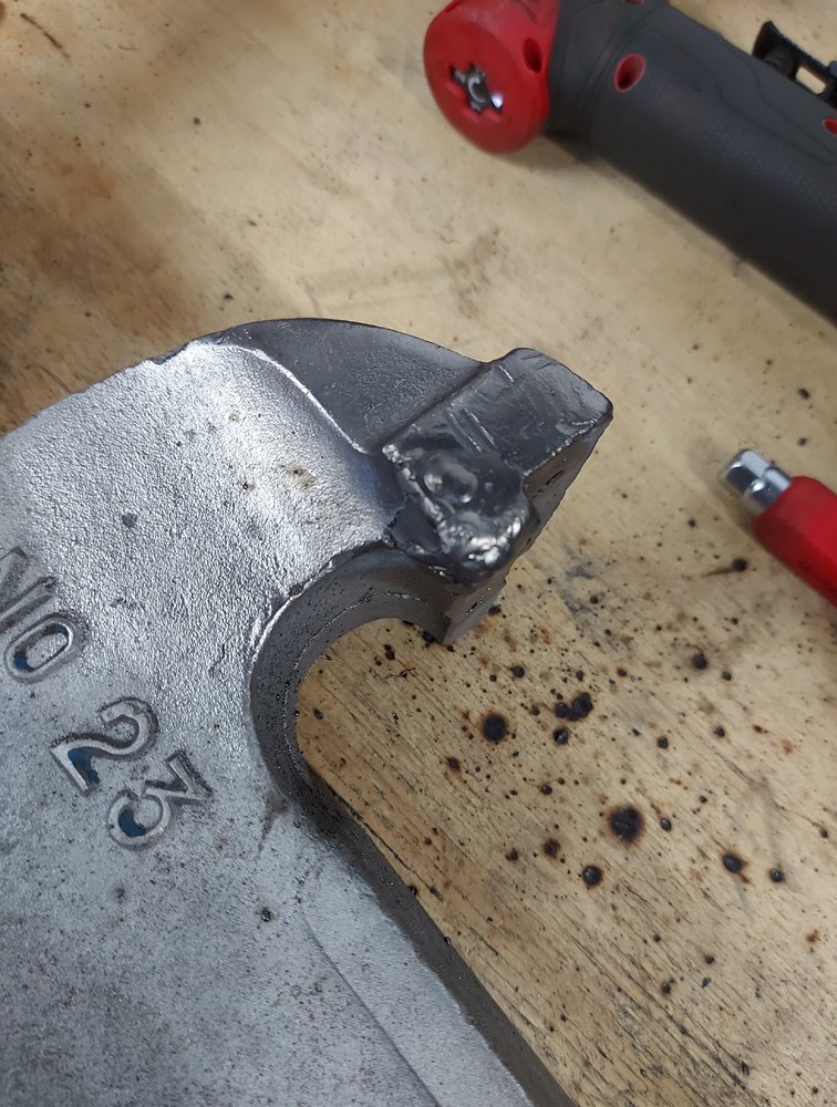

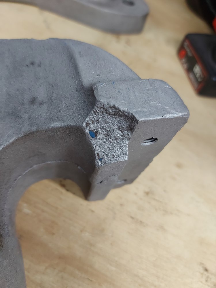

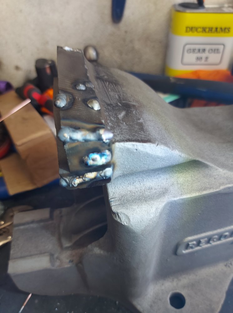

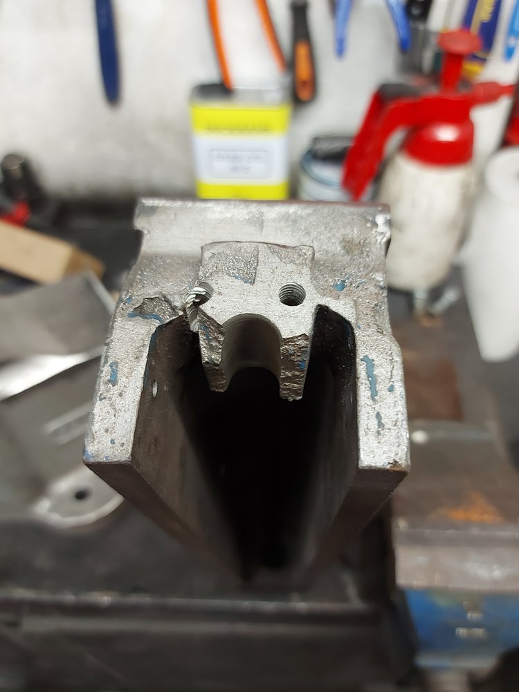

You're lucky. The entire register lip on my 23 is missing.There was a chunk missing from the edge of this No 23. It was quite a large bit missing doesn't look like it in photo but it was.

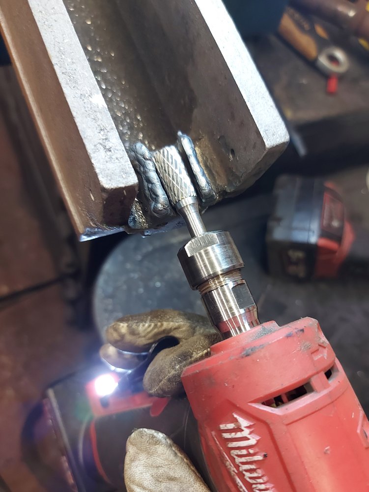

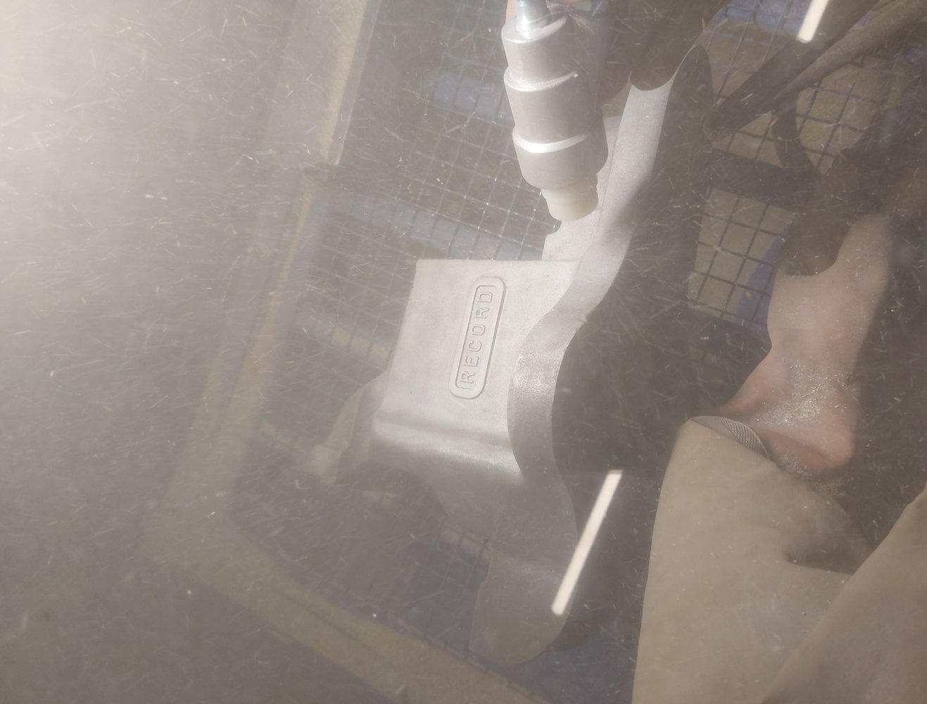

I tried 2mm arc welding rods and they worked just fine on it. I was careful to clean the metal and welds thoroughly as I went and built it back up.

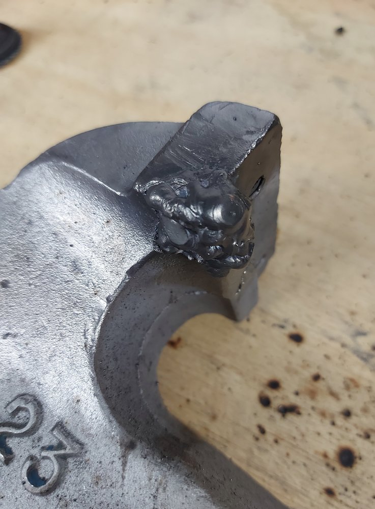

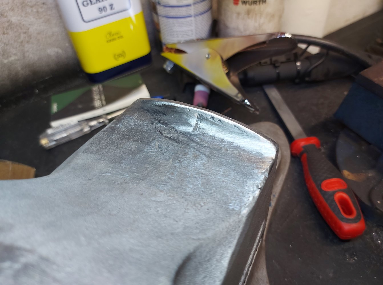

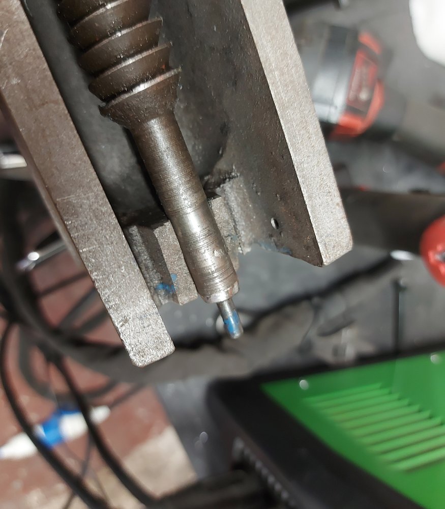

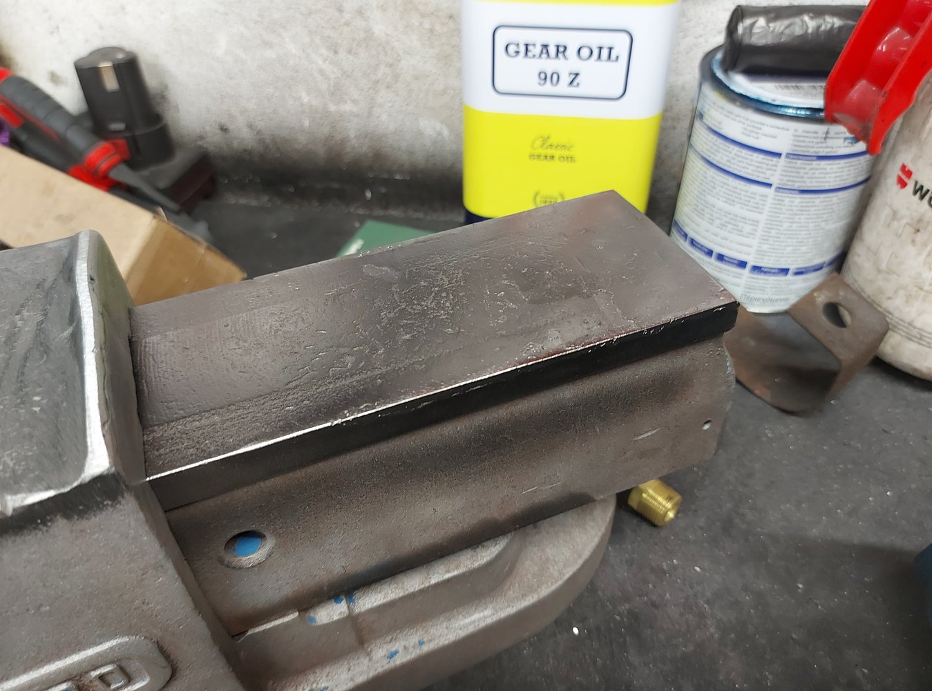

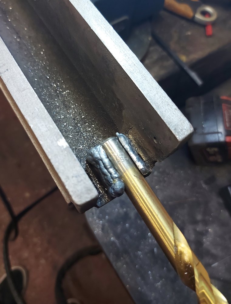

First main build up

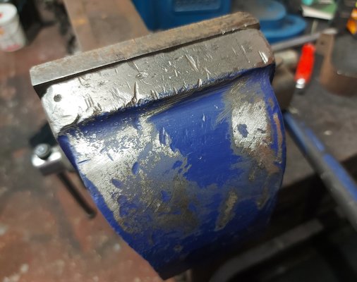

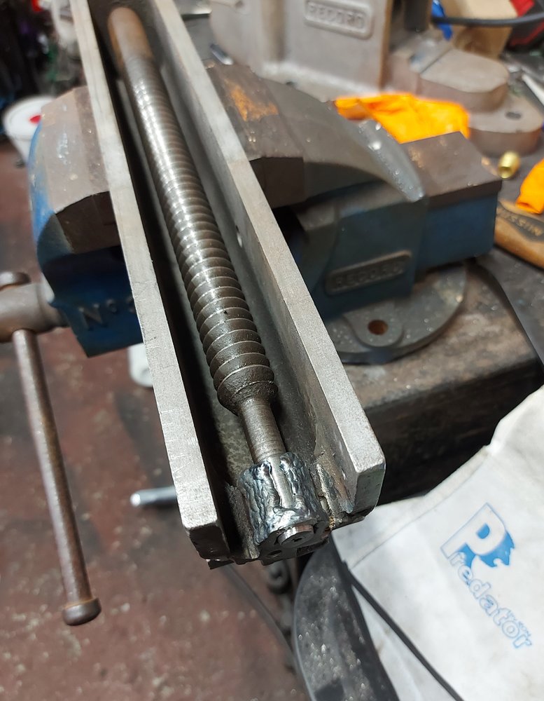

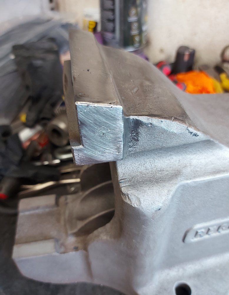

A flap disc back and fill up more, shape coming back. I'll finish it in the morning.

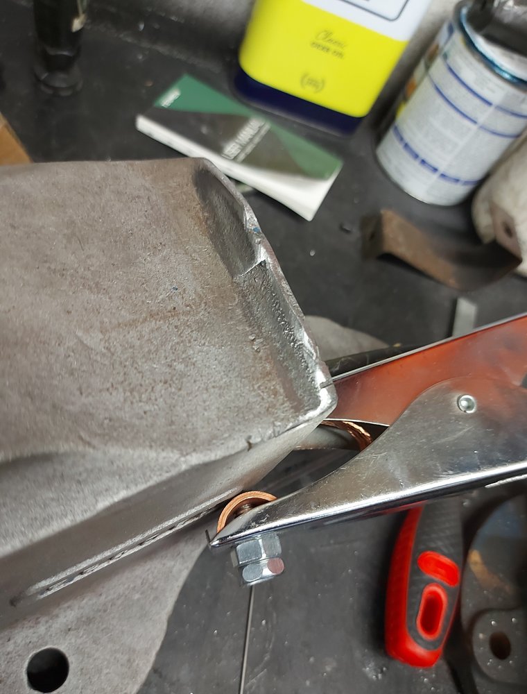

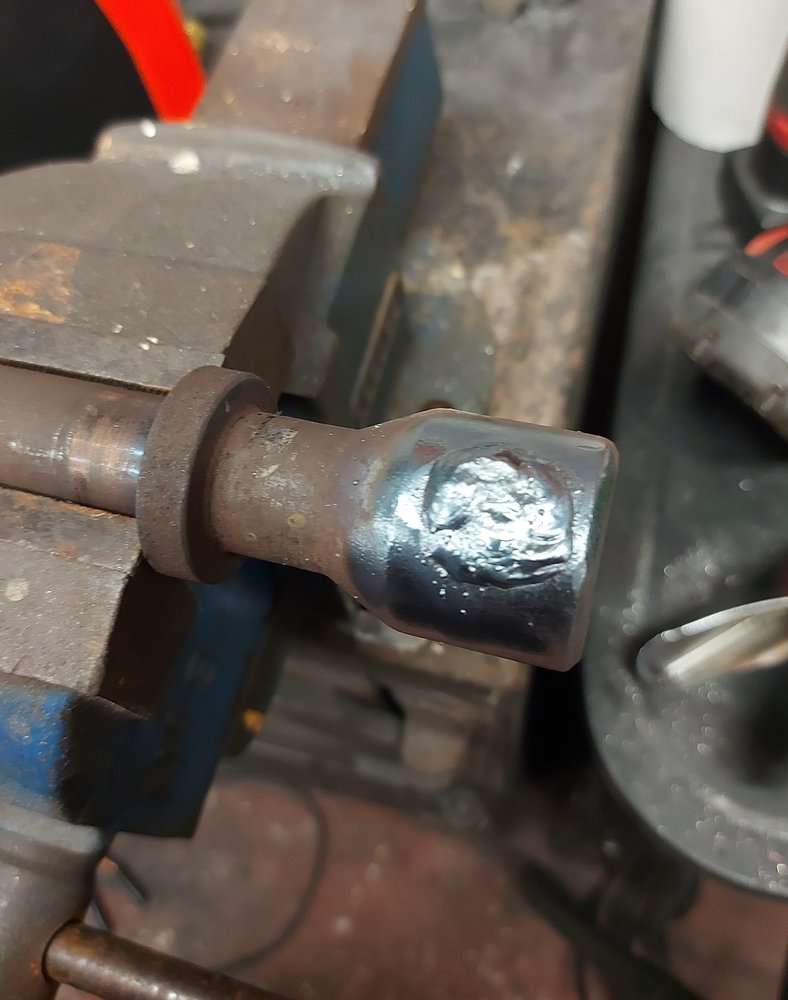

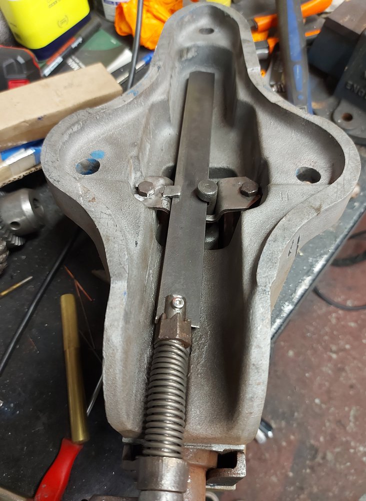

Allowing it to cool as slow as I can

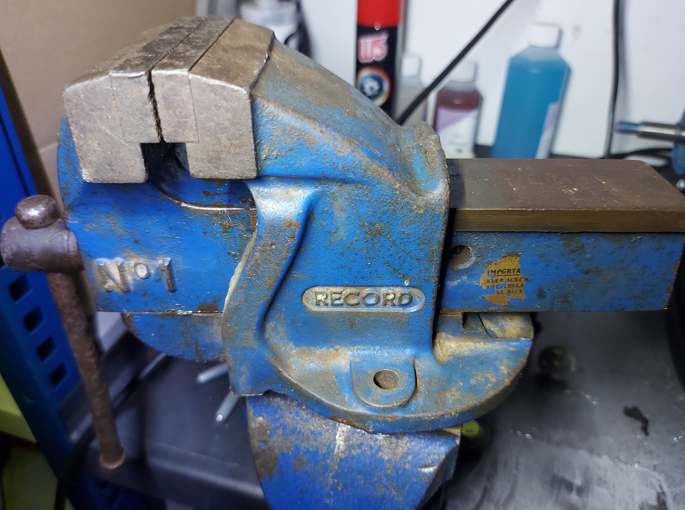

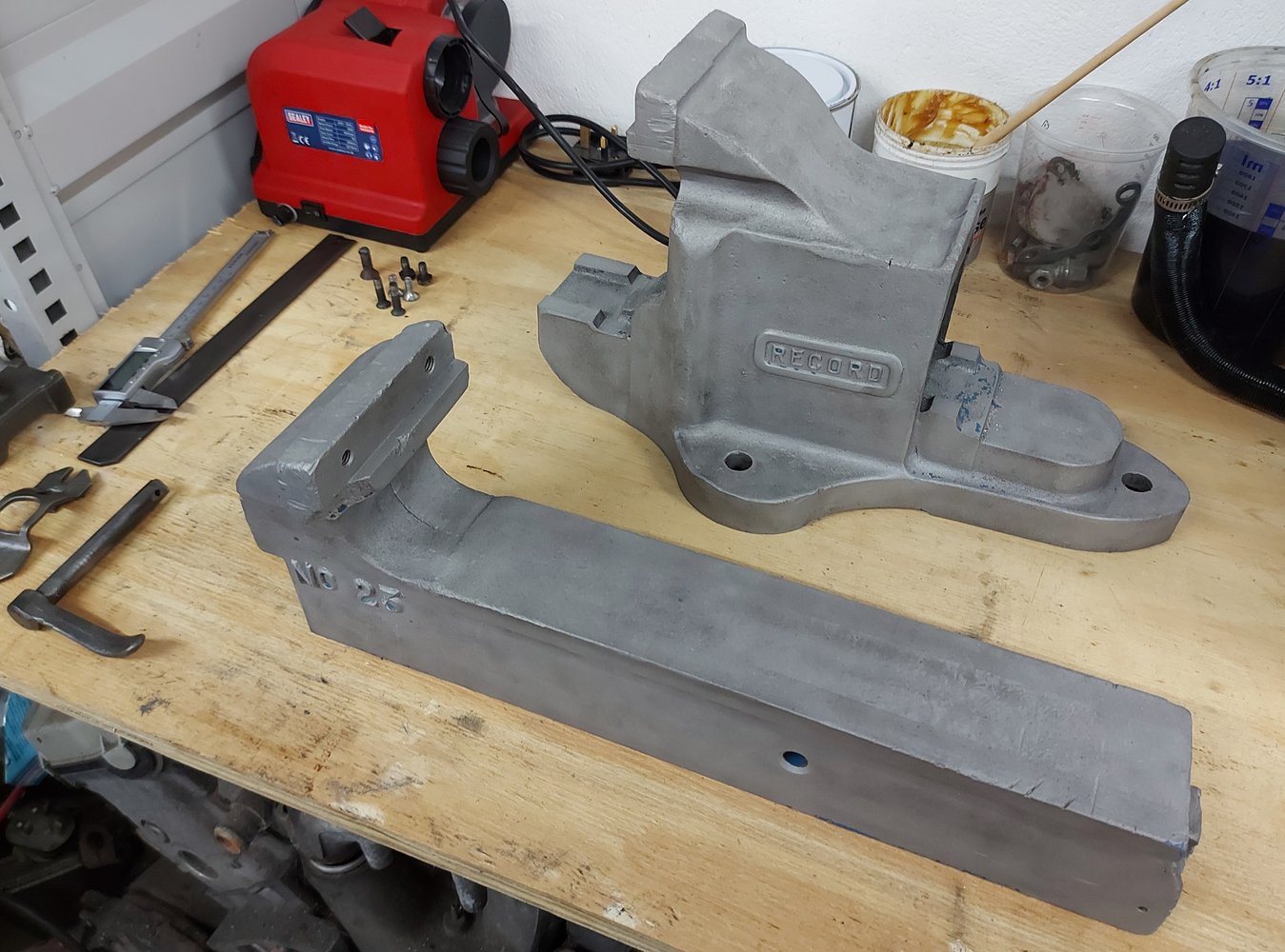

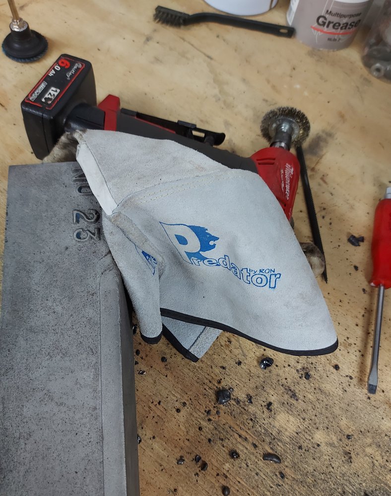

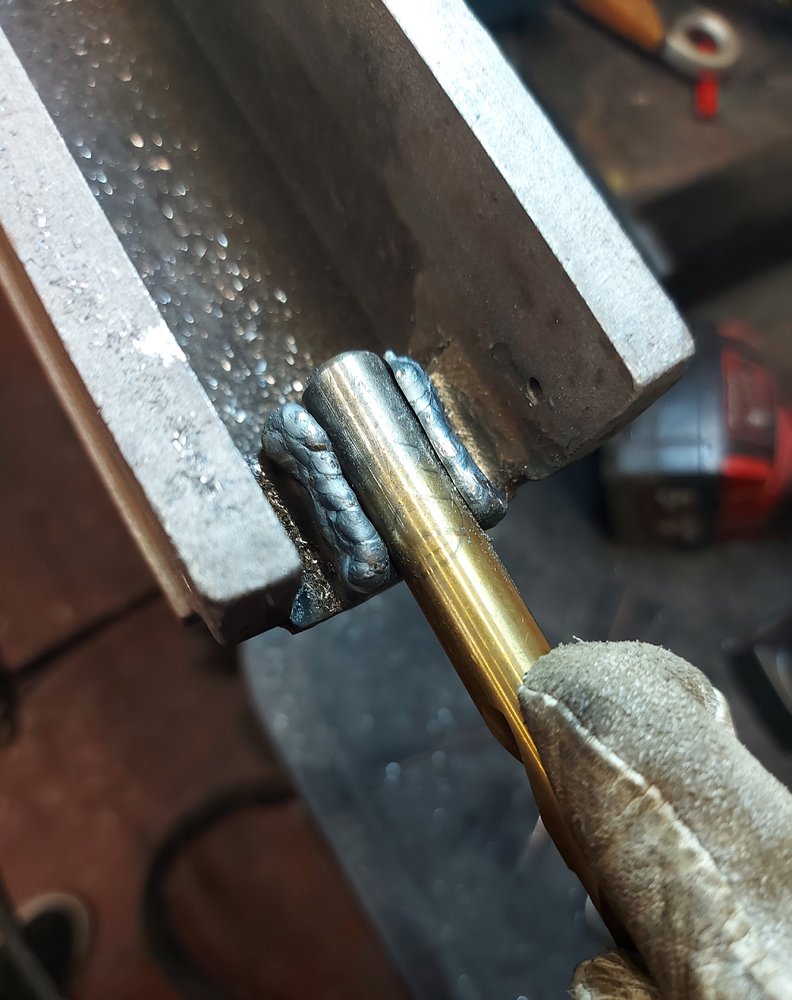

I am now contemplating welding a repair section under the vice to permanently fix a past repair.
