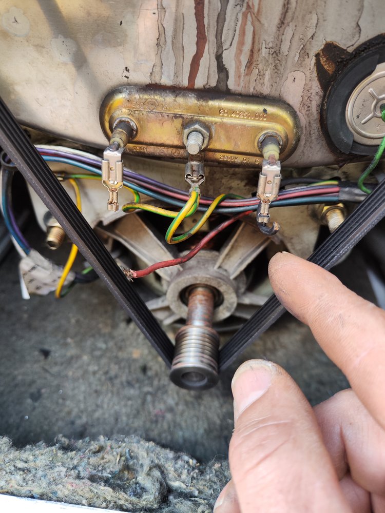

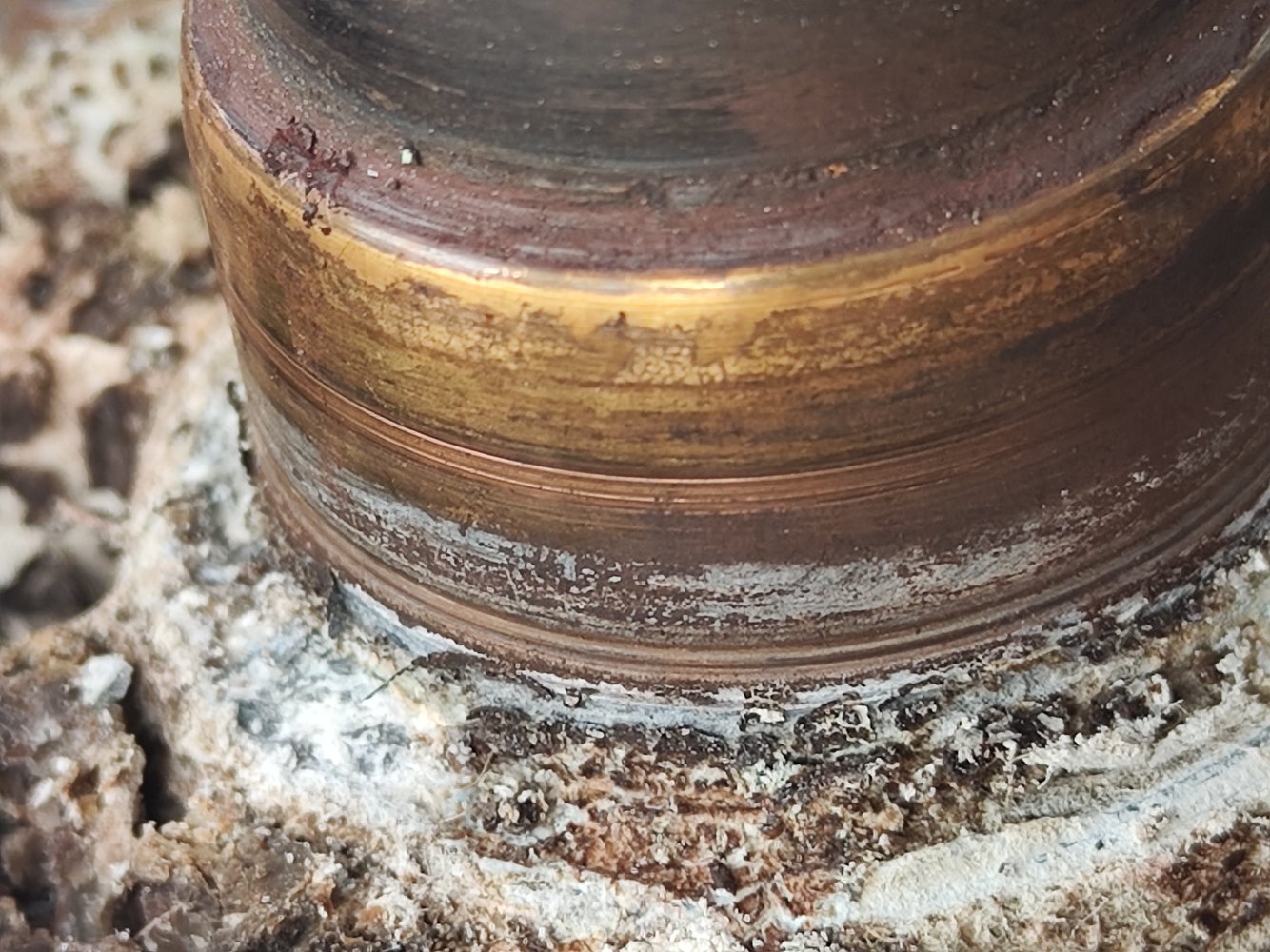

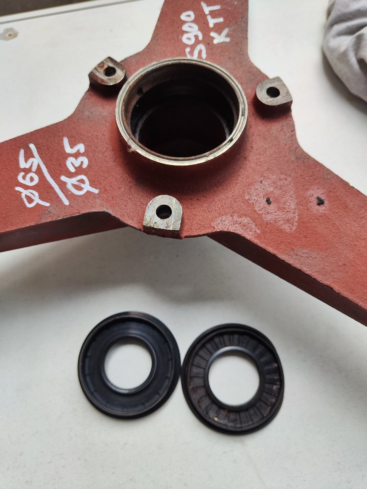

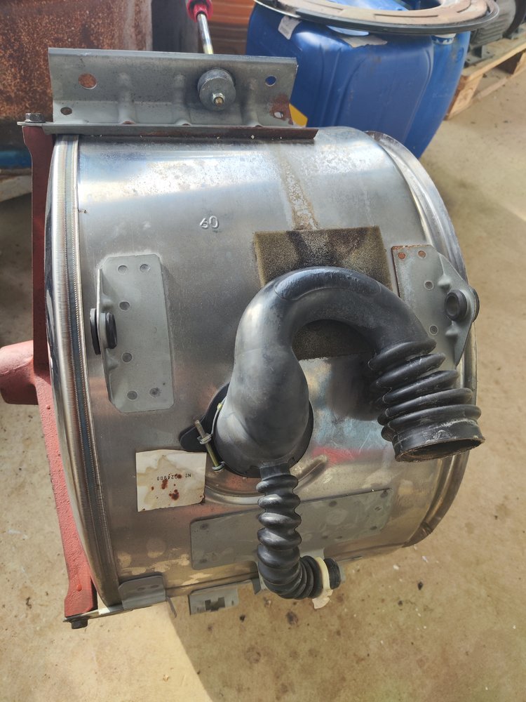

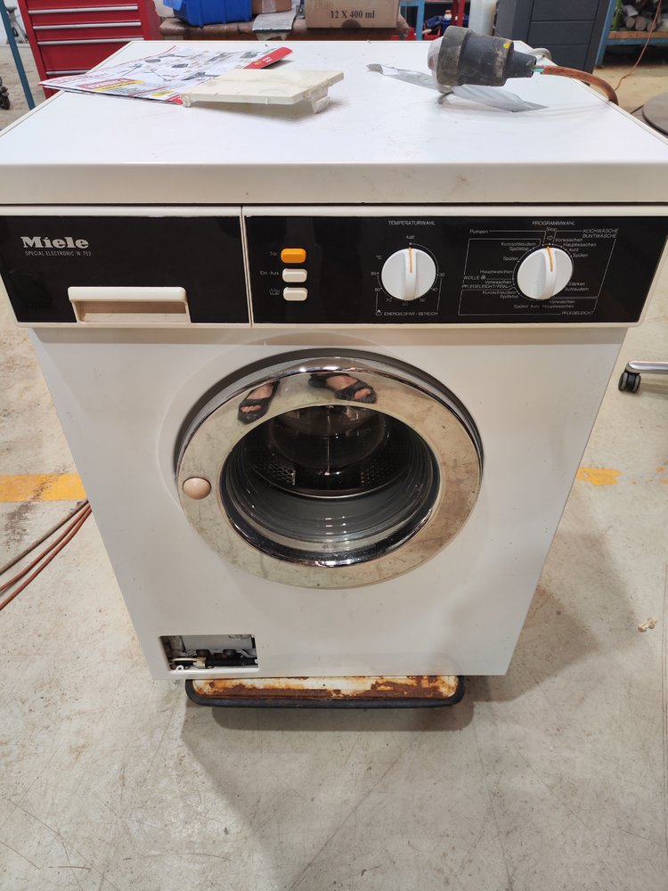

Bearings have been purchased. The oil seal, judging by the dimensions 35*65*12, is suitable from Samsung for 7 euros (OEM 36 euro). A bronze sleeve (blank) was found quite by accident in an old broken tool cabinet (from the set attached to the lathe), a week before purchasing the washing machine. To cut off the old sleeve, to do this you will have to remove the gap from the lathe or remove it by carefully cutting the angle, then grind a new sleeve, polish it, press it onto the shaft using an anaerobic retainer. Restore broken contacts of the heating element. Wash all parts. Wash electromechanical contacts with a special spray. Paint the body white in a couple of places. I did this kind of renovation about 10 years ago. All the difficulties are to understand what to unscrew first and what to unscrew last.Thanks for the photos of your beautiful home scenery.
I’ll be interested to see how you progress with the repair of your new washing machine…..there’s a sentence that I never thought I’d catch myself using.
