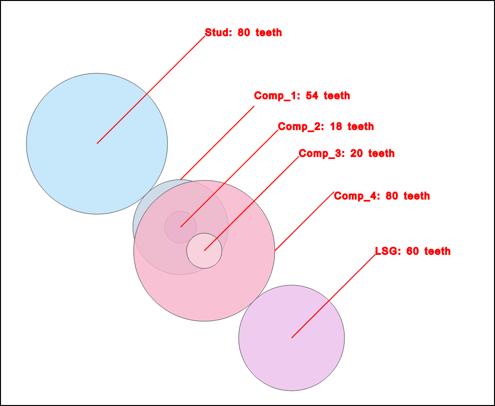

The very small selection of gears I have are,
16
52
54 2 off
54 with 18
56
60
80 2 off
80 with 20,
Pete thankyou for your kind offer, please dont feel obliged, I did not intend to have anyone making one for me, but if you have the time that would be great, I'll obviously cover any costs and time.
If one of the option above are okay I am happy to go with one of these,
Thanks Chris
