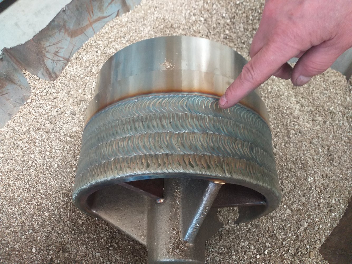

Fired into it a bit yesterday, and will continue to do so today ( if I don't fire up the Beeza instead ).
Main problem at the moment seems to be either too high a bead, or dilution with the molten steel from the base.
Detailed in the Stellite operators guide, and the cure is likely to be a bit of amperage tweaking, but it's a rather useful thing to be able to do, if it can be got to be a functional skill....
