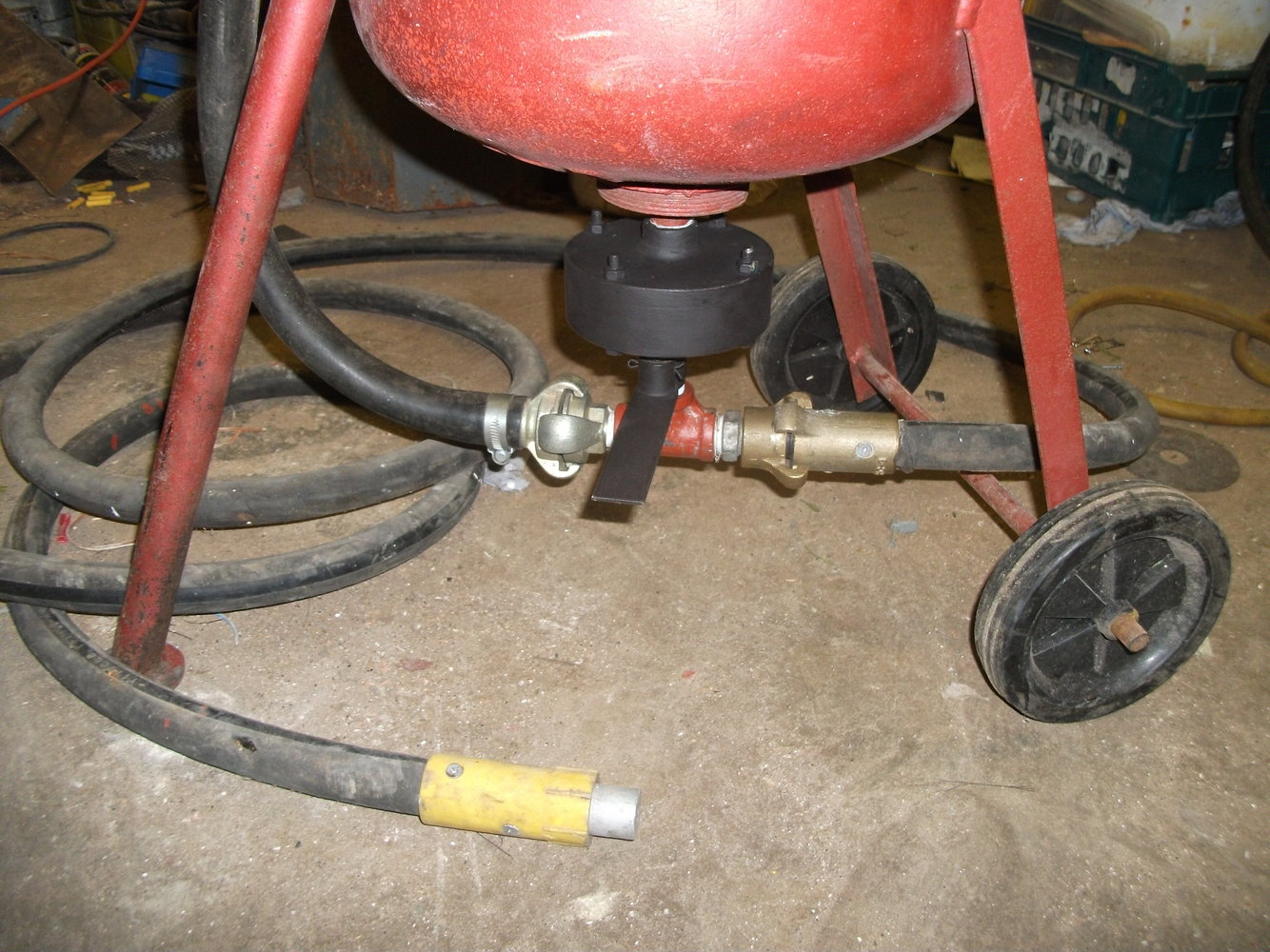

my twin comp can run the 3.omm jet no problems at 100 psi and above pressure. roughly about 28cfm
dropping the pressure ratio air to media makes it use a lot more media and hardly any cutting power and a bit unreliable you can drop the pressure a bit and just hold the jet a bit further away from the article being blasted seems pointless though if your using less agressive mediayep - it was more that i was hazy about when anyone would "want" to use lower pressure? I looked up "walnut shell" and was still getting told 100 psi...

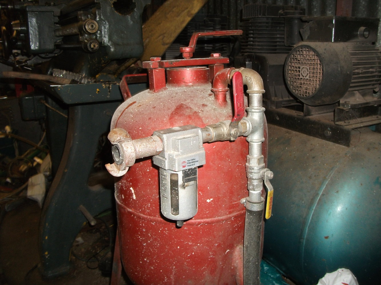

its no big deal not having the deadman if your working close to the pot .just use of the main airline ball valve on the pot ive managed without one for 45 years and blasted my house car wheels motorbike frames and stacks of of other stuffSadly, I've not made further progress with this.
I'd arranged with Bond to acquire the hose and deadmans, but I think he has gone AWOL (which is absolutely fine, we had no contract) but I've been waiting / hoping that he would return before doing anything else.
I think I'm probably going to "hard wire" (link) the two ports on the control block that would have had the red and yellow, so the unit is "always on" and just stuck a bit of whatever hose I can find on the bottom and see what happens.
I want to clean up a landrover door frame for hot dip galvanizing and it's just another item in the way at present!
No problem, the home made pot I built, I used standard 3/4" rubber air hose for the sand hose.and just stuck a bit of whatever hose I can find on the bottom and see what happens.
