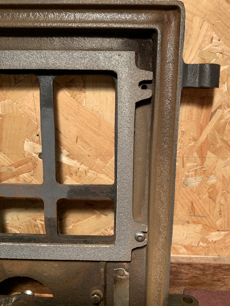

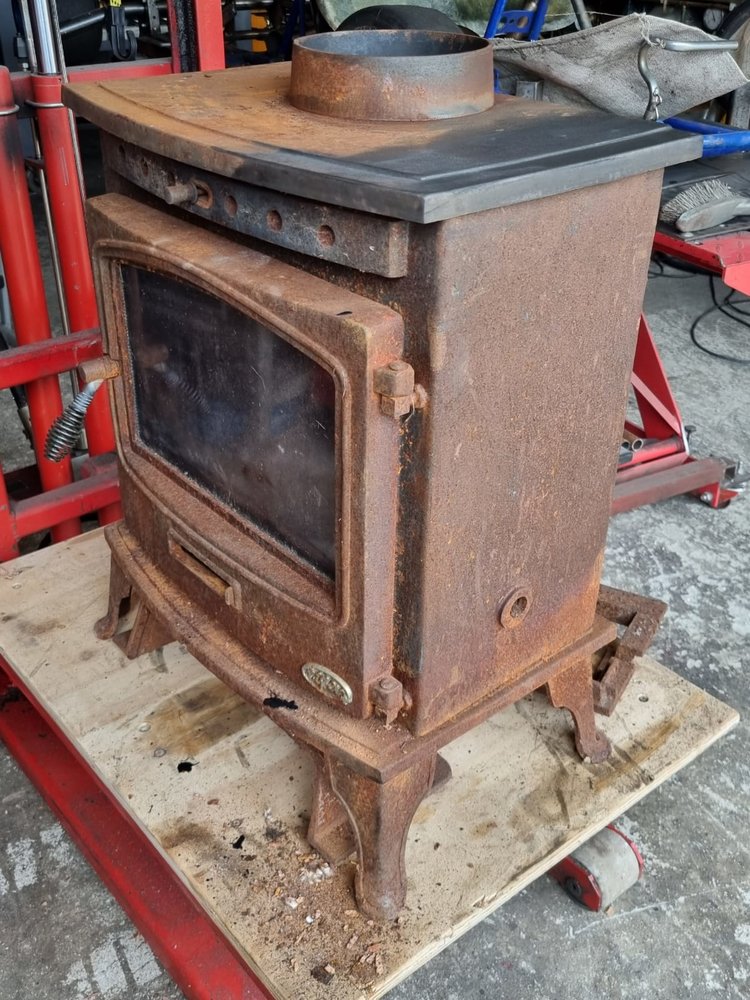

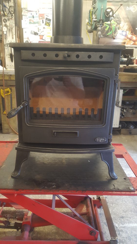

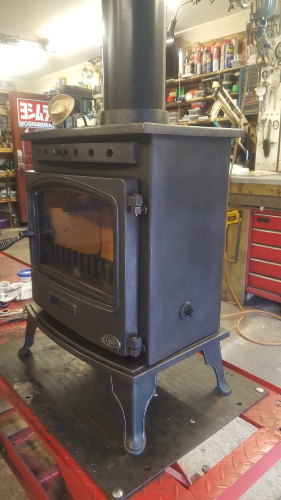

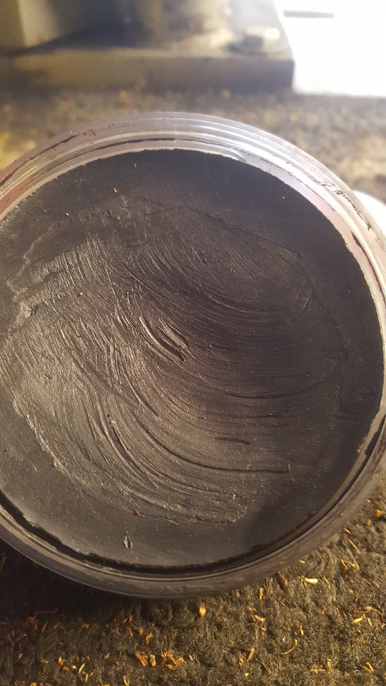

I was talking to the shop guy where i bought my bits about the Graphite powder and oil trick and he reached on the shelf and gave me a small tin of what i can only describe as jet black car wax..he said don't get it on your hands, i know why now great stuff and really brought it up well will post a pic up tomorrow of it.What did you use to black it in the end? It looks like graphite on the first picture but hard to tell with the light.
Here's a question - my daughter has a gas version of one of these - what's best to do with it? Somehow I don't see it selling for much?I was talking to the shop guy where i bought my bits about the Graphite powder and oil trick and he reached on the shelf and gave me a small tin of what i can only describe as jet black car wax..he said don't get it on your hands, i know why now great stuff and really brought it up well will post a pic up tomorrow of it.

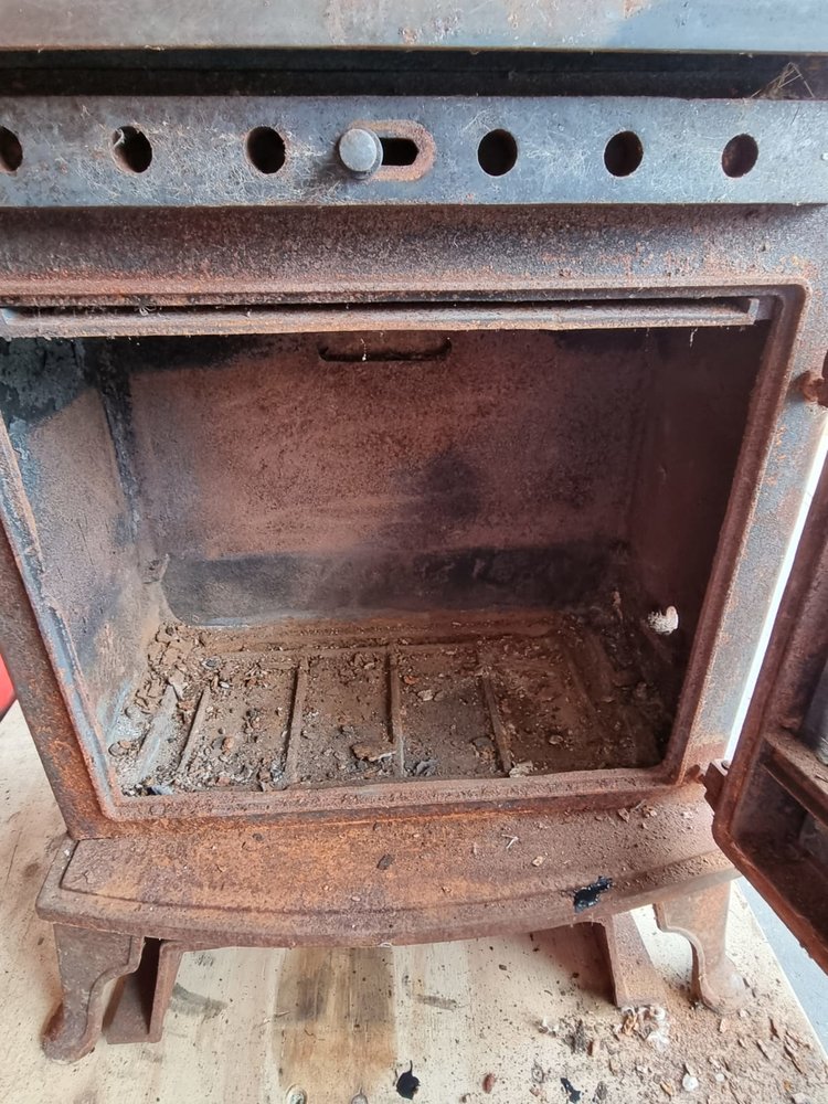

But the stuff your using is good for direct heat, flame/embers etc as in firepitsI make and sell fire pits.
We have tried everything. I mean everything you can easily get.
The only one that’s worth it is Mipatherm. Stove paint.
You need to read the instructions and cure it properly. Make a fire with cardboard first then after an hour or so gradually increase the temperature.
It’s about £40 a tin. Guy in Germany sells it to me. It’s cheaper that way.
Edit to your latest.
Stove black is like boot polish and goes on with a cloth. We tried that. It’s good but not idiot (public) proof at the curing stage
