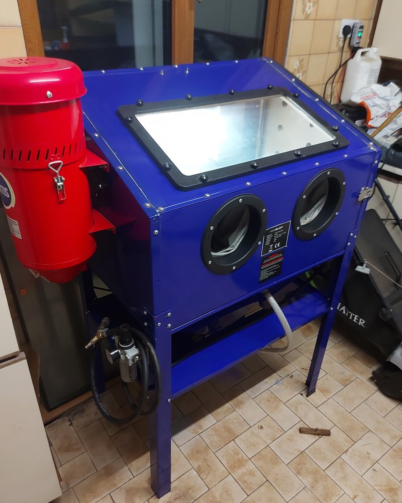

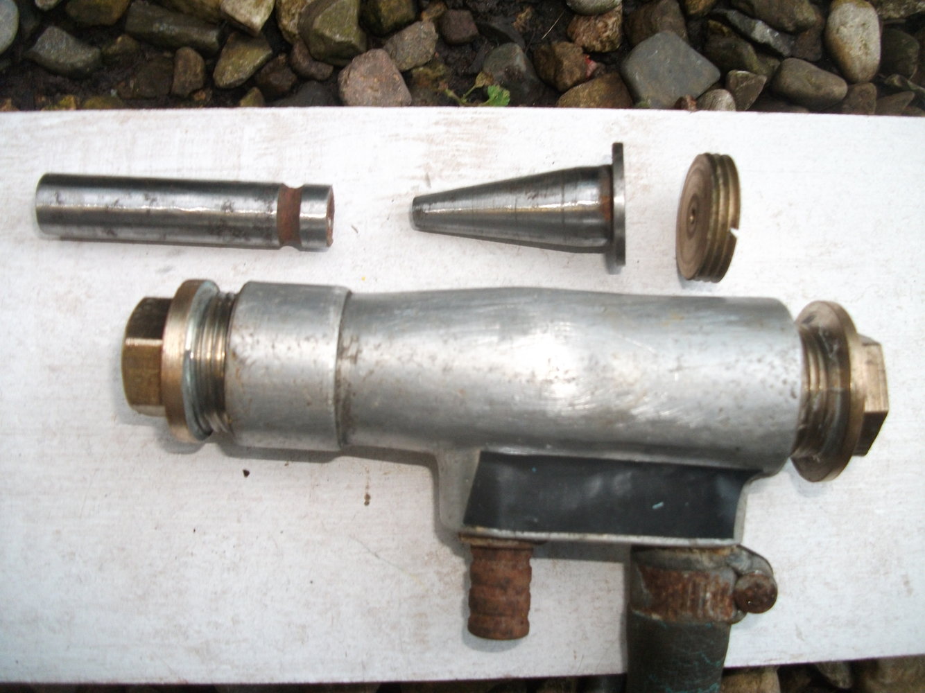

When I built my cabinet many years ago, I had used several other ones beforehand, and all had the foot pedaloky doky, going to need to nip back to the workshop and measure my nozzle size then as im pretty sure the one i use is smaller than 8mm? I notice the air inlet on this gun you have is much bigger than my current set up as well so maybe with the increased air going to the gun 8mm might be ok? im unsure TBH?
loose on the floor. After running one for a period of time, I like to switch feet, and on the loose pedal
you end up chasing it around.
So I got a valve, and made a bracket to hold it on the cabinet, made a treadle the full 4' width of the cabinet.
Much nicer to step anywhere, and not have it move around.
