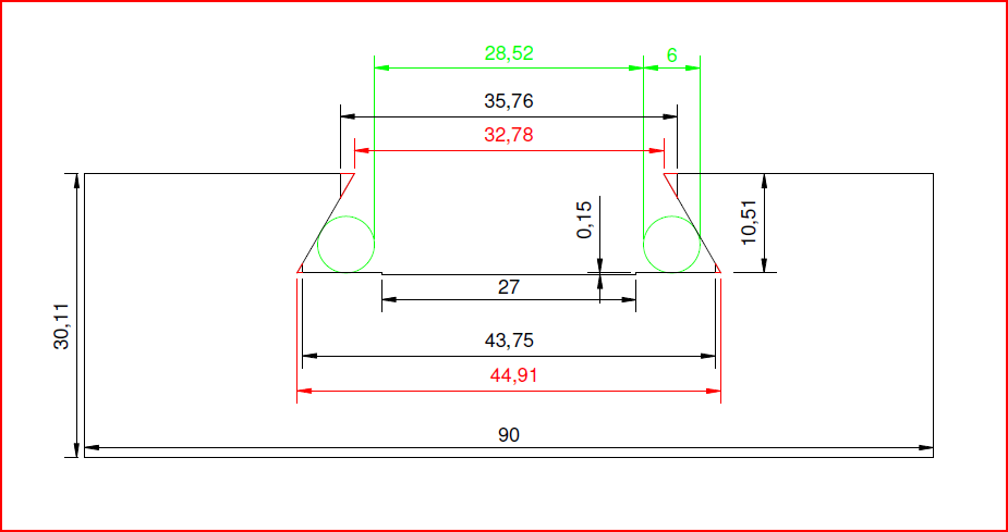

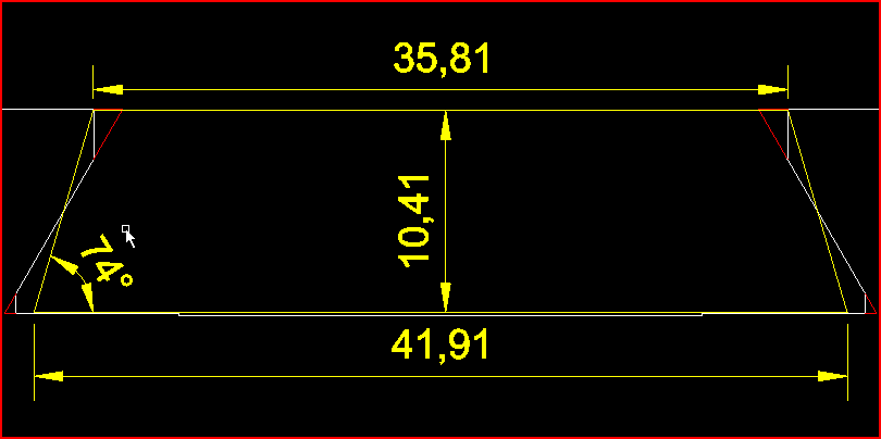

How did you get on?Aah right, I never took any notice of the numbers I just think of them as AXA and BXA size. I'll measure mine and compare with the sizes above.
Sorry mate I re read my post and I looked right arsey! There's no rush mate honestly don't put yourself outSorry got side-tracked by more important stuff last night. I got to measuring them but realised I'd have to draw them in cad to give dims because the narrow part of the vee is squared off. I'll do it now.
I'm going to, but I needed the dims to feed into my pet cnc button monkeyDammit I thought you were going to get some machined, was going to ask if I could tag some on the order![]()
It would be nice if someone had a wedge post they could measure across the vees with it fully closed and fully open to gauge the range then the holders could be made better to suit.
