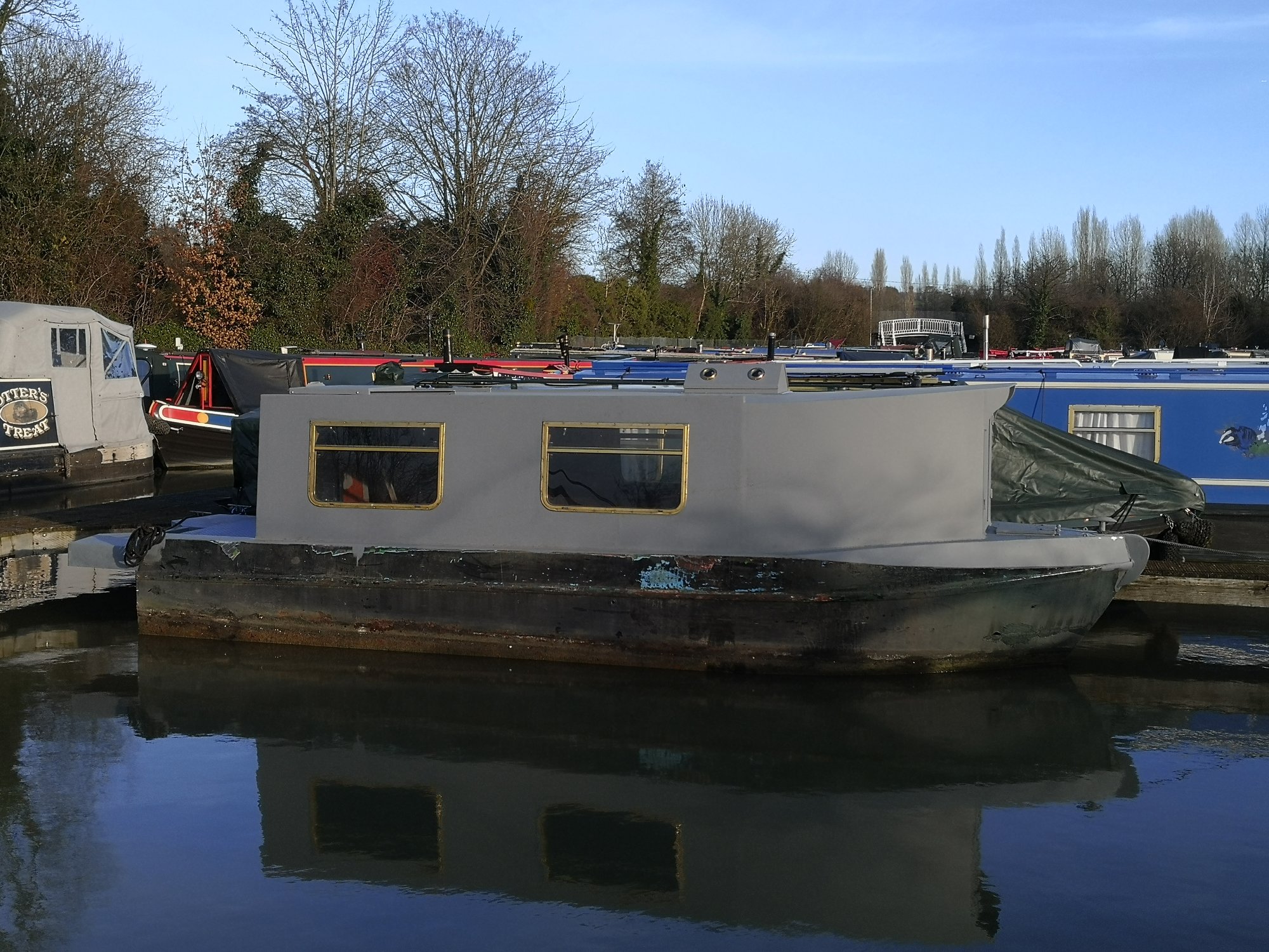

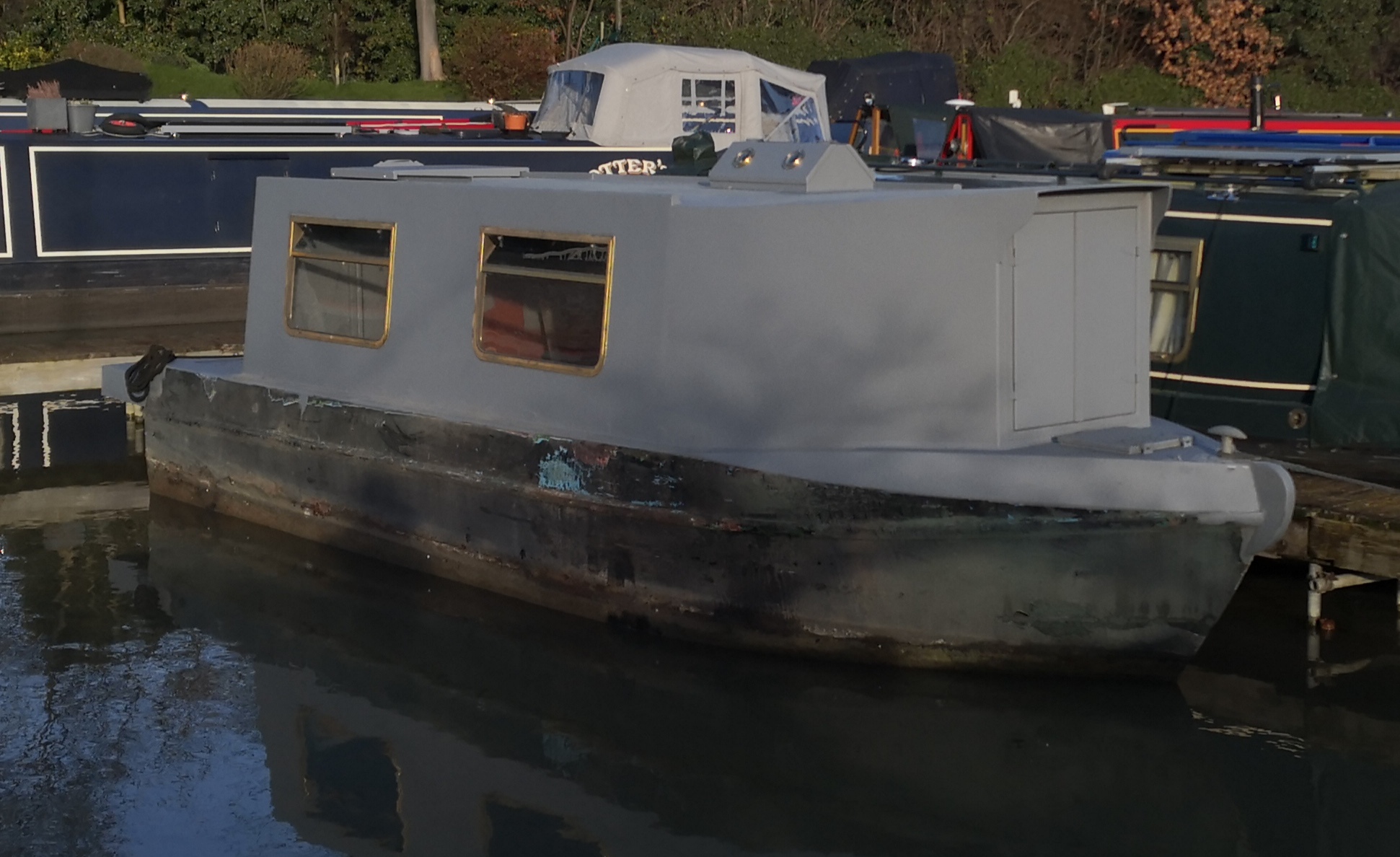

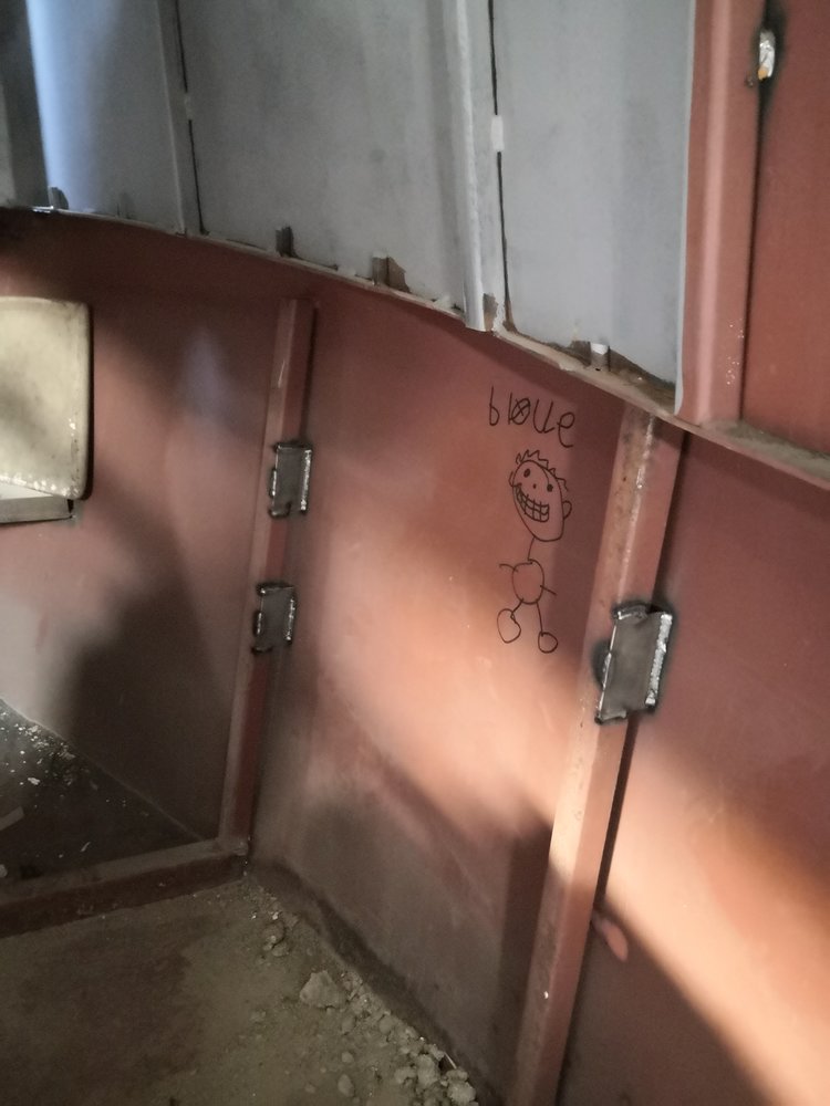

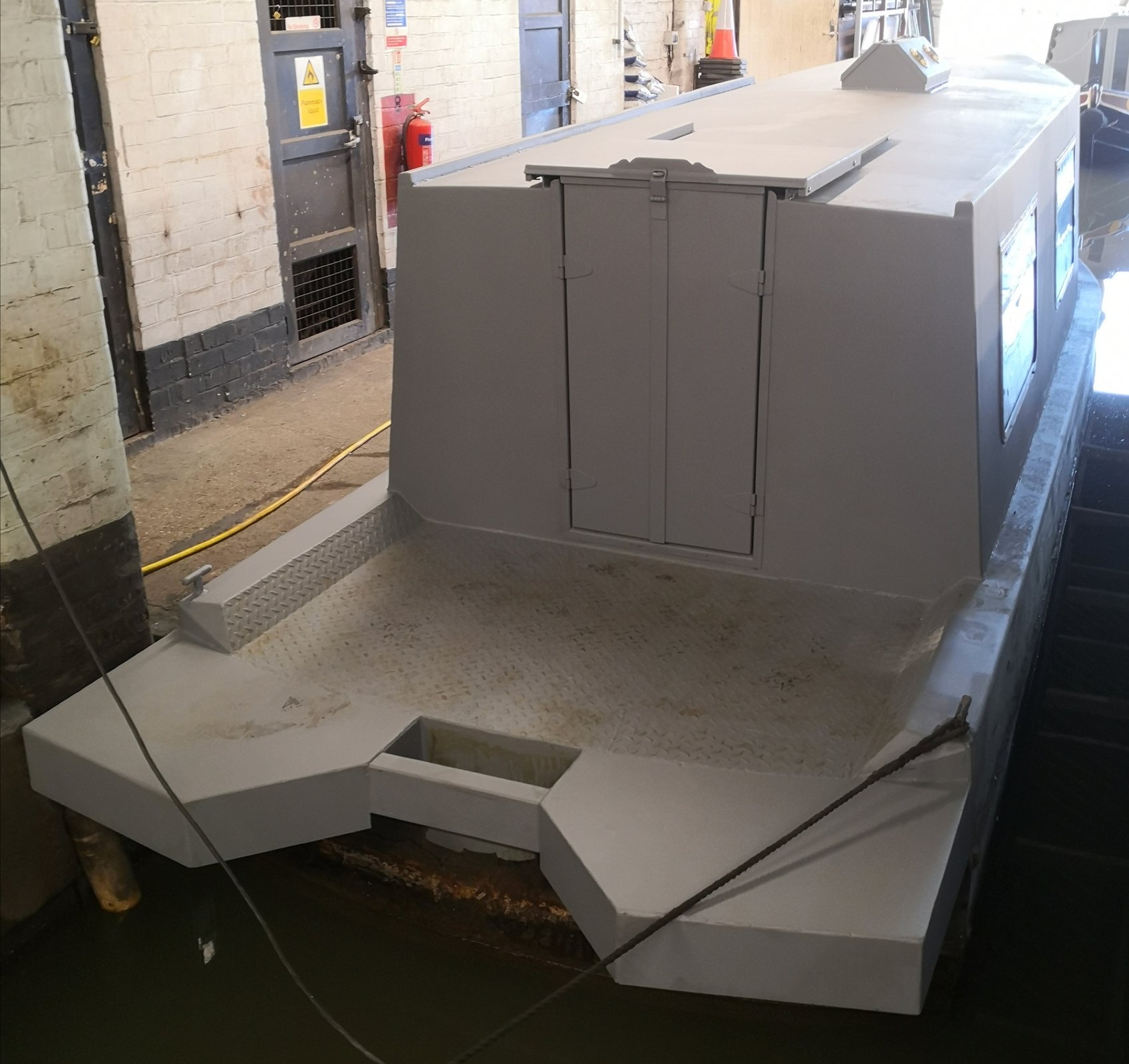

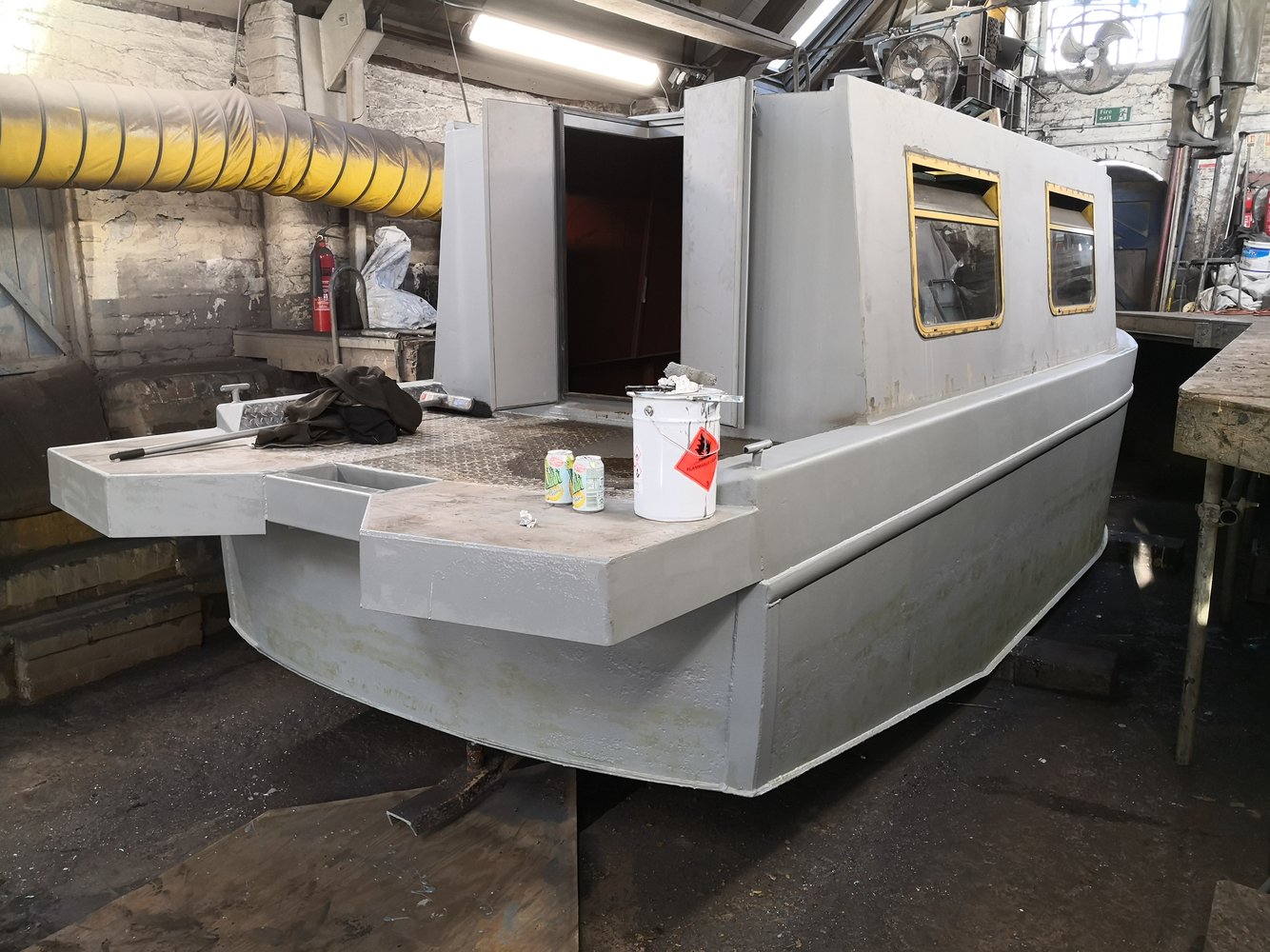

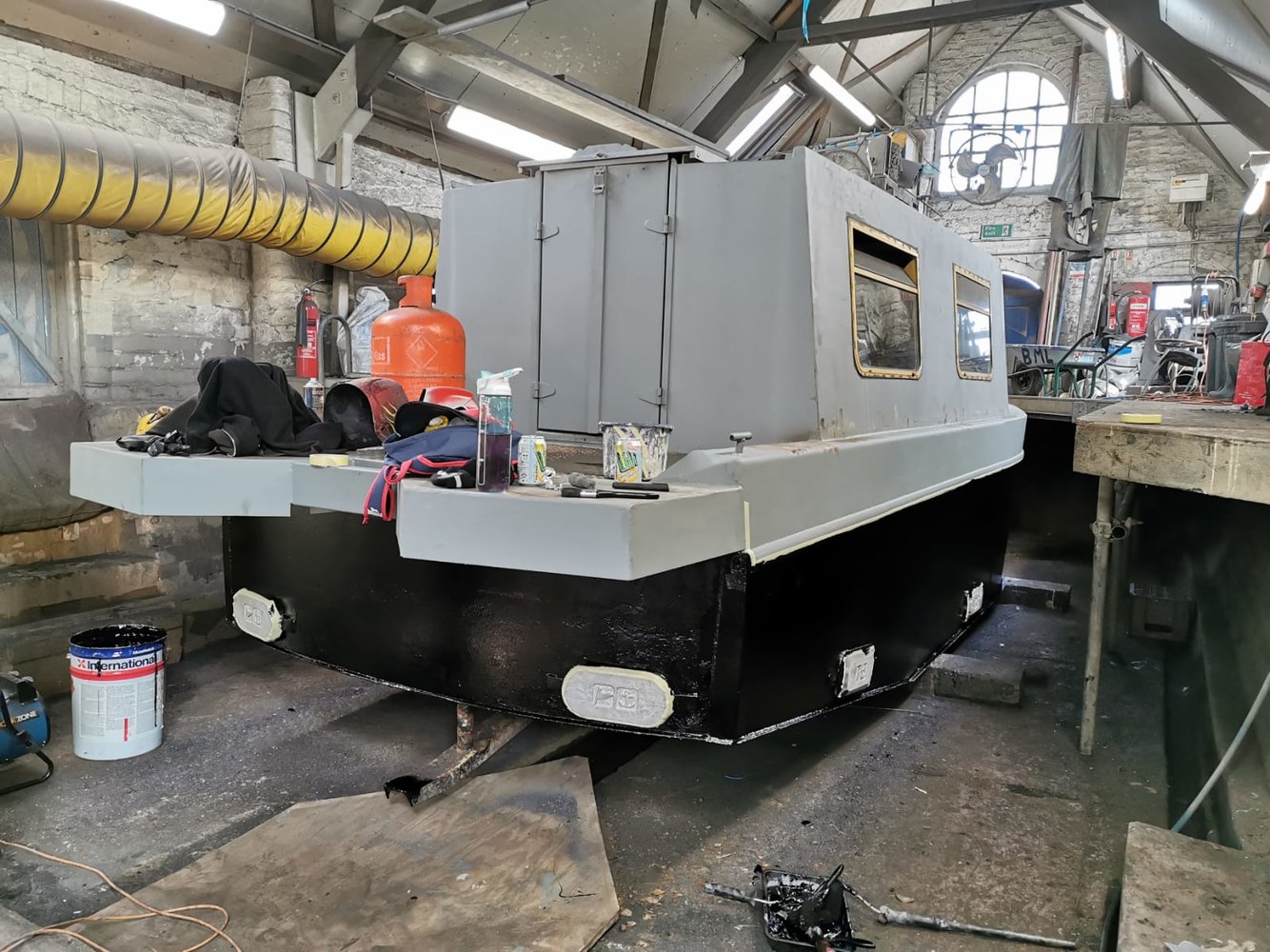

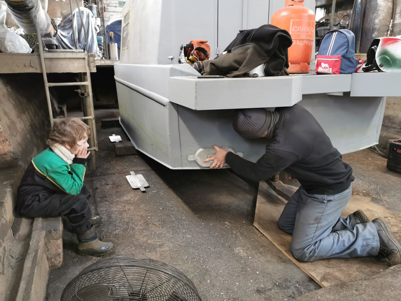

What dock is that?We I managed to get the project boat into dry dock for a week to carry out some welding work on the Hull including about 400 deep pits around the Hull. I also stripped the Hull back to bare steel before painting with 2 coats of anti corrosion paint and one coat of blacking. Will get the second painted on tomorrow.
One at Braunston marina near Daventry.What dock is that?
Thought it was, I used to fit boats out at wharf house nbsOne at Braunston marina near Daventry.
Is it Mig or stick welding?
No gas bottle to be seen, so.....
In the picture I was arc welding. Depending on the jobs as to weather I use the mig or arc.Is it Mig or stick welding?
Since moving the workshop to Braunston we have done a number of jobs for wharf House. They have moved down to the marina as well now.Thought it was, I used to fit boats out at wharf house nbs
Yes it's the Rohr 140amp arc set. I've got one at work and one at home. It's a brilliant little welder for the money I've done lots of welding work with them now using 2.5 and 3.2 rods which it's done with ease and very smooth.@spaffmonkey Is that one of those budget stick welders? If so I take it's going well still?
