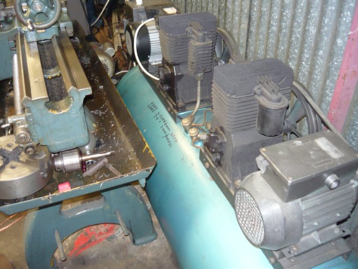

smallest would be 90cfm large and noisey and a fortune if they pack in. a twin single phase unit would poke out 28cfm and run of the ring main . i have a twin unit u can run one or the other or both together depending on your air needsWhy not get a road compressor?
ive been offered a couple of new 3hp 15cfm worthingtons for £900 + vat (part of the atlas copco group im told) and a couple of ABACS for similar money, any experiances in this area guys?
i bought a second hand twin set up 60 quid and fitted one new motor total cost £160 .00 there just over a grand in machine mart mines noisey and fast running but machinemart sell a slow running one .or u could buy 2 -14 cfm units and pipe them together giving the same result http://www.machinemart.co.uk/shop/product/details/se29d270-ol-air-compressorThe £900 is for two compressors,which i didnt think was to bad? Can you tell me which twin your using Brightspark and what are the noise levels like?
