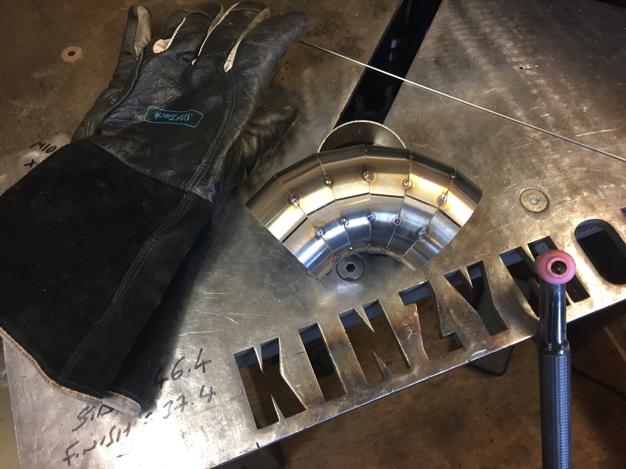

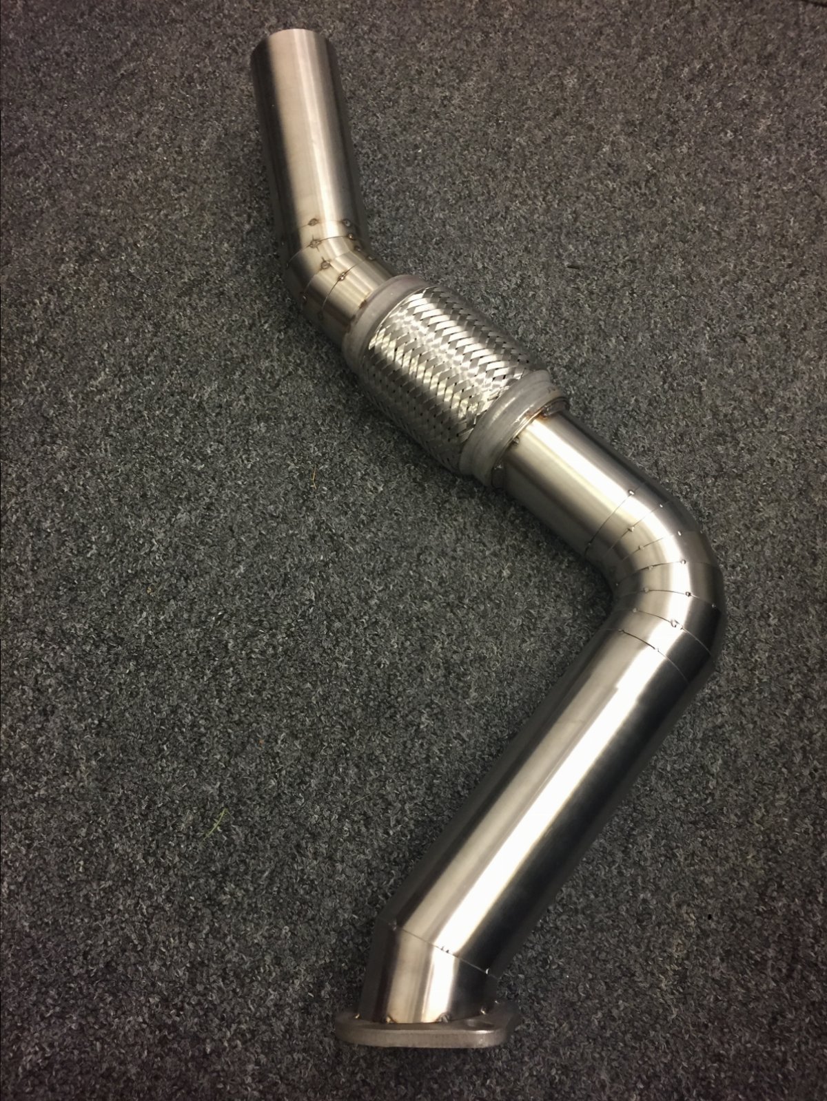

Some results pics would be nice rich.tried with the torch switch today. and pulsing I'm getting there. I've watched few videos and seen people laying the filler rod in front. is this good practice?

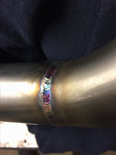

I suppose just to clarify a few points firstly, as the guys have already said, back purging on thin wall stainless, or any exotic alloy is an absolute must! Anyone who says they can butt weld thin wall stainless tubing on 35-40amps and not get sugaring on the backside, is frankly talking rubbish.
You will get discolouration and sometimes sugaring when tacking thin wall stainless at 40a.
If you are welding it at an amperage or speed that will not penetrate through 1.5mm wall or less stainless, you’re in big trouble shortly down the road.
On the filler side of things, it’s a bit of a double edged sword.
It is very possible and fully acceptable to butt weld stainless tube autogenously and have it as strong as the base metal IF, and that is a bit IF, there is NO, and im talking not even mocroscopic air gaps or chamfers on the tube. When the tube is butted together is should be very very difficult to even see where one tube meets the other the fit-up is so good. Then, generally with pulse, an autogenous weld with no undercut is possible with full penetration that is as strong as the parent metal.

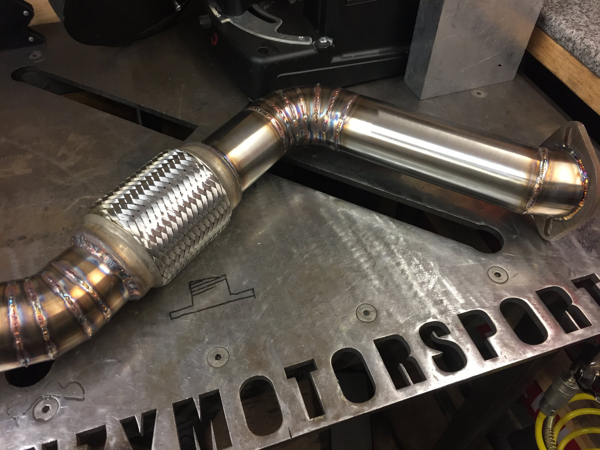

As I make manifolds for often very expensive and important race/rally cars, I send off a few samples to be tested in 2014 for my own knowledge – 1.2mm wall 304 and 321, few samples without filler, few samples with. Each one was x-rayed, bent, stretched until it yielded. In general, the autogenous welds were as strong as the base material.
The samples with the filler were stronger than the material, so it's all relative.
What it comes down to really is longevity. There is more chance of failure in a shorter time period with no filler, but that doesn't necessarily mean that it is a flawed technique - F1 exhausts are autogenously welded .6mm inconel. And they are expected to fail after a certain amount of hours use.
Obviously that's not ideal for 99% of retail customers.

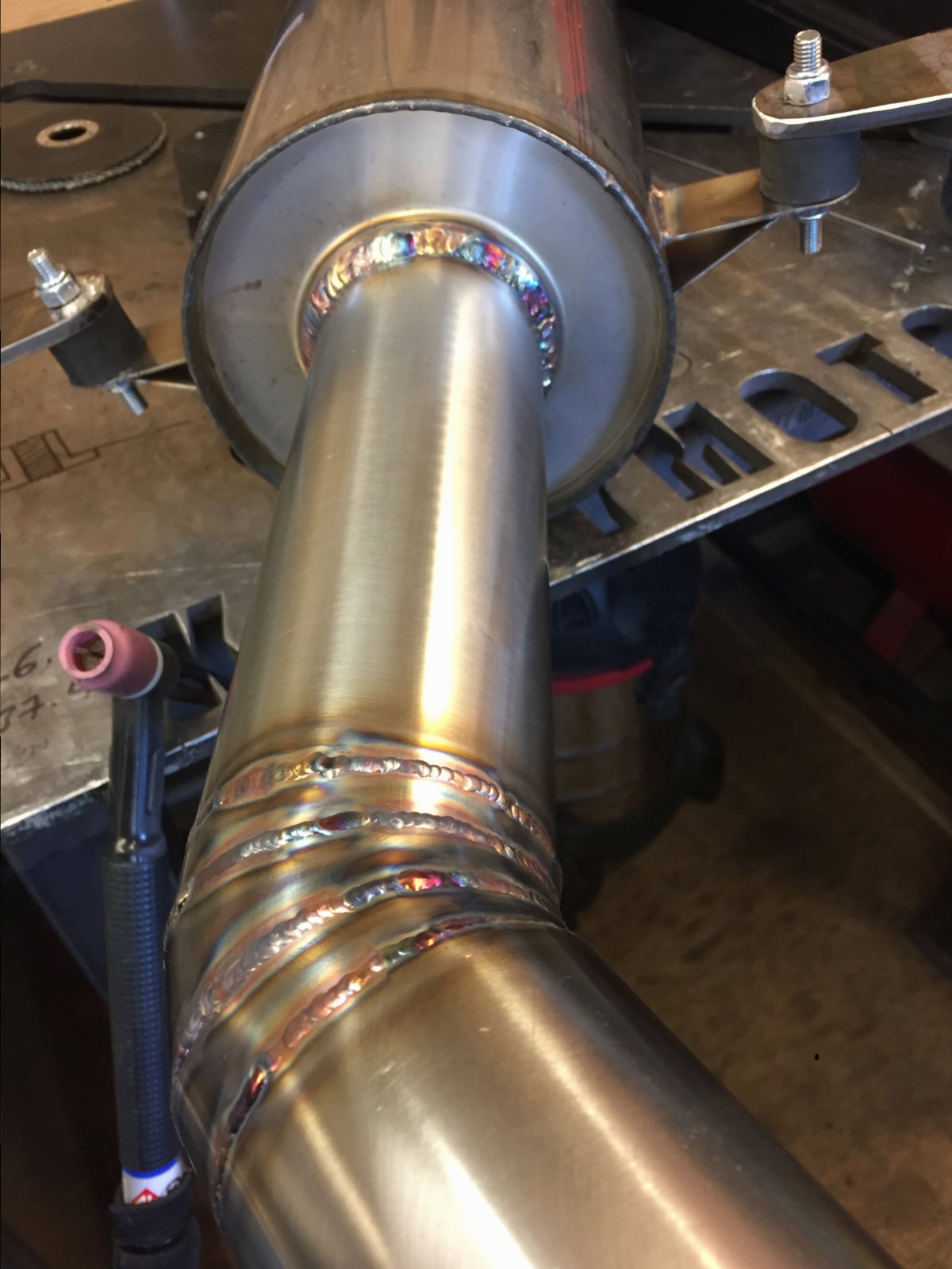

Unless a customer specifies to me that he doesn't want filler to save weight or whatever then I will always use a filler.
When Im building manifolds for f3 cars for example IL use 1mm or 1.2mm wall 304 or 321 with a .8mm filler or sometimes 1mm.
38ish amps, clean clean clean and clean again. Hand file each tube end for a nothing but perfect fit, and purge absolutely everything , Everytime

You are compromising your product which looks like you have put a lot of effort into by letting the customer tell you how to weld it, you're the welder

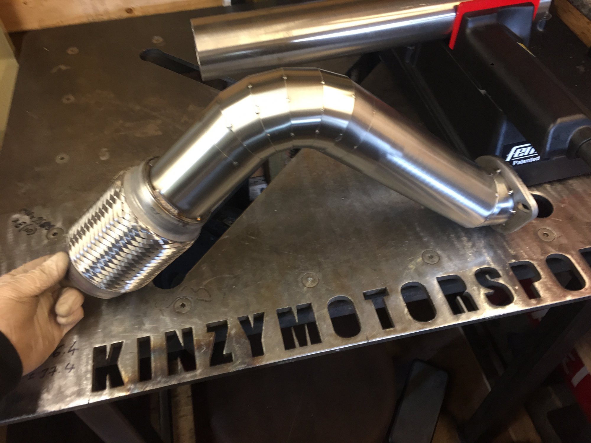

They might do but there is always a bigger radius with a pre bent tube than can be achieved by using a lobster back technique. So it really does depend on where the thing has got to go and whether a mandrel bend can be usedProFusion do a nice range of Tight Radios bends
