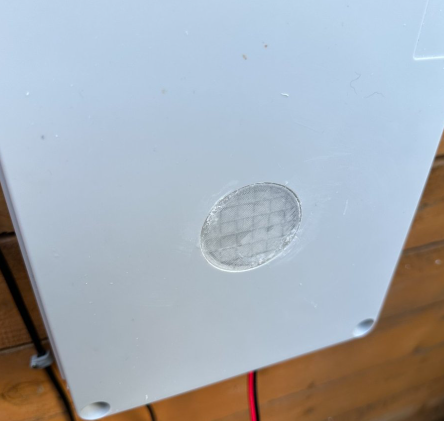

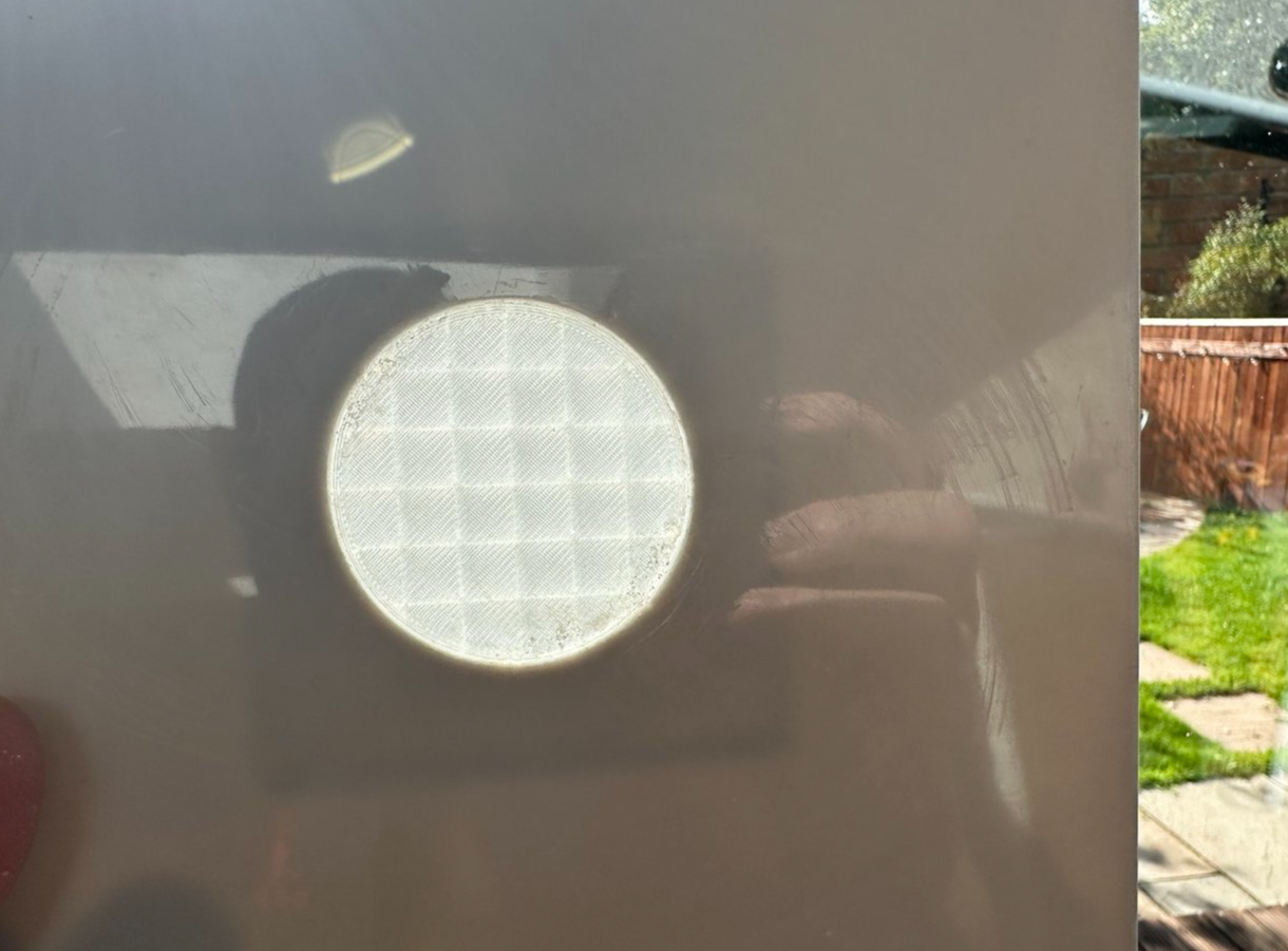

All the write-ups say to use a 100% infill to get the window transparent....Well, that was utterly underwhelming
I dropped the infill to 10%, sanded it and bathed it in solvent and it's hardly much more transparent then white PLA

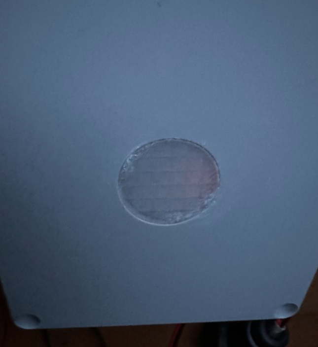

I went and checked it again later in the evening and I guess that, in the dark, it does what I needed - I can tell what colour of lights are on under the hood:
Just...
(by the way, the roughness around the edges are the superglue leaking, not poor printing or hole-cutting!)
