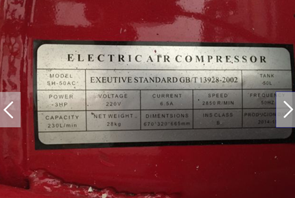

Well done maker thats what I thought 7.5 cfm ??especially only running up to 115psi, which is very low, my compressor kicks back in at higher pressure than that.The link for the 3hp one says "input power: 1500W", 1.5 kW is 2 hp, not 3. I don't know how the output power has been calculated but that's closer to 1 1/4HP. I don't think I'd bother with one of these.

3 hp should be 2250 ish W
http://www.engineeringtoolbox.com/horsepower-compressed-air-d_1363.html to give you an idea

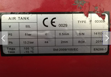

So here's two pics of the spec plate off the air compressor. It does look like 3HP as they said and the power is 6.5x220=1.43kW
Any ideas ?
I concur. Unless they've bent the laws of physics, that's nae a 3hp compressor.I'm still not convinced, it says the current is 6.5A which means the power cannot be more than 1560 watts, ~2HP but it will be less than because of energy lost to inefficiencies. According to this page, a 6.5 amp motor is going to be more like 1HP.
they do use 3 horses-------accept two of them have been hobbled.And if it was, I'd be wondering what stable the lazy third horse was lying down in, if it was only generating 7.5cfm
