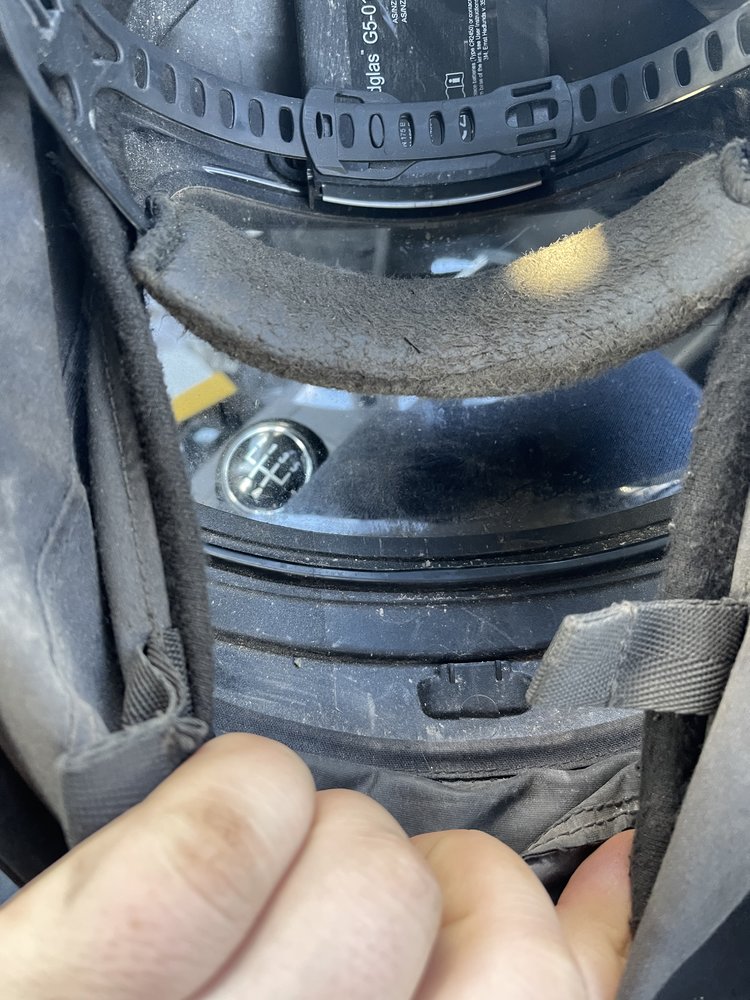

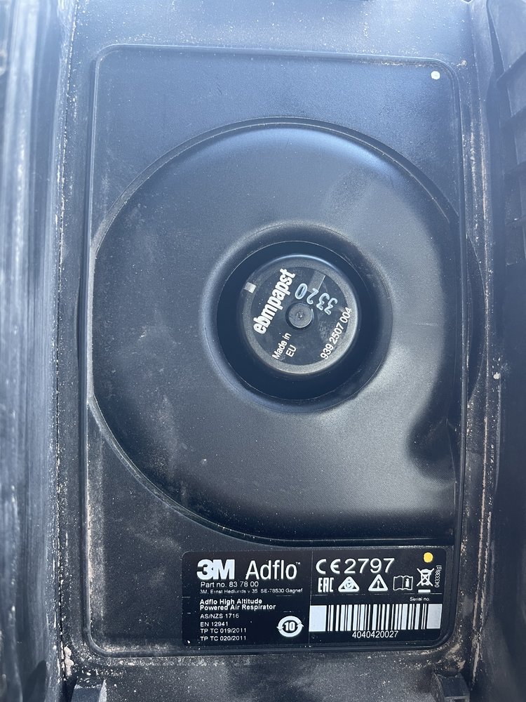

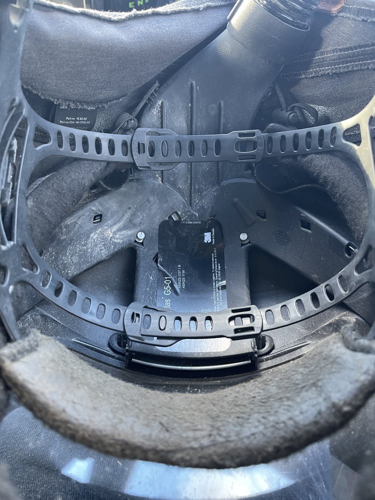

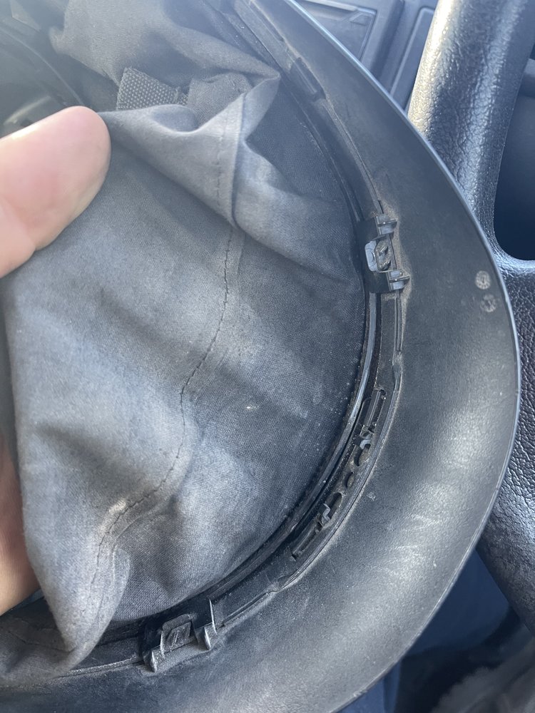

Correct. Members of the public don’t understand some of this stuff so end up getting duped.Interesting. So there's people selling non ce marked stuff in the UK. I've only recently thrown the box away for the face seal. I think the face seal, combined with the fact the stupid seal in the hose is crap and the adflo playing up is all leading to my dust issues.

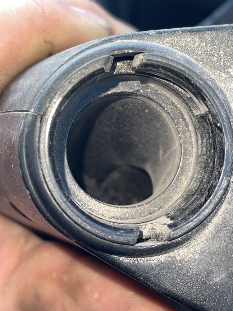

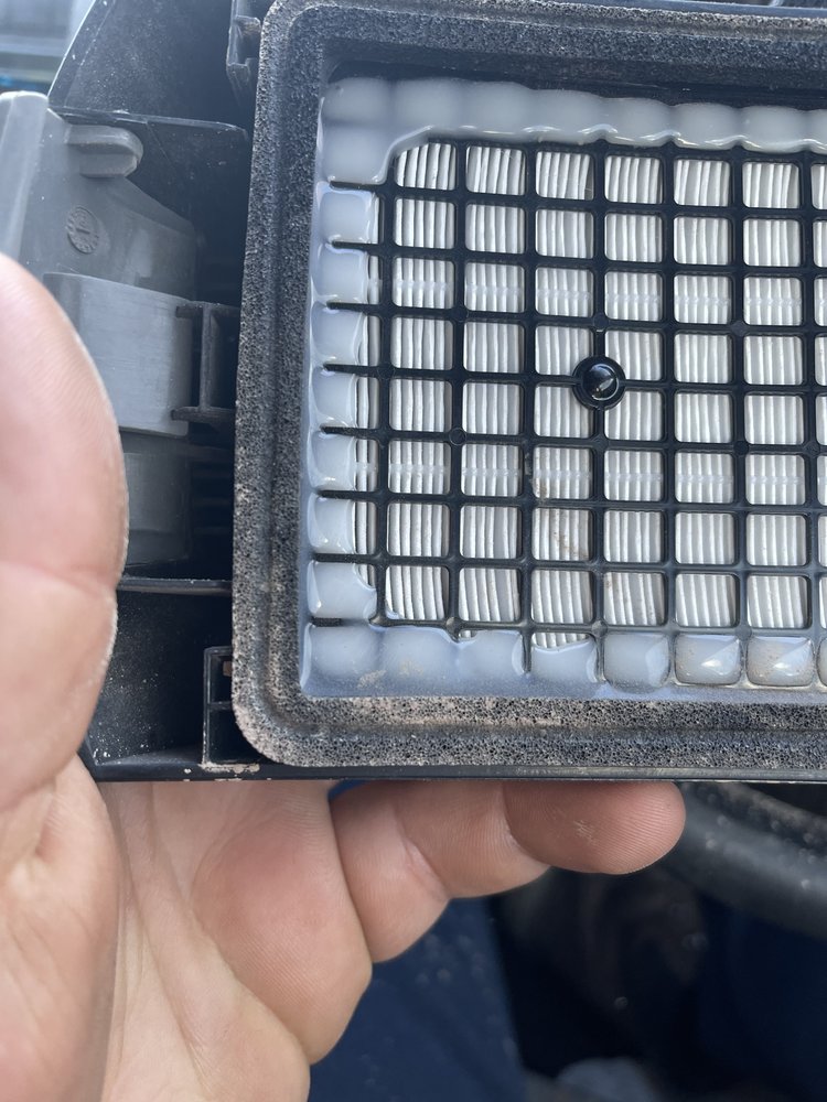

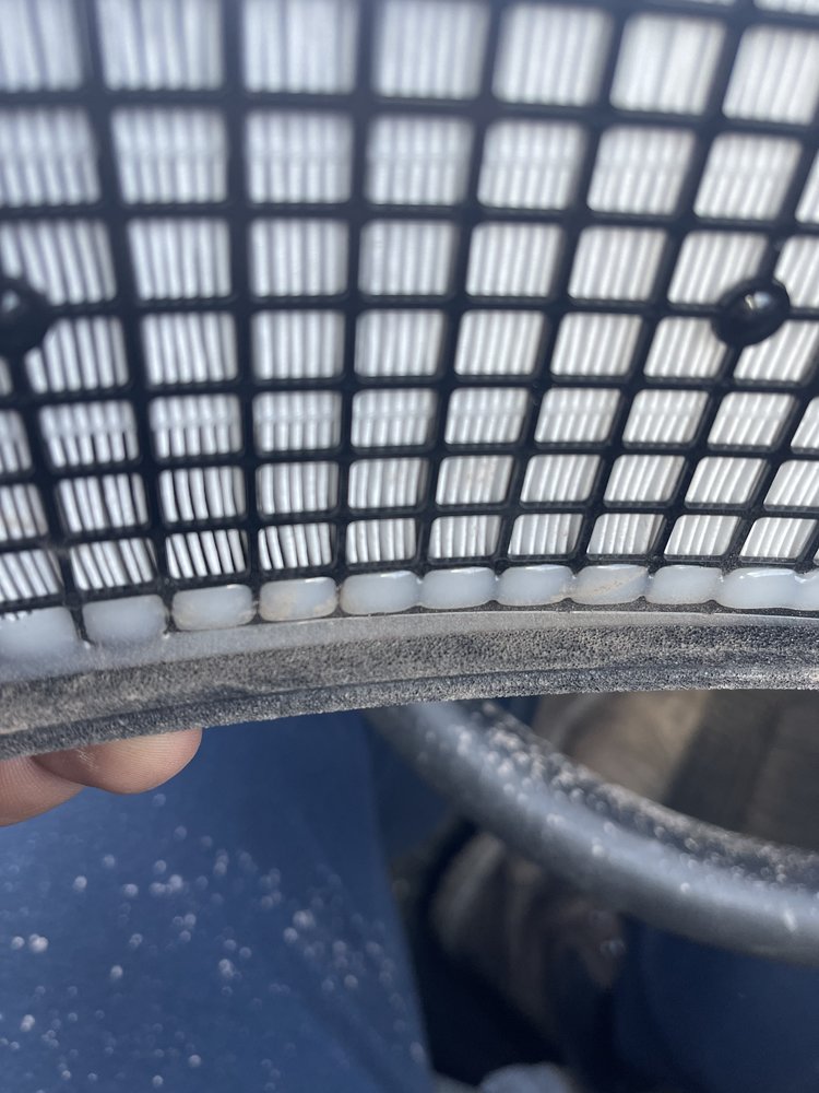

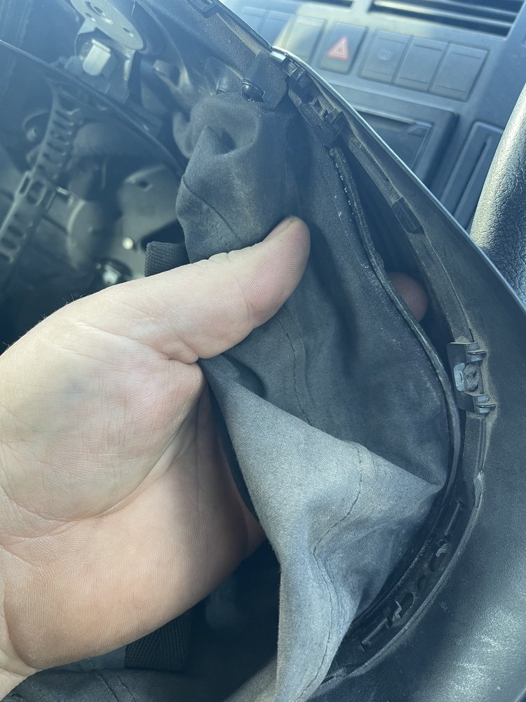

Thats on a level of not very good at all to the point that ive never seen that beforeYou can see dust is getting into the clean side of the filter. Around the fan and up the exit pipe.
You can imagine I was very dry mouthed at the end of that job!Thats on a level of not very good at all to the point that ive never seen that before

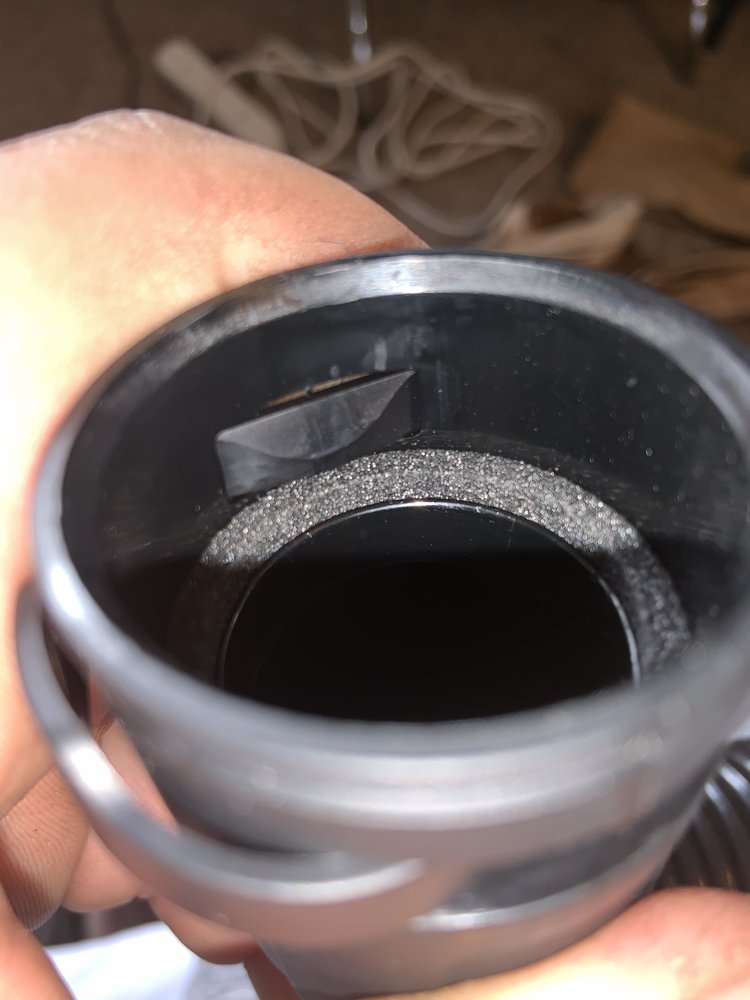

This is the seal in a brand new 3M hose. It's like polystyrene or something.
once you've had your hose a few months that seal basically gets compressed and no longer seals properly.
