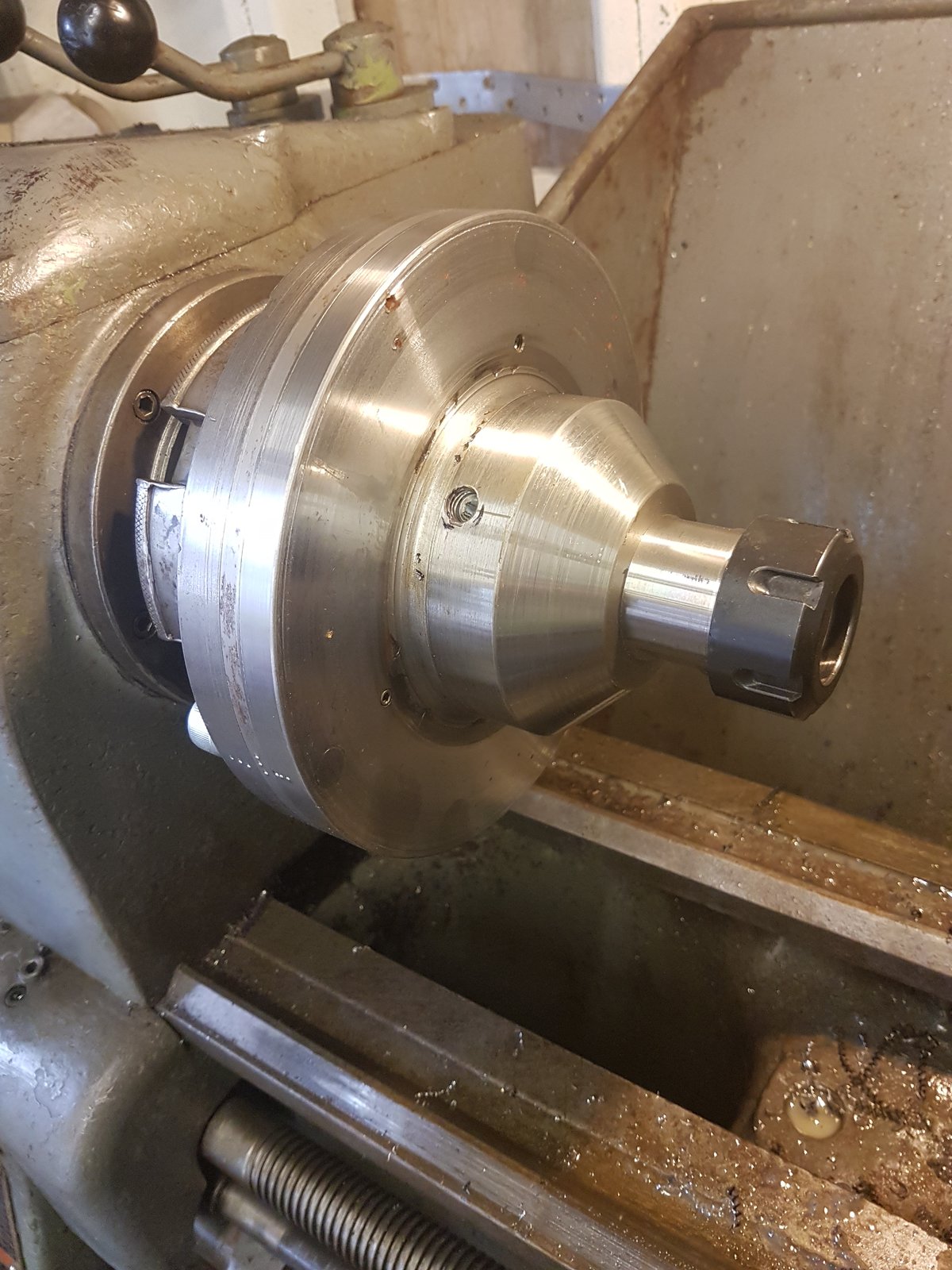

Why not try cutting the 4 jaw with a carbide boring bar.Might be interested in the 3 jaw if it's up to it...
mine has been crashed at some point (on a different lathe) and ok but not ok
Maybe... will a carbide insert cut the jaws?Why not try cutting the 4 jaw with a carbide boring bar.
Yes, no probs but use a fairly big nose rad negative insert as it will stand up better to the interrupted cut.Maybe... will a carbide insert cut the jaws?
what about grinding them straight?
like optima did using his grinder
confused??Jaws are massive it's a 12 inch chuck..... as it is fine everywhere except in the bore I'm thinking it's not really a real problem fir what I normally use it for....
