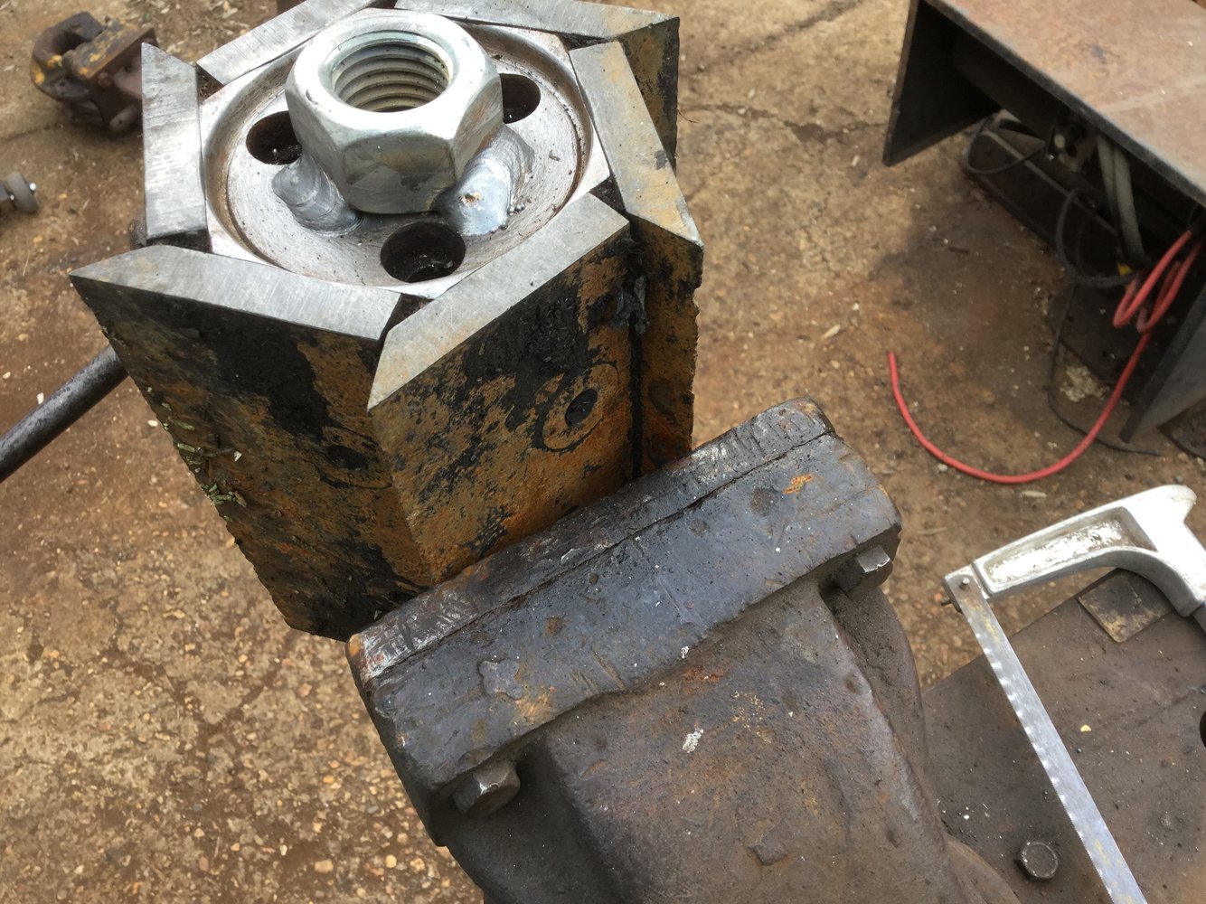

As @Bill Edwards if you don't need the bearing again that's the way to go. No idea how it works but it does.
Well putIt’s dead simple.
As weld metal cools it contracts which we see whenever we’re trying to weld something square and it pulls towards the weld as it cools.
Do that inside a circular object and that contraction is enough to shrink it considerably.
As an extra, the heat would be enough to undo any retaining compound and the forced shrinkage would break a rust bond.
