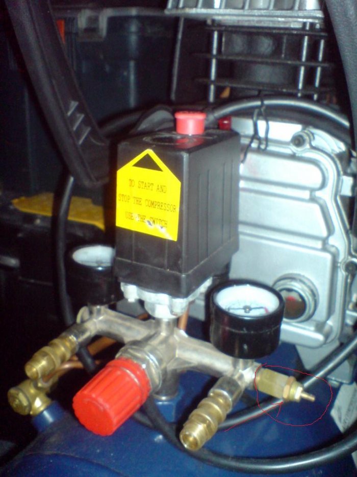

I have a Valley 50 litre 3hp compressor and it runs up to max which is 120 psi, this is when the safety valve cuts in and releases the pressure.
I picked the air compressor up second hand.
Been trying to find some information on what pressure it is meant to charge to before cutting out. But the lable is missing on the side.
Are these type of compressors fitted with a electric cut out?
Thanks
Dale
Thanks
Dale
if u alter the settings on the pressure switch u have to alter the differential as well
