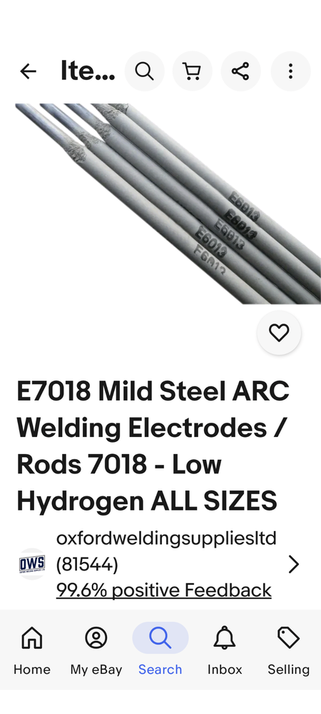

anyone know of anywhere selling decent 7018 rods that will post without pulling my pants down, my local suppliers can be hard work at the best of times (i have to explain that there are way more rods out there apart from 2.4 3,2 6013 )
if i explain exactly what i want one will order them in.
but just been quoted £16 for 4 vac packed 7018 rods, 4 rods for £16, £4 a rod and thats all they can get wtaf
admittedly i would rather smaller sealed packs, but jesus wept £4 each
